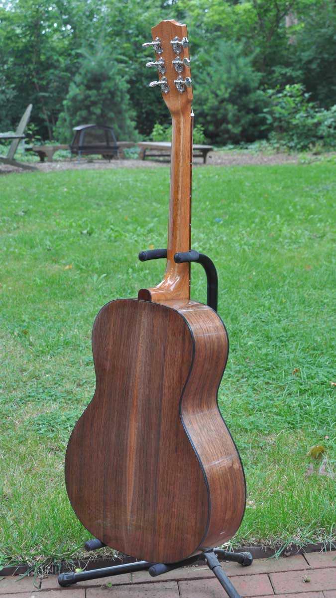

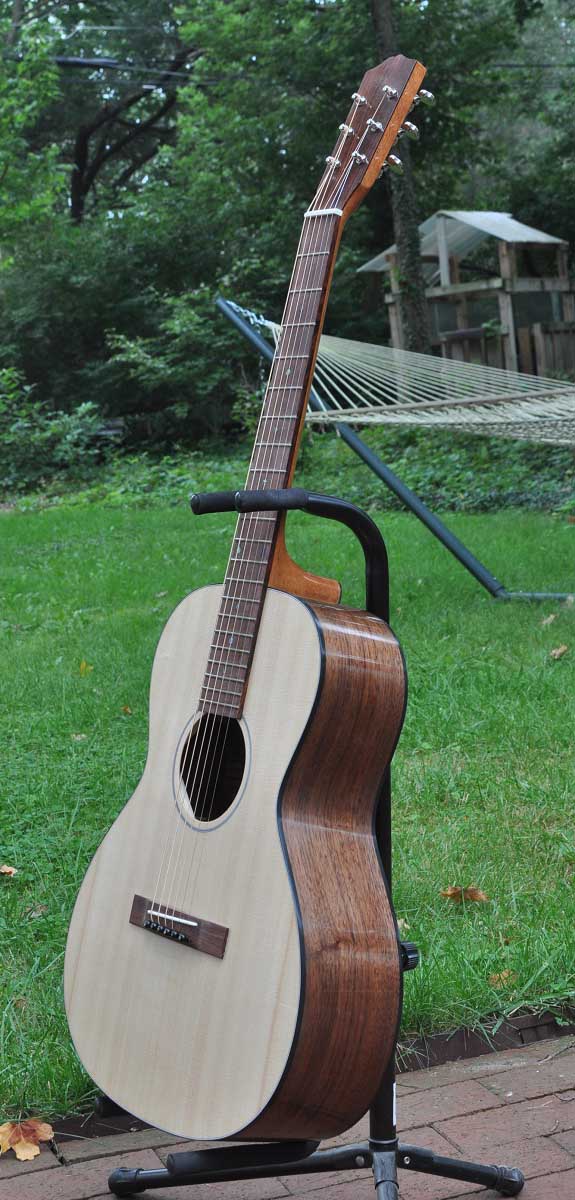

I don't know how much help this will be but I'll share my build.
I used the Grellier plans but changed to a 13-fret neck join, m&t bolt on neck, Martin 25.4" scale, and deep body Nick Lucas dimensions from the Gibson Fabulous Flat Tops book - my interpretation of the Santa Cruz H13. Black Walnut back & sides, Lutz Spruce top, HOG neck with Honduran rosewood fingerboard & bridge. I did tapered bracing per the plans.
I then thinned the perimeter of the top to lower it's "monopole" frequency in loose accordance with the Gore/Gilet books.
So there were a lot of deviations from the plan but I'm very happy with the sound. Unfortunately, I'm a hack player and I've never played a "real" L-00 of any incarnation so I can't compare. This guitar is loud, has deep bass response and good sparkle on the top. It's not as lush as a good sounding Dred but definitely holds it's own & is able to cut through. If any of you are in the central Ohio area, you're welcome to play it. I realize that I was pretty vague on specifics so if there are any questions, please ask.
Enough rambling, here are some pics.
Kevin Looker
Kevin Looker

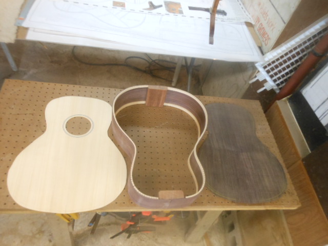

Well Winter and tons of snow are good for some things! Progress so far. Waiting for Go Bar rods to brace top and back. Suffering from approach avoidance syndrome on the neck though. Will be first truss rod attempt.
