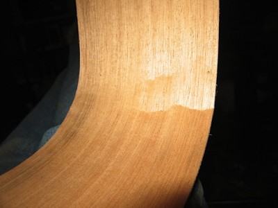

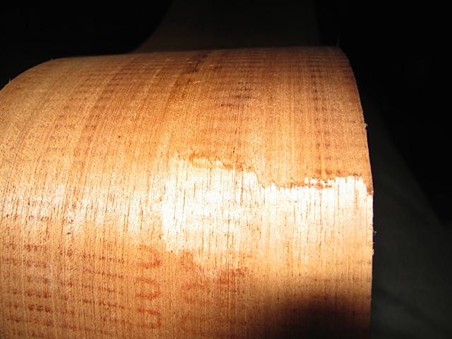

I have bent cherry and purpleheart, but mahogany is kicking back at me. I use a blanket on a Fox-style bender; the sandwich is blue steel strip, paper soaked in water, mahogany, soaked paper, heater, and blue steel strip. The mahogany is quartersawn, grains running perfectly up and down, just like a soundboard, and about .080". all four sides are clipped to keep the sandwich tight. With an adjustable rheostat, I bring the blanket to 290, then crank the voltage down to keep the temp there. This takes 3-5 minutes. I slowly crank the waist in, then slowly bring the sides down to the form, one at a time, pressing the sandwich to the form with a full-width block along the way. When fully engaged, there is a press at the waist, and full width blocks and the end of both the upper and lower bouts keeping the sandwich tight to the form.
I have seven cracks in the board, and the mahogany is straight between the cracks, as if there was no bend.
What am I doing wrong? Ideas include not using quartersawn, but flatsawn, wood. Perhaps soaking the rib in water for 5-20 minutes before putting it in the sandwich, or leaving it at 290 for 5-10 minutes before applying pressure.
Any and all help appreciated.

Sometimes, the mahogany has some runout that you can't see until you try to bend it. If you've got runout, it can be very hard to bend without breaking. I don't have experience with a bender but use a pipe. Sometimes when I bend mahogany, it stops wanting to bend when the water I have spritzed on it is gone. Another spritz in that spot lets me get more bend there. Soaking it won't help with this but spritzing it again might--it's the steam that carries the heat into the wood. Many woods I bend dry--mahogany seems to like the steam. I can't speak to your temperature. I don't measure. When the pipe is hot enough that a spritz flashes off instantly, I consider it hot enough for most woods I use.
- Posts: 1475
Re: Apparently, I Need a Tutorial on Side Bending
It sounds like the wood is not getting hot enough. I think you need the wood to be around 350F or even more, and only long enough to make the bends, then let it cool.
Bending with metal slats and a heat blanket remove a lot of the feel from the operation, so it is more difficult to tell when the wood is ready to bend. You probably need to feel when the wood becomes relaxed with the heat, then it will droop a bit and go pretty much where you put it. But when using metal slats you have to use some force to bend them as well as the wood, this is where the feel is mostly lost, overcoming the metal and breaking the wood before it is ready to bend.

G.M., I assume you are saying "110C/120C" - which is still not very hot. You really need more like 175C to get it going
Mahogany is a tough wood to bend. And it springs back a lot even after.

GM - you are showing buckled sides.
I assume you are giving instructions in that last post for a SUCCESSFUL bend - not the bend pictured.
Also, 300C = 572F !! That is scorch temperature.
