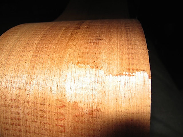

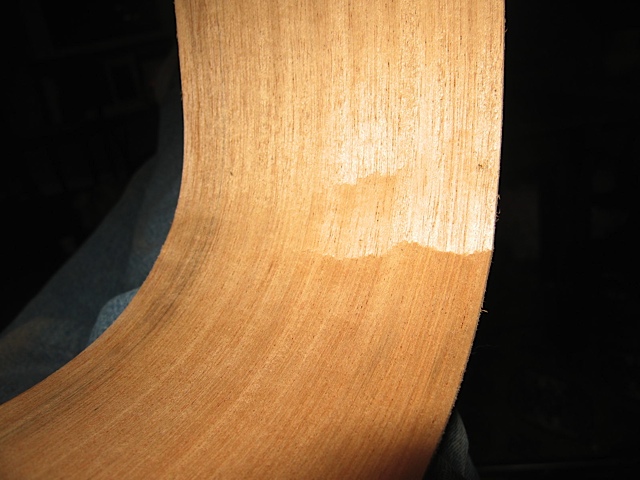

I had the same thing happen to me. I had successfully bent Sycamore, White Oak, Curly Maple, and messed up a really nice set of Honduras Mahogany sides. John Hall at Blues Creek had the answer. I use a Fox style bender, heating blanket, and stainless slats, & craft paper. Wood and paper slightly damp. I use a shop rag on the rear bout and about 110/120 degrees you can feel the wood relax, using hand pressure bend the side and lock down with the caul. Immediately do the same to the front bout and then crank down the waist. Should be finished and watching your temp in three minutes or less. Good Luck

G. M. Seigmund
Posts: 19
Joined: Sat Jan 07, 2012 5:51 pm
Re: Apparently, I Need a Tutorial on Side Bending
Post by G. M. Seigmund »
Start bending at "110/120C" or it will break, buckle etc. I just followed John Halls recommendations.
Success, and some Lacquer:)
#2
#2
First ruined side
First ruined side

I'm confused.
GM - you are showing buckled sides.
I assume you are giving instructions in that last post for a SUCCESSFUL bend - not the bend pictured.
Also, 300C = 572F !! That is scorch temperature.
