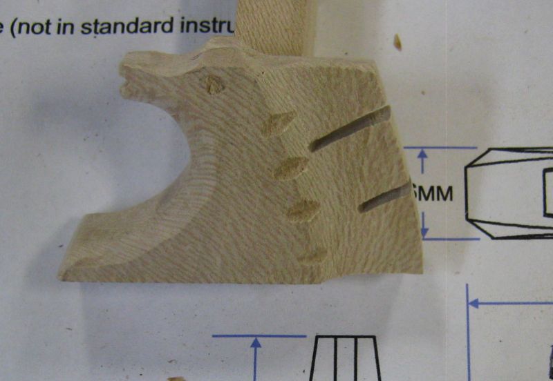

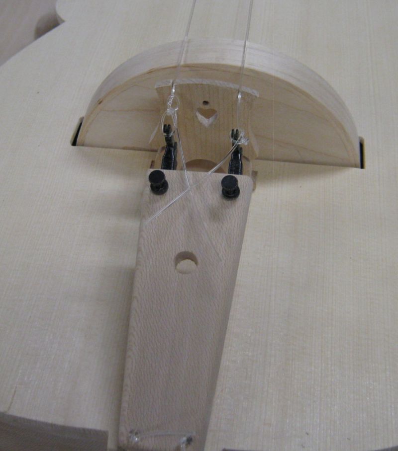

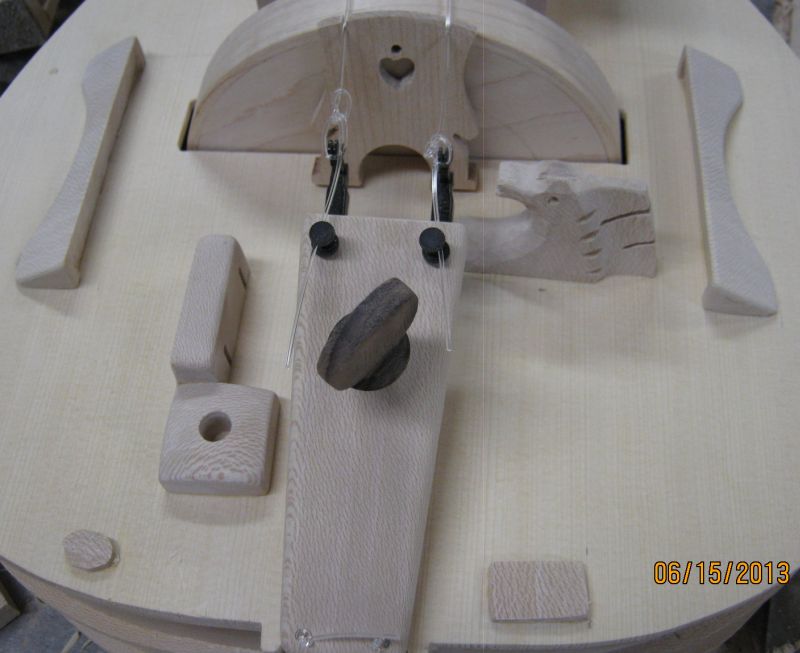

Well, I've been working on some of the little bits for a while. Here are the bridges for the melody and drone strings. And the trumpet bridge holder. The main tuning pegs. Also worked out the tailpiece. Here it is, temporarily in position. I've used viola fine tuners for the string holders. Next, worked on setting up the "nut". You can probably see that some notching is needed to give the strings some room- this isn't shown on the plan but is in one of Wilfried's photos that I posted earlier. I put in some notches with a round rasp and then glued the separator on and drilled clearance holes for the strings.

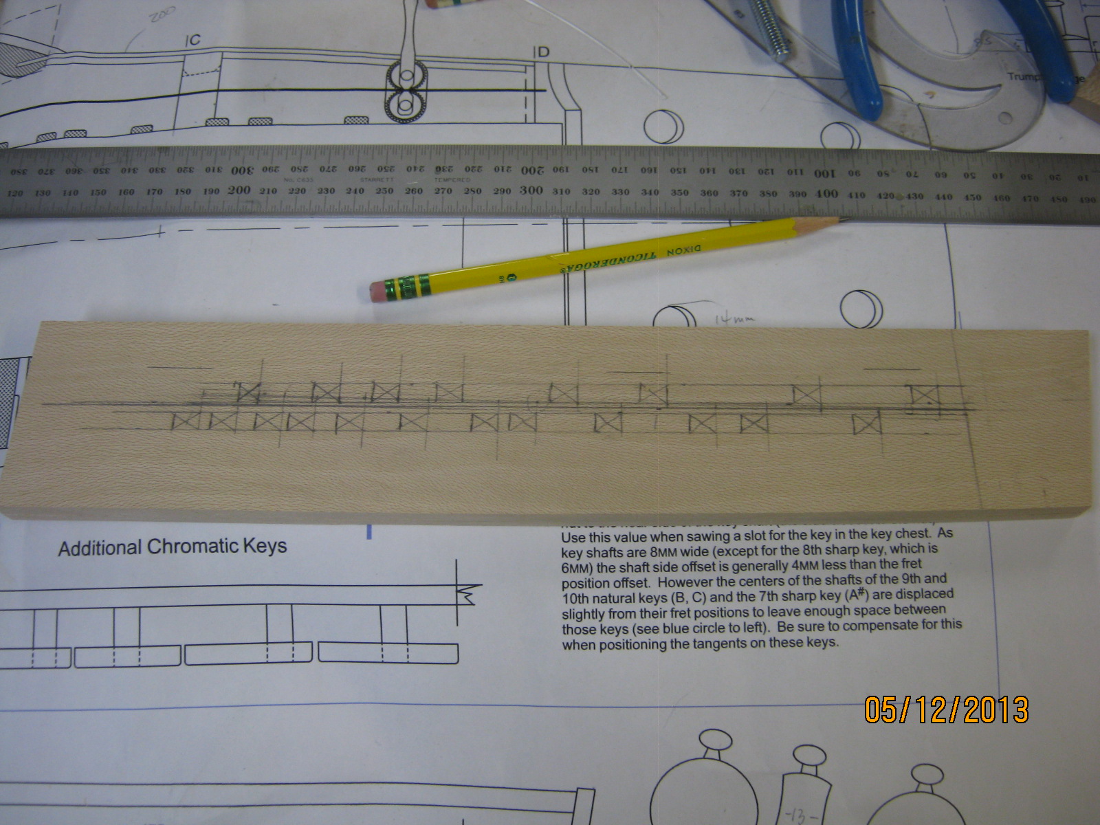

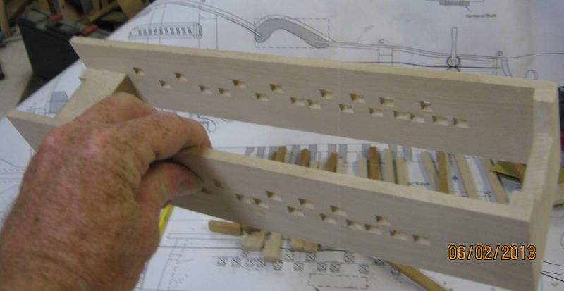

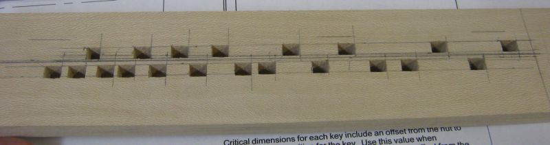

Worked on the keybox a little. Here I've marked out for the two rows of keys:
The holes are nominally 8 mm x 6 mm. I used a 0.25" mortising bit (with the two sides taped together).
And then the buttons for the tangents to sit on, in place. Still need to add the buttons of course.- Bob Gramann

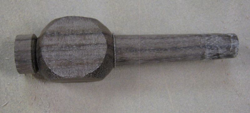

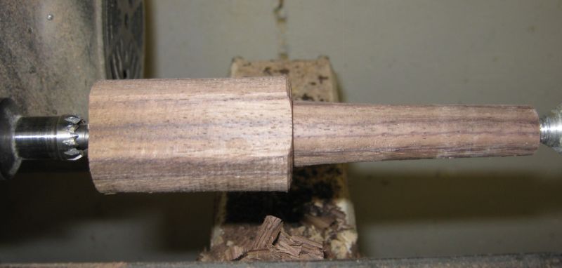

This is a fascinating project. Do you mind sharing how you made the buttons on the tuning pegs?

The pegs were turned on a lathe from rectangular (looking at it from the end) pieces.
Then to put the curve in the tops, I just took them to the spindle sander (2" diameter spindle) and sanded the curve in. For the smaller pegs (e.g. on the tail piece), I used a handsaw to get the flats and then some sandpaper wrapped around a dowel.
I wrapped a piece of sandpaper around the outside of the peg (sanding surface out) to get the matching taper in the headstock.
There are probably more efficient ways to make them- like maybe cutting the flats in before turning, etc.
Took me a couple tries to get it right. Here I've got the tapered part to the length I want it.
Then pretty much shaped.
Then I just smoothed things out. It was back and forth on the lathe 5-6 times to get the taper right. Then to put the curve in the tops, I just took them to the spindle sander (2" diameter spindle) and sanded the curve in. For the smaller pegs (e.g. on the tail piece), I used a handsaw to get the flats and then some sandpaper wrapped around a dowel.

Thank you. I appreciate you sharing your method. I'm always on the lookout for an elegant way to make buttons.

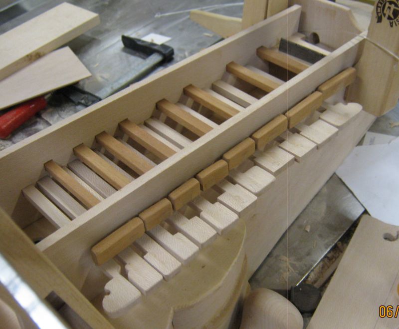

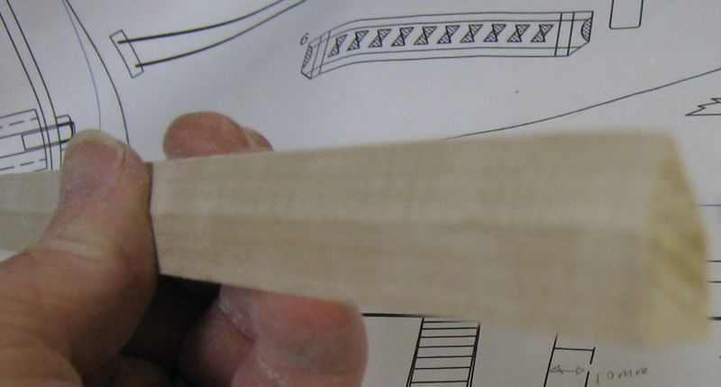

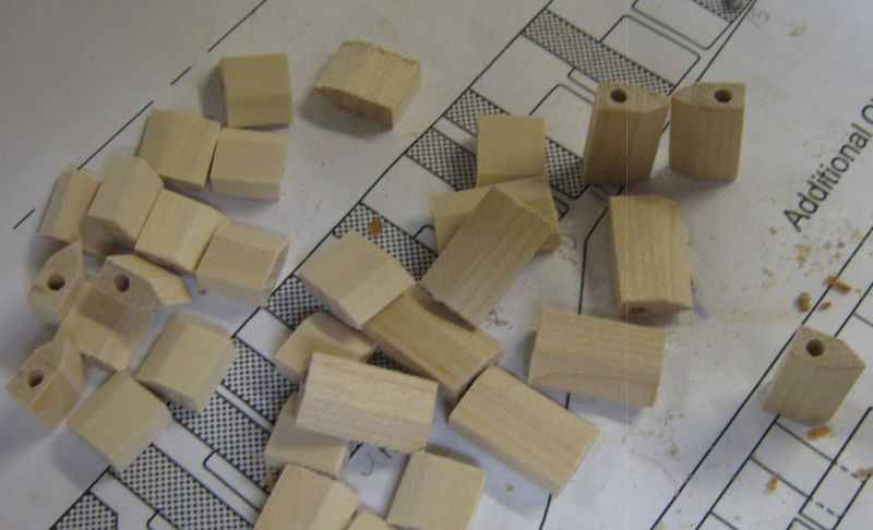

Time for an update.

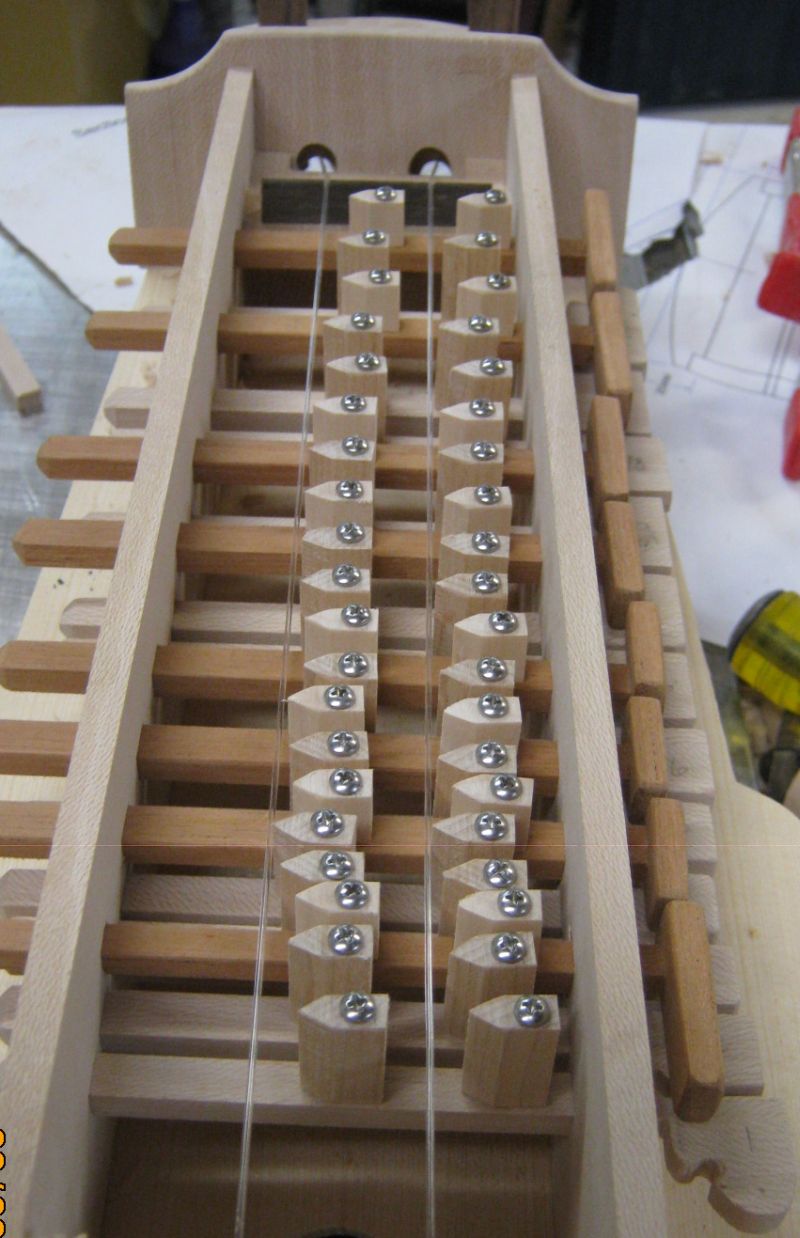

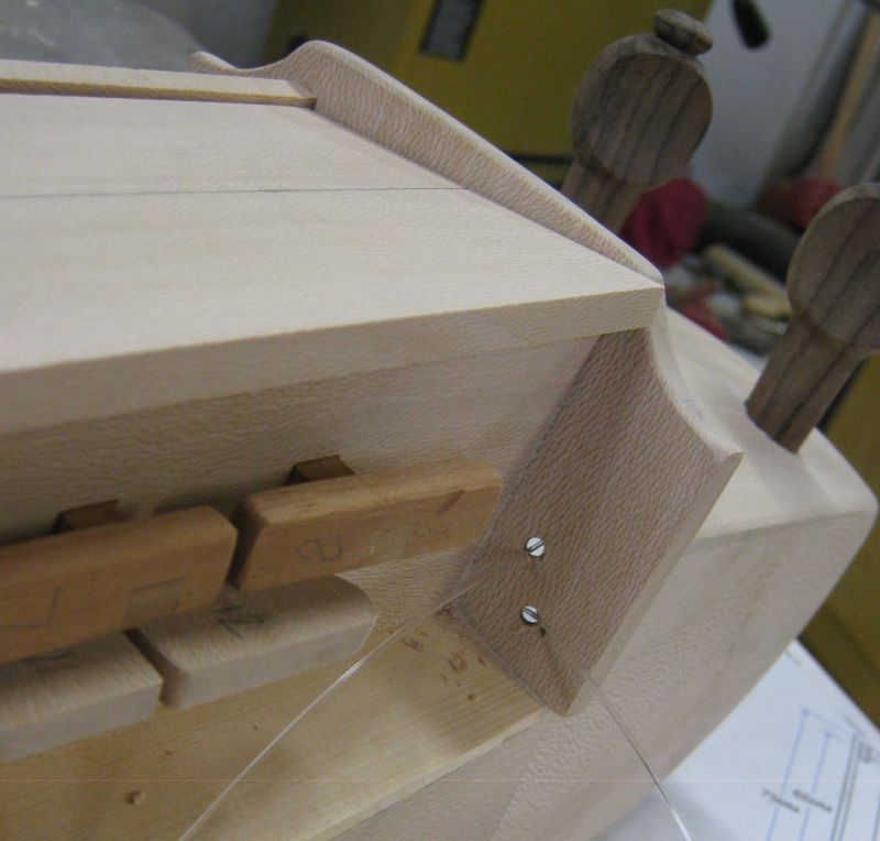

Here I've added the "buttons" to the ends of the keys. And here's the keybox glued up and ready to glue to the instrument. Here's the prepared tangent stock. Actually I redid this as I thought the taper was a little to shallow, but the idea was to get the shape on a long strip and then cut it into the individual tangents. And the finished tangents (with mounting holes). The tangents for the bottom keys are about 7/8" high, the top keys, about 1/2" high. Obviously not period construction here <g> And with both sets.

So cool! After depressing a key, how does it retract?
- Posts: 471
- Location: Menorca. Spain.
Re: Building a hurdy-gurdy
Hurdy-gurdys are usually played hanging from a strap around your neck so that the keys point downwards. So gravity (probably with a little help from the kick-back from the string tension) does the job.
- Charlie Schultz
- Site Admin
- Posts: 1442
Yes, what Simon said. Although I read somewhere about people using springs to return the keys. I plan to add a little strip of felt inside the keybox so the tangents don't clunk against the side.

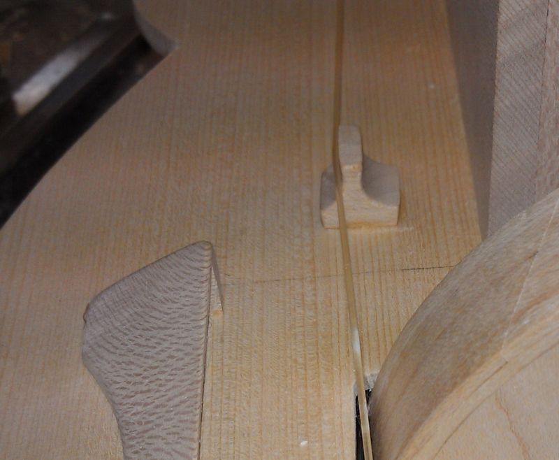

Here's most of the bits (cover holder, bridges) in place on the top. Holes for the drone strings (similar hole for the trumpet on the other side). At this point I had to string it up! The vibrating strings have a surprisingly (to me) large arc! And I have to say it sounds a bit like a sick cow <g>.
There seem to be a couple common tunings- here's the one I'm starting with (C/G). And the (not cheap) strings:
Chanters/melody 1 & 2: Savarez BRH 94 (gut, 0.94 mm diameter)
Trumpet: Savarez BRH 97 (gut, 0.97 mm diameter)
Small/hi drone: Savarez BFA 422 (wound on gut, 1.23 mm diameter)
Large/lo drone: Savarez BFA 1002 (wound on gut, 1.79 mm diameter)
Still lots of work to do: a few more small pieces to be made and added, (carve? and) attach keybox cover, then of course clean up/sanding/finishing. I don't know how, but I completely missed putting in the sound hole on the top (the plan shows it on the left edge).

I just used a cotton ball to cotton the drones (since I only have the strings on to test it out). I saw that "long strand" cotton was recommended (same as raw?). And I wondered if wool would work too?
As far as the rosin, I have a bar of hard rosin which I rubbed on the wheel (not sure if I'm getting enough on or not).
The other thing I'm a little unclear on is how much "break angle" there should be between the wheel and the bridges.

As to the "break angle", there shouldn't be any. A very experienced professional maker/player (unlike me) I talked to said when he is about to cotton up the strings, they are floating above the wheel , but so closely that you can just squeeze a sheet of cigarette paper in between, but nothing more than that. It's the cotton that makes the contact. Talking about that, there shouldn't be any angle between any of the strings and the wheel surface. (meaning parallel, all strings to the wheel surface.)
