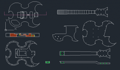

Ok here's the story. I'm in college for machining. My teacher told us we could make what ever we want for a final project. I have full access to CNC machines and decided to finally make a guitar. I've tried a few times in my life but didn't have the tools or money to get er done right. I plan to make a solid body aluminum guitar out of 6061. The thing is once i write the program i can make as many copies as i would like. I would like to make a few wooden versions with aluminum and wooden necks. My dad also has access to an ash grove near home and we have a bandsaw mill. My question to you all is, is there any way I can cut fresh ash, and have it milled and dry enough to be used by mid April? My father seems convinced that it can be dried in a month or so, and i'm sure it can be for any purposes he would use it for. But would a solid body guitar hold up with wood treated this way? There is a hardwood flooring place up the road who I may be able to convince to loan a spot in their kiln. If not it'll be dried in a hot room in the shop with fans because we're in Nova Scotia and its Winter.
I'm gonna try to attach my CAD drawing for eye candy cuz we all like that!

Absent a kiln I'd really doubt it would be dry enough to be stable (which is really the issue) by April. I would try for a spot in the kiln or else look for wood that is already dry.
Oh, and that's a pretty cool design, too!

Those are big pieces of aluminum, and you'll have a really stiff guitar. There are some design programs ( like Solid Works) that will tell you how much it will weigh, when you're done. Does the CAD drafting program you're using do that as well, or are you going to dunk a wood prototype in water, to find the volume??

It looks like you're going to shell out the body itself to shed weight or possibly add tone chambers? If so, you might want to consider either making an inner frame of aluminum and making a top and back out of wood, or make the frame of wood and use aluminum plate for the top and back. Fender Custom Shop made a superstrat with an aluminum frame, anodized, with polycarbonte top and back and it looks really wild.
I use OneCNC for my CAM, and there's a guy in the OneCNC forum making shelled aluminum guitar bodies.
