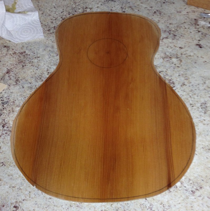

The lower rail of the old door that I wanted to use for the new top turns out to not be spruce. I believe it is Douglass Fir. The pieces ended up being too narrow for a two piece top so it will be 4 pieces, this will be better than the 8 pieces of the other option. First thing was to saw off the edges (and the 30+ years of lead paint). Then cut out a section that has enough space between the nail holes. Here you can see the jointed top, back and sides thicknessed, lining stock made from a palate and blocks made from spruce offcuts from my workbench.
The top ended up having some interesting color variation. It may not be everyone's cup of tea, but for some reason, I really like it. Here it is with naptha:

Thanks guys! The top has reddish bands that I fell in love with, I think you are right about it looking good with the walnut. I'm planning quarter sawn sycamore for the bindings. The shape is basically an OM reduced to 2/3 dimentions (I tweeked the curves a bit). Then I removed 1 inch from the center.
I braced the top last night, but it feels too stiff (to my uke novice hands) so I'll have to do some more shaving. I'll try to post a pic of the bracing soon.

The doug fir top looks great, but I think the lath top looks pretty good too. Maybe the contrast doesn't show up on the photo but even if there is a lot more color variation than I can see, I'll bet it will work out well. I guess you'll just have to build another tenor uke later (like you weren't going to anyway!).
- Posts: 1391
Re: Bryan Bear's tenor ukulele
Yeah, Jon. I like the other top too but in person it is pretty stripey in a distracting way. one edge of the board had some subtle silver tone to it which shows up much more under finish. That turned into 8 silver stripes with a straight edge at the joint line. I put it in the stash and I am sure I will use it one day. Probably when I want to do one that calls for a little color added to the finish.
It feels too nice to waste. If I were choosing between the two blindfolded, I would take the spruce. Though the fir is much harder and will stand up better to any harsh treatment the auction winner (or their children) might dish out.
