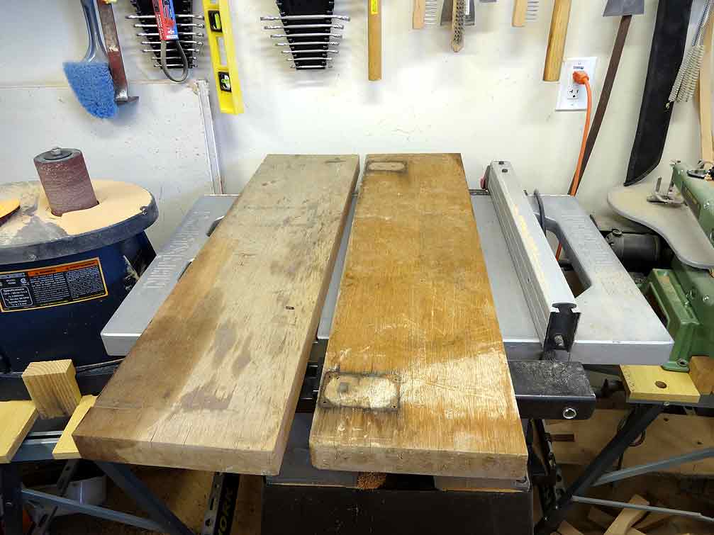

Better late than never. I started these last week. I found a table several years ago that someone had set down on the main road for anyone to scarf up. It looked like a nice piece of wood so I took it home.

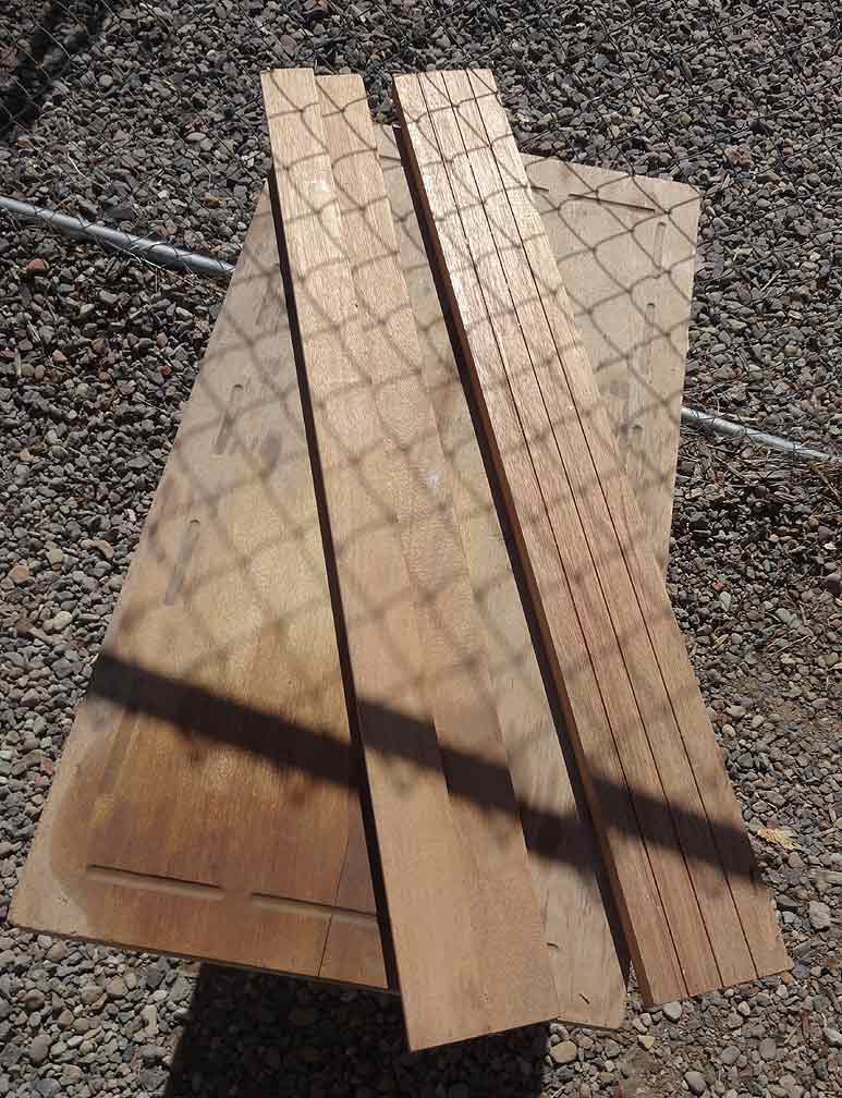

I found the floor boards last year at the hardwood store in Reno - 3 for 25 cents.

I cut the table down the middle on the glue line where the two pieces were joined. I initially thought the wood was oak, but looking at the fresh cut and calculating the weight per cubic foot, I now think it's luan.

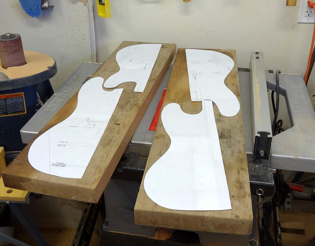

Then downloaded some patterns, one for a j bass and one a p bass, cut them out and traced them on the wood.

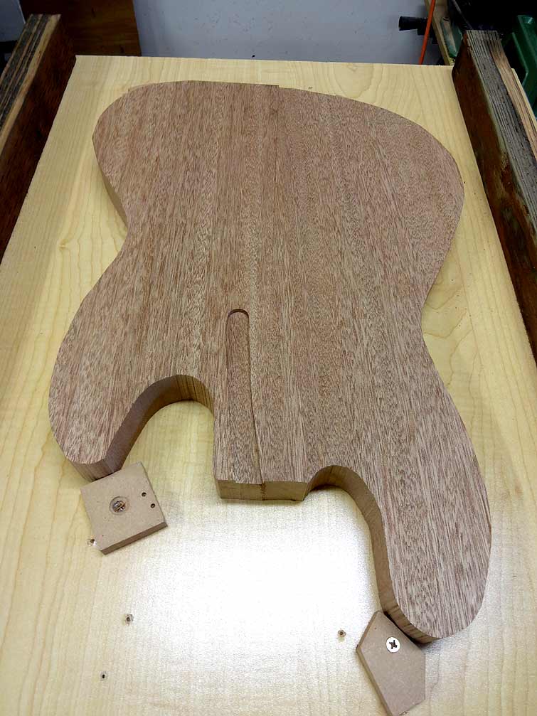

For some reason my router bit moves down about 1/4" sometimes when I turn the router on after putting in a new bit, even though I've set it correctly when stopped.
- Posts: 1325
Re: Two basses from a table top and floorboards
Luckily, it's in the neck pocket and under the pick guard, so the fix won't show.

Re: Peter Wilcox's two basses from a table top and floorboards
What the fuzzy... did the bit drop and chew the top in the exact same place on both blanks?! Is there something going on with hitting end-grain?
- Posts: 1325
No, that's the same body. The second picture (different lighting and some sanding) is after I repaired the part that will be under the pick guard. I just left the groove where I will route out the neck pocket anyway.Jason Rodgers wrote:What the fuzzy... did the bit drop and chew the top in the exact same place on both blanks?! Is there something going on with hitting end-grain?

Made some p bass templates yesterday. Pickguard today from some 1/8" acrylic a relative found in the trash at work. Routed the cavities and the neck pocket today.
I found out my router problem IS the bit coming out of the collet - it happened DURING the route, and luckily wasn't the route to the final depth of the control cavity.
