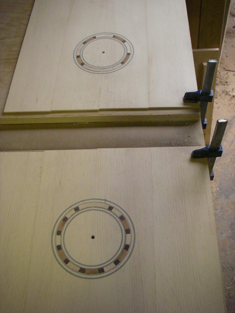

I am going to make rosettes for the two guitars from cut offs I saved from past projects. I save a great deal of cut-offs for pegheads, and rosettes etc. These pieces are spruce, mahogany and wenge.

I glued the cut-offs onto a piece of plywood and drilled a hole for the stewmac precision dremel tool. I then set up both soundboards and the plywood with the scrap pieces on my work table side-by-side. As I route the rings for the purfing, I routed the scrap without changing the settings so I will have good fitting pieces to fill the rosette with.

Here is a shot of the rings routed for the purfing.

I then glued in bwb purfing into the recess, and scraped and sanded them flush.

I next set up the router to route a recess between the two center rings for the pieces of scrap to fill. I removed the inside and outside waste from the routed scrap leaving only the rings.

Next I cut the rings into segments being carfull to keep the cuts going through the pin hole so all the pieces will join well.

I then glued the pieces in the recess changing the colors to make my paterns. I then scraped and sanded the rosettes flush.

Here is a shot of the two soundboard rosettes.

I like your rosette process. They look cool, too!

I like the process for your rosettes, too. The side assemblies look good. A little closer shot of your finished rosettes would be nice to see.

Hi Warren, Here is another shot of the rosette. I'm not sure it's any better, but if you click on the pictures they enlarge, so you can see them better.
