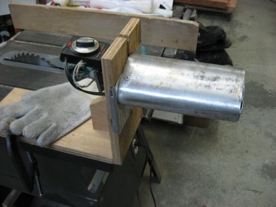

I was traveling during the earlier part of this discussion. Here is my pipe and controller. Against advice, I do not have a timer on it. I'm pretty anal about unplugging everything when I finish a session.

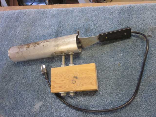

Here's the pipe part. It's pretty self-explanatory. The threaded rods are 7/16". The lower block gets clamped into a bench vise. My charcoal lighter didn't fit into the pipe. I plugged it in, let it get red hot, unplugged it, then bent it narrow enough to fit with a large pliers. It didn't break. (If it does, a new one is only $15 at Lowes).

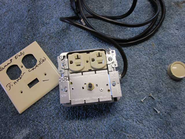

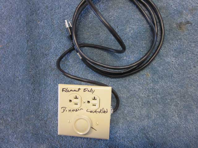

Next, the control box.

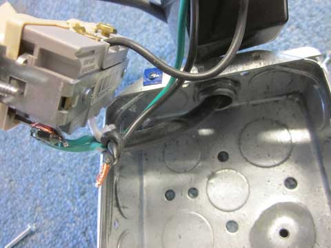

I used a standard power tool cord rated for 12 amps. The advantage of this is that the wires are properly color coded. Black is hot, white is neutral, and green is ground. Note that there is a cable retainer where the cord comes into the box--you don't want to pull your connections loose by leaving the wire loose to move.
I hope that it goes without saying that all work is done with the power cord unplugged.
Strip about 5/8" of insulation from the end of each wire. Before you attach any of your wires, twist the stands tight so that there will be no escaping strands to make an unplanned electrical connection. All of your connections will need to be tight! Any looseness makes a high-resistance connection that can result in extra heat and even fire. With stranded wire, I usually wrap it around a screw post in the same direction that the screw turns when it is tightened.
The outlet has a hot side and a neutral side. Usually, it is labeled on the back, but if not, the hot usually is the gold screw and the neutral, the silver. The ground screw is green. Twist the green wire from the dimmer to the green wire from the power cord and install both under the green screw on the outlet. You can connect the neutral (white) wires to the appropriate connection on the outlet (there are two screws for the neutral--you can use either one in this application). The dimmer interrupts the current path from the power cord hot wire to the outlet. So, one of the black wires from the dimmer is twisted to the hot (black) wire from the power cord. The other black wire from the dimmer is connected to the hot side of the outlet.
The twisted connection is then covered with a screw on electrical connector (which is tightened until it won't turn anymore).
Your dimmer may have different attachments but the principle is the same--it interrupts the hot side.
Put all of the items in the box and test the box by plugging a lamp (with a filament bulb) into it. If it doesn't work, unplug the power cord and figure out what you messed up.
To add a timer, get the plug-in type (rated for at least 500 watts) and plug the power cor into that on the way to the wall.

My pipe has a nut on the inside and a nut on the outside of the pipe on each piece of threaded rod. I made it so that it stands off from the wood because my first incarnation, where the pipe was bolted into a wooden cradle, scorched the wood into charcoal.

Thanks to all! My DIY Heating Pipe is now finished! Thanks again, Bob! I used U bolts with couplers to extend the distance from the wood base to the pipe. Tested it out. Works like a charm
