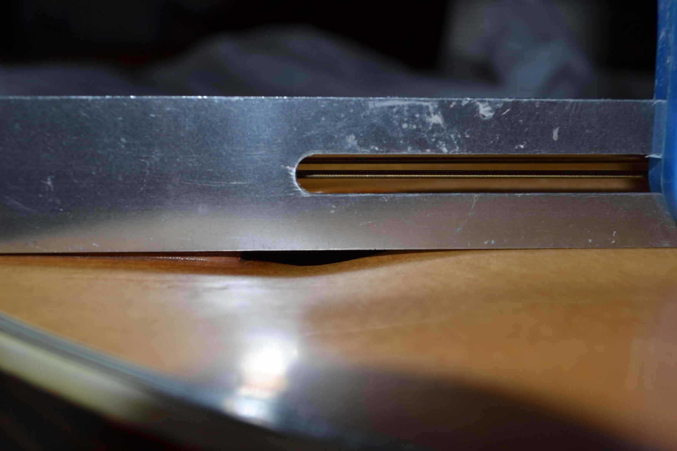

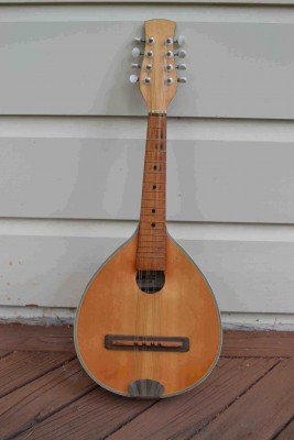

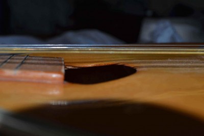

Hi everyone. I just joined this forum to see if anyone can advise on this: I've just scored an old Ibanez mandolin, which has a lovely rich sound, but the top is warped around the sound hole, causing a high action and some buzzing. I've attached some pics: I've put a straight edge across the warp for reference. As you can see, the top is pulling the fingerboard down. My question is can this be fixed by applying some heat and reinforcing the underside of the top around the sound hole, or will I have to take the top off? Hope you can help

To help you think a little more clearly of the cause of the problem, the top is not pulling the fingerboard down- it's more the other way around. The string tension is pulling the neck up, and twisting the neck block. That forces the end of the neck near the soundhole down and has changed the neck angle, which makes the action very high. In short this mandolin is losing the battle with string tension.As you can see, the top is pulling the fingerboard down.
