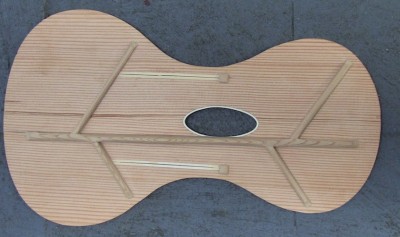

Jason, I have another flat top fiddle on the bench and decided to post you a pic of the bracing system I use.

Re: Experimental Violin
Barry, just a question for you- what is the grain direction in that long brace? It looks the opposite of what I would use in a guitar.
That's some super-funky bracing, Barry. Like branches. Very interesting, indeed!
I think Mark is asking about flat vs. quartersawn for the braces, yes?
So, those "sound holes" are just slots to give the top the same type of belly movement as a standard violin instrument? Why did you decide to use a "guitar" soundhole? (Is this where the McLennan reading comes in?) It seems to me that this is creating another open/broken edge in the plate that takes it farther away from standard violin geometry and mechanics. I can picture this instrument with side ports or some of those top/side edge ports.
Yes Mark, they are slab cut very much on purpose. There is a school of thought out there that flat sawn is actually as strong as quarter sawn while being more flexible for the application such as a bass bar in a violin. That combination appeals to me because, while the sound post is the "island" in a violin, the bass bar is the boogie master. More reading here http://liutaiomottol...quartersawn.htm By the way, Stradivari made a number of violins with flat sawn bass bars during his golden period.
Jason, correct. The "slits" are there to free up more of the vibrating area of the belly around the bridge. That's why they are so close to the "C " bouts. Good question on the sound hole. John McLennan suggested to me that he envisaged the sound hole under the finger board, but when I pointed out that the sound post would then be a nightmare to fit, he agreed. However, he then suggested that the sound hole be elliptical and the slits vertical. An elliptical sound hole better accommodates the traditional position of the bass bar and curiously, in the scheme of a two litre violin (usual average capacity), to achieve 280 Hz, the area calculation of the sound hole is 1375 square millimetres.
In the elliptical shape, this works exactly for the bass bar to sit right along side the sound hole as you can see in the last pic. The bass bar in the first experiment with a round hole misses the bass foot of the bridge by nearly 5 mm. Not ideal.
