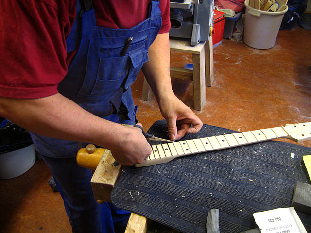

Jeff, I would recommend fretting the fingerboard first. You could also mask the frets with narrow strips of masking tape before spraying the lacquer. It only takes a few minutes, far less than cleaning the frets afterwards.
I cut 1" wide masking tape to 3 mm wide strips with a scalpel and a steel ruler, then masked the frets over before lacquering the neck.
