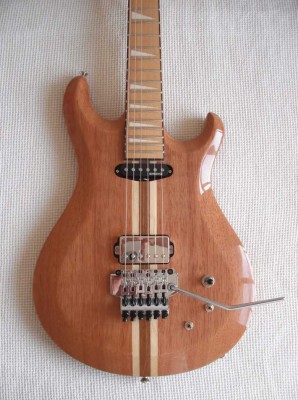

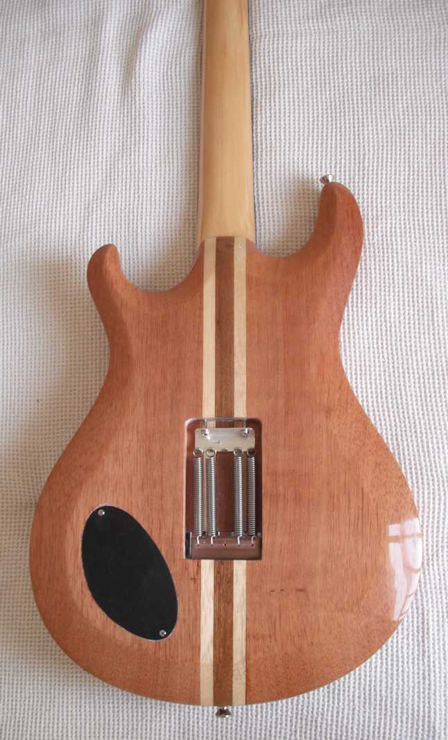

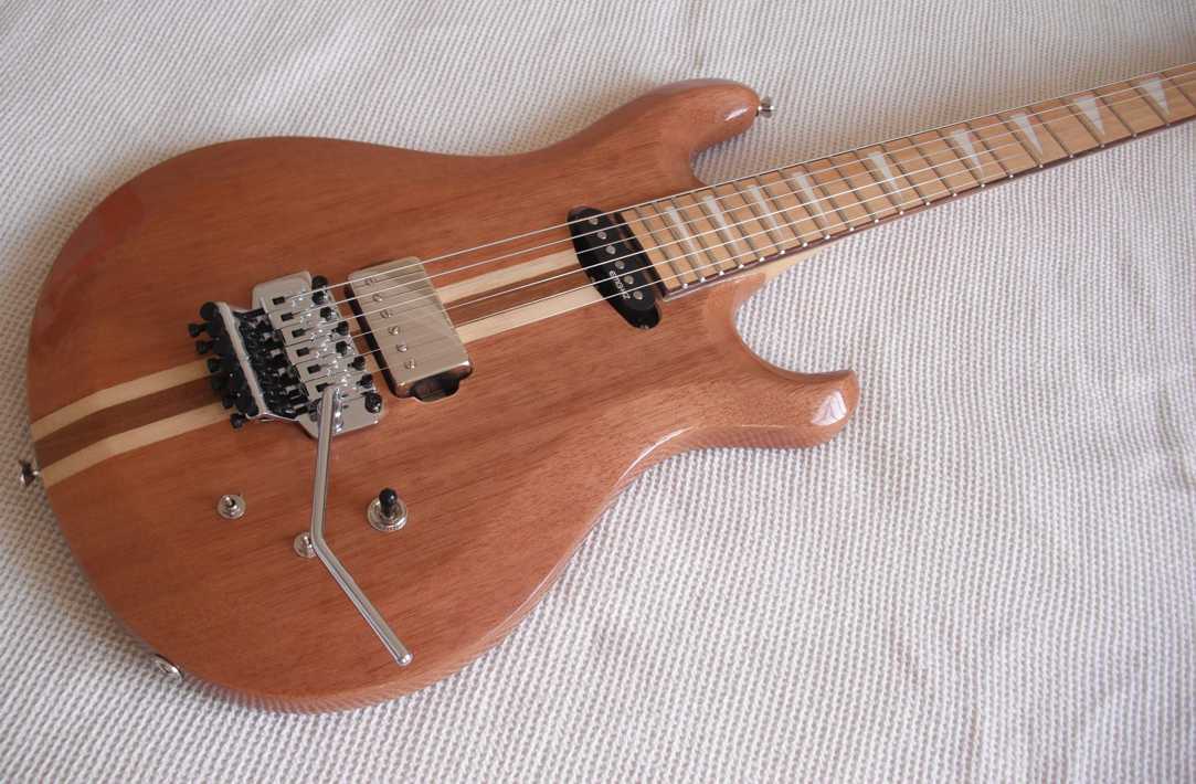

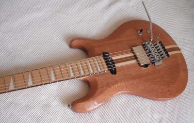

Something conventional for now. My first time using the pickups screwed directly to the body. Also experimenting with the "minimally carved", top-mounted floyd rose.
Woods:
Neck and fingerboard: pau-marfim
Neck binding: rosewood
Body: cedrinho
Stripes: canela-preta (center) and marupá
Pickups:
EMG single coil and Golden Age HB
Electronics:
Three-way switch
Series-parallel switch for the bridge pickup
"Tone-choke" switch
Comments welcome.

Re: Henrique Schneiter's latest guitar
That is really beautiful! I could play that one all night long. I like everything about it, the woods are interesting.
Can you tell us more about the method you used to carve that body? And what type of neck joint did you use? Great job!

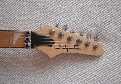

Great job! Clean, simple, and the different woods compliment each other nicely. The only thing that bothers me is the truss rod cover. The stark black just looks out of place to me and throws the whole instrument out of visual balance. I think it would look much better if it was the same color as the body, but that is only my personal opinion.
I think I see the shafts of two pots right where you'd expect them to be? Or are those something else? What's your theory on knobs?Mark Swanson wrote:I would need a volume control though. And can you explain the "tone choke" switch?
That said, this is a beautiful guitar and I love the choice of woods. Gorgeous neck, too.

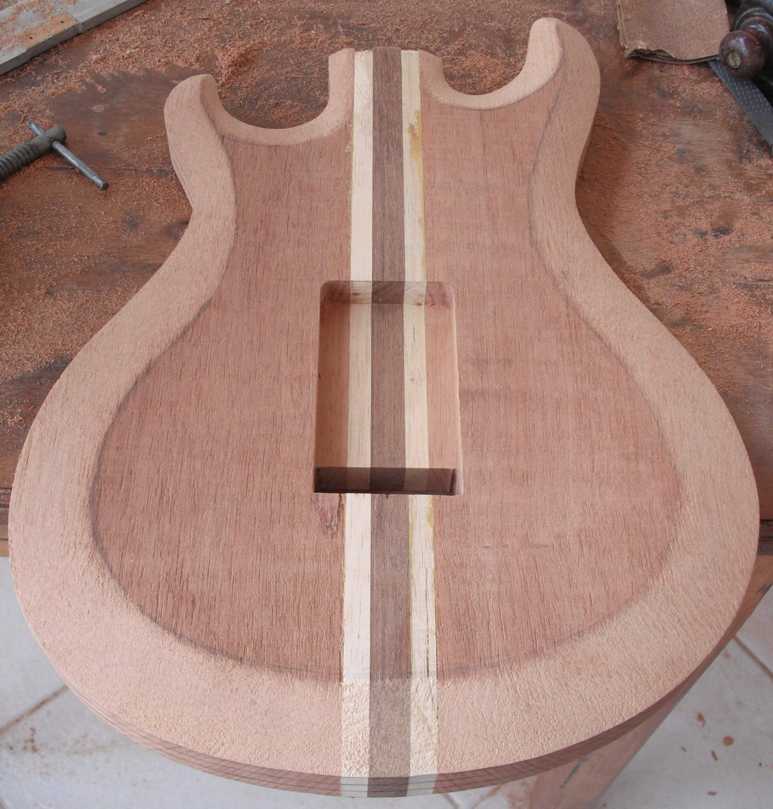

Thanks a lot guys. I'm happy with it, though I'm still adapting to the 0.11 string set on it.
Mark, the carving was done with hand rasps, scrapers and a lot of sanding. I draw concentric lines with a compass, 2 cm away from the edge on the upper bout and 3 cm on the lower (merging them on the waist), draw the depth on the sides an work with the rasps. Nothing really fancy here. The pics below show the drawings and preliminary carving.
