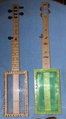

One more:
Self tensioned heat shrunk PETE plastic

This is the PETE head, with steel strings and frets (the green plastic head). Tuning is cGCeg (like gDGBD capoed at 5th fret). It has a 20 inch scale length.

Here is the sound file for the other PETE head - same tuning and scale length, this one is nylon string (fishing line) and fretless.
