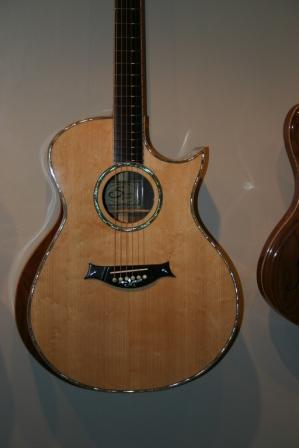

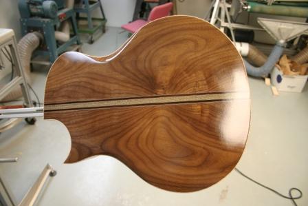

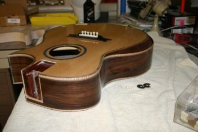

Danny, my personal opinion is that a arm rest is a real nice feature to build in. I actually did a arm rest, chest rest and leg rest on my first acoustic build. I know, not real smart but I like a challenge. And it was a challenge, it gave me fits, took alot of time but they are just so comfortable. Could debate the effect on how the guitar sound, but that is better left to the more experienced folks here.

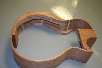

I am sure there are many different ways to do them but what I did was............build up the area where you want the bevel. The linings that is. I actually built up the lining using two pieces of 3/4" wood. The pictures speak a thousand words. It looks like allot of timber in that body, but most of it will get removed. The real fun was the binding.

I few more............ Like I said the majority of lining will get removed.
