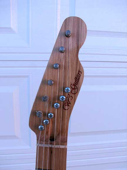

Technically I'm building a solid-body electric guitar, and the concepts are probably some that super-budget electric builders have explored previously, so I figured this would be best here.
Long story short, I'm trying to build the world's cheapest / smallest lap steel (or something approximating it anyway) on a 10" scale, using aluminum angle and a chunk of 2x4. I'm stringing it with the smallest plainwounds I can find (which, at 10", are unfortunately still not small enough).
More long stories short, I am trying to avoid using conventional tuning machines to keep both cost and build complexity as far down the foot chain as possible. It would be really nice if I could build more of these absurd things for like $20 or less a pop in an afternoon each as "gateway drugs" for lap-steel-curious friends.
Right now I have three panhead screws on each string serving the roles of "locking nuts" and actual tuners. The back two screws hold down the string as taut as I can possibly get it by hand (which is to say, not very taut), the screw closest to the "nut" actually serves to bring the string to pitch by changing the final break angle as it is brought in and out of the 2x4 with a screwdriver.
To my surprise, this actually works... to a degree. It just can't get the strings as tight / high-pitched as they ought to be given the ridiculously small scale, and there's too much time consumed and unpredictability (and physical pain!) bringing the system to initial pitch "by hand" on each string before lockdown.
I've spent a few hours cruising the hardware aisles trying to find a combo of off-the-shelf parts that would get me a more viable tuning / string retention system. I haven't been able to find much that would work. (The lug terminal at the top of the "headstock" was a failed experiment in fashioning a tensioning crank, usable for all strings, that could be used before locking the string down initially; it doesn't work, unless the goal is to break a string in record time.)
I'd be happy with just a hand-turnable tensioning crank that worked, as just one such device would let me keep the blissfully / stupidly simple screw setup. But I can't seem to find the magic parts in the Home Depot / Ace hardware drawers that would let me put one together.
I'm open to any / all MacGyveresque ideas for any kind of tuning alternative to the absurdity of... this... but using parts that I don't have to go out and special-order at the machine shop, of course. Anyone got any ideas I could try?

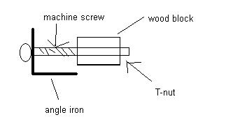

Wow, I thought I was cheap. You might have an easier time cobbling together a portuguese-style tuner from hardware parts than a standard one; see http://www.mandolinluthier.com/fado_page.htm for what I'm talking about. I'm attempting to attach a diagram of what I'm envisioning:
side view, per string
You could tie the string somehow to the wood block (or put the ball end on that end), then let the screw do the tensioning. Seriously though, I've bought a set of 6 standard guitar tuners on craigslist for 10 bucks before. I don't know where you are, but cheap, real parts may be closer than you think.

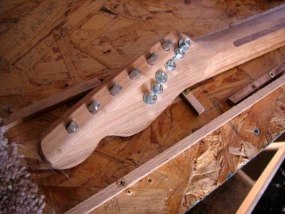

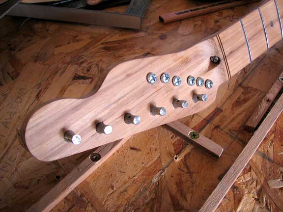

I just used steel rod press fit into a hole - it holds the tension fine. The end is filed to a square profile so you can turn it with a wrench. I initially made fine tuners from machine screws, but these were unnecessary - it's easy to adjust the pitch just with a wrench. On a lap steel, where you may not have access to the bottom end of the rod, you could make the top square, then have a portion of the round rod with the string hole in it just above the entrance into the wood.

It's Lyptus, from the scrap heap of a cabinet shop. I made the whole guitar for $5.00, so you can do it easily. What kind of pickup are you using - that is the most expensive part of anything I've made, even winding it myself.
Subsequent to this, I found a box of 200 piano pins at a yard sale for 75 cents, so I'm set for life for ultra cheap tuners.
