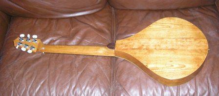

Even simpler is to bend using a large frying pan with an inch or so of boiling water in it. You have to flex the wood enough cold to get part of it into the water, which should be no problem with thin wood for mandolin sides. This quickly heats that part to "real" bending temperature, and you can bend it, move the wood along to another section, bend again, and repeat as necessary. You can quickly get a side bent well enough to go into a body mold this way, using equipment you probably already have in your kitchen.
I bent the sides for this instrument and its twin using that method:
