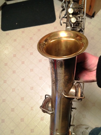

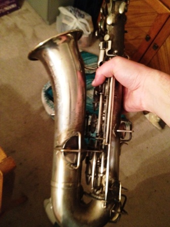

Working on this last night.
Lots of polishing
Lots of polishing

Post by Owen Woods »
Beautiful!

Post by Chuck Piper »
Thanks! I am trying to take it slow so I don;t screw anything up, but it's always nice to see shiny clean spots!
