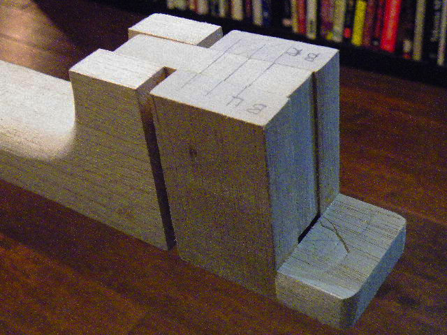

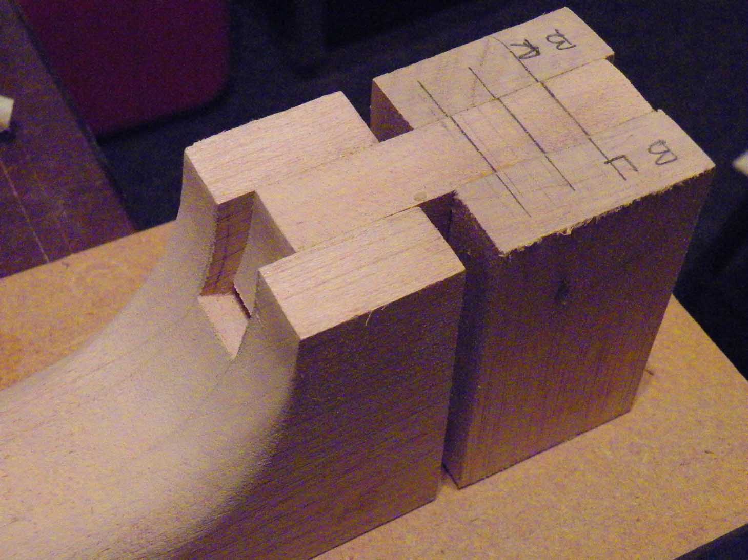

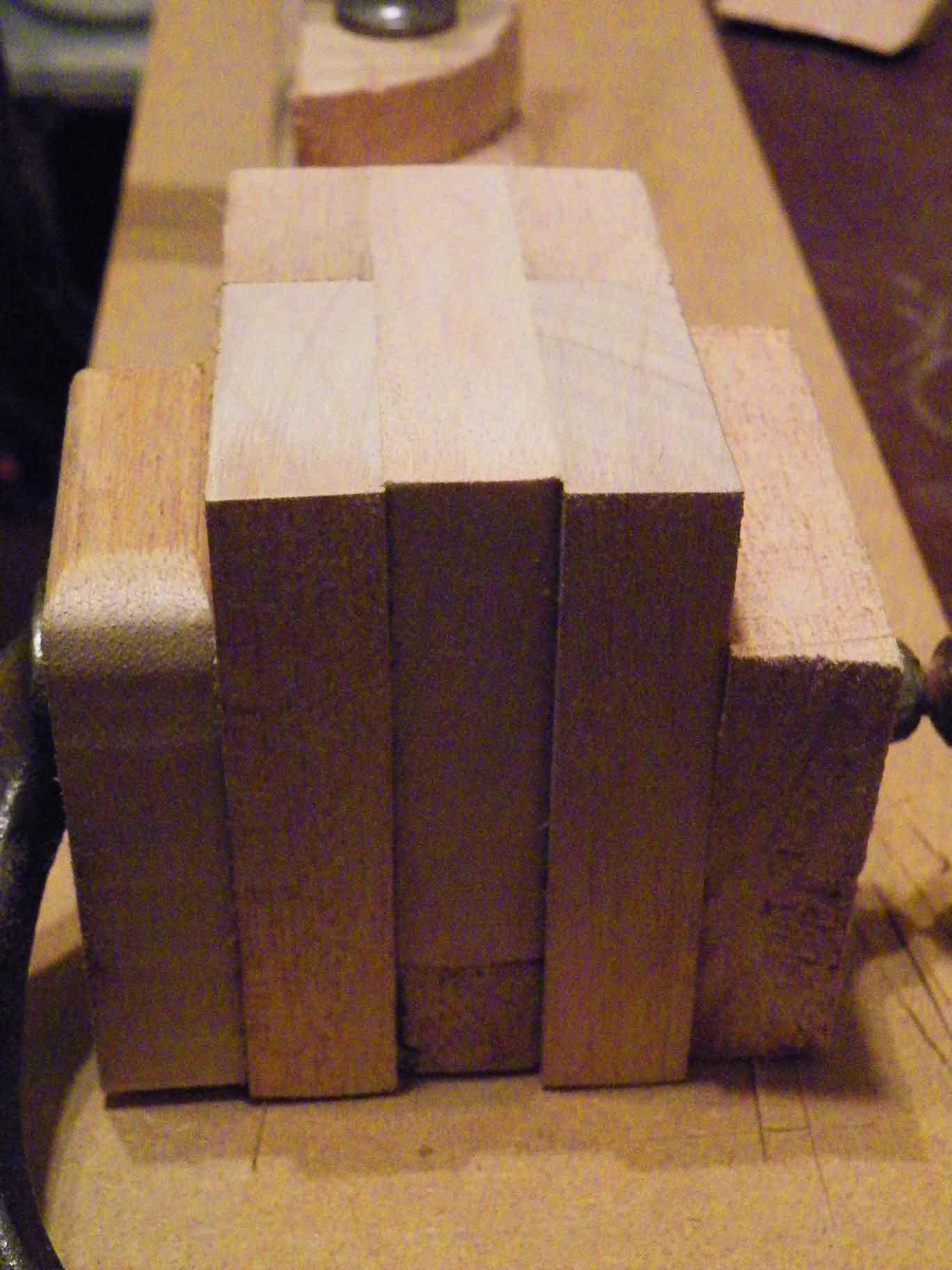

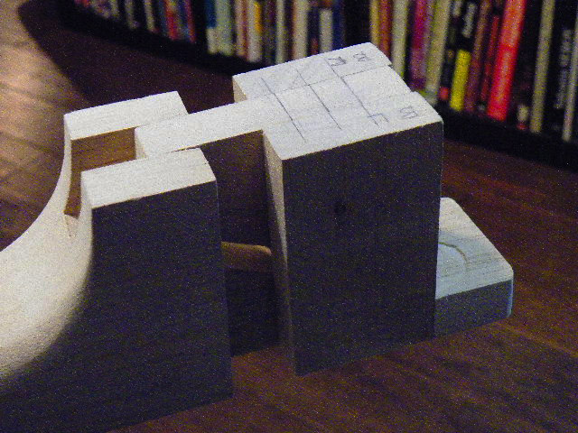

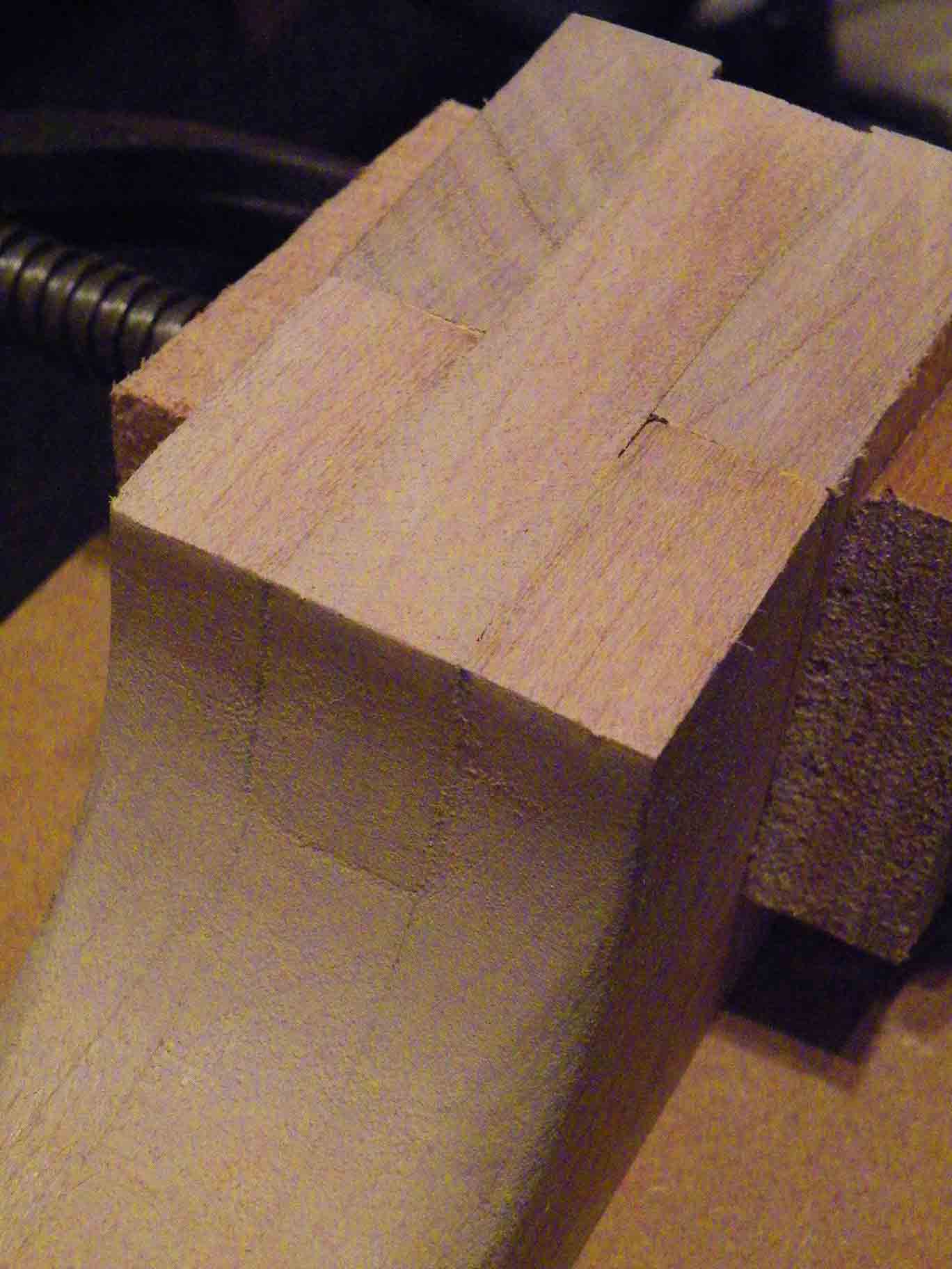

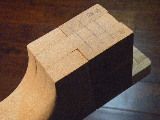

Here is the neck block created. I hope I have my terminology correct...neck block? I created the 3 elements, clamped it to the neck, proceeded to sand it flush. Then, I drew lines for lining it up again for glueing. The glueing was a bit tricky as it kept slipping as I tightened my clamp. I backed the assembly out of the neck so it would not glue into the neck.

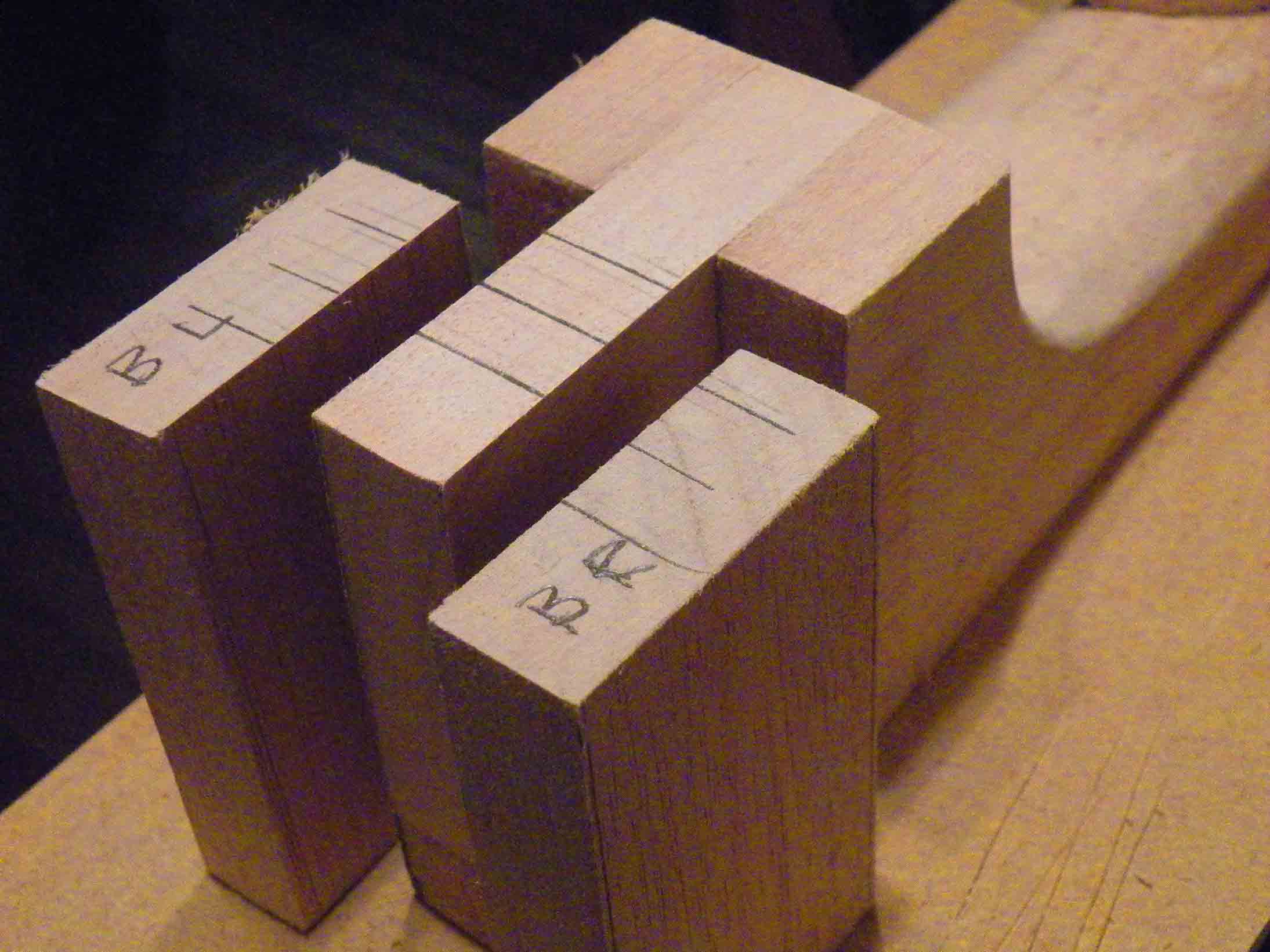

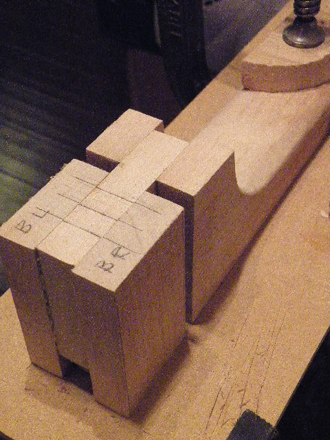

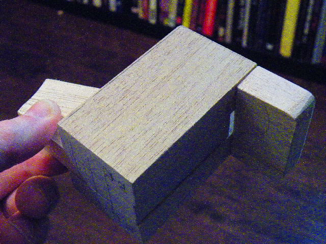

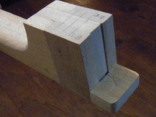

Here are some more pics of the finished neck block. I am pleased to say the joint is a very snug fit.

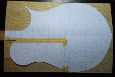

Post by rob bowen »

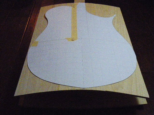

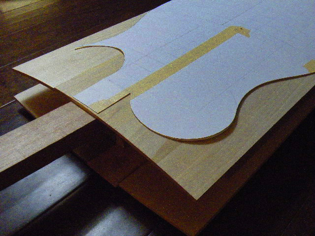

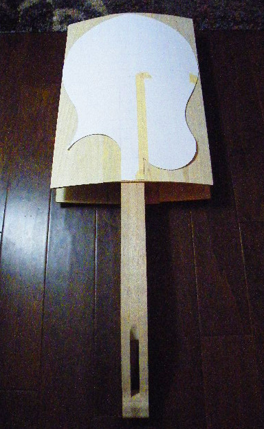

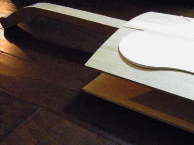

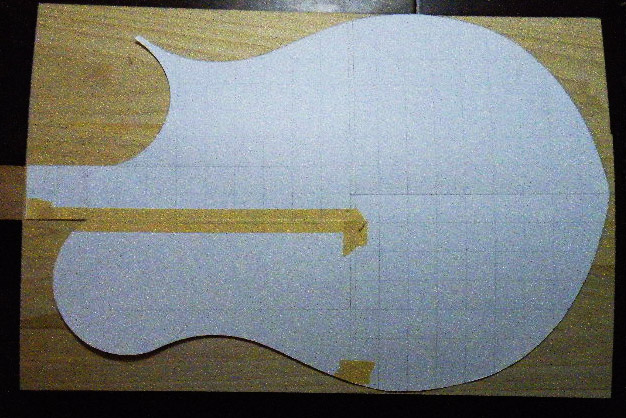

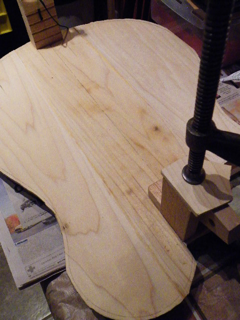

I have started making the top and back of the guitar body. I am aware that this is ridiculous in the eyes of a true luthier, remember I have posted this build in "experimental". I have heat bent the soundboard and back, and I have drawn up a body shape I find pleasing.
The cylindrical top and back arching, while they may look a little odd by today's spherical standards, has been done before.

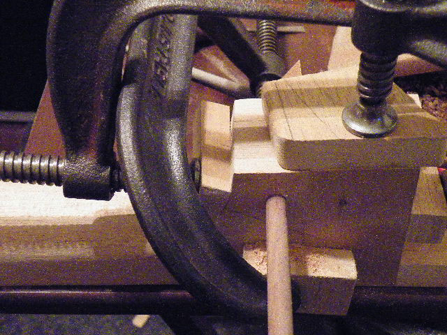

Location: Vancouver, BC
Post by rob bowen »

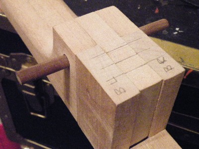

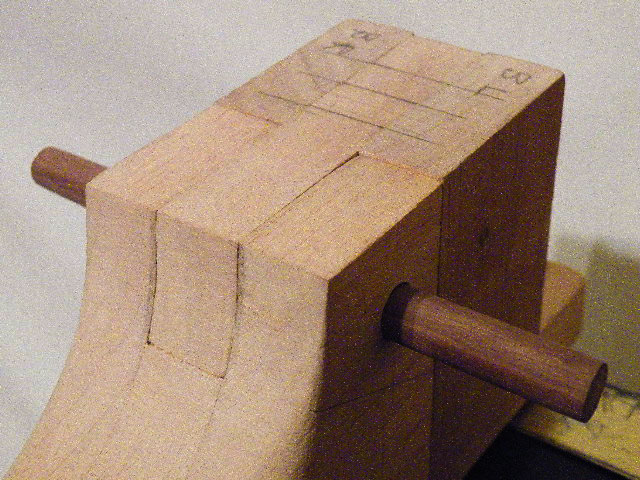

I have been sort of dreading creating the hardwood dowel and the accompanying hole in the neck/neck block assembly as I believed there was a 50% chance I would foul it up and have to start over. I clamped the joint tight and proceeded. To create the dowel, I carved the walnut to the approximate size, then got an idea to insert one end into my drill....poor man's lathe. It worked surprisingly well. Whew...that part done. Now I can proceed with the body.

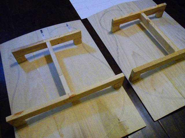

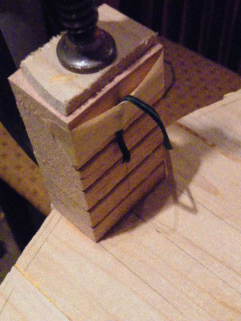

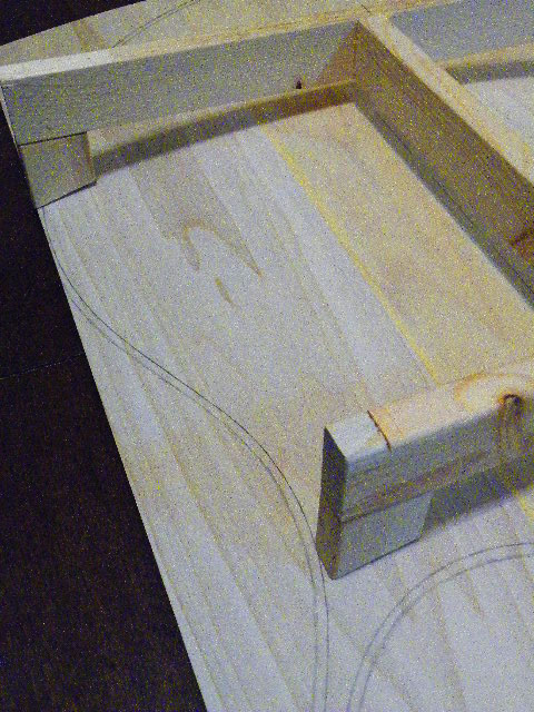

I came up with an idea for applying pressure around the perimeter of the soundboard and back while I am glueing in supports. After the neck block and end block are glued in place, I will use these clamps / supports with a weight on top.

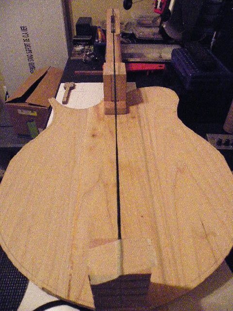

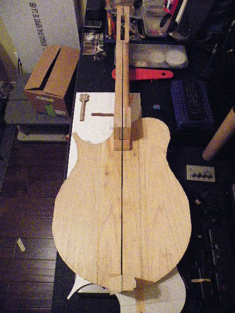

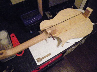

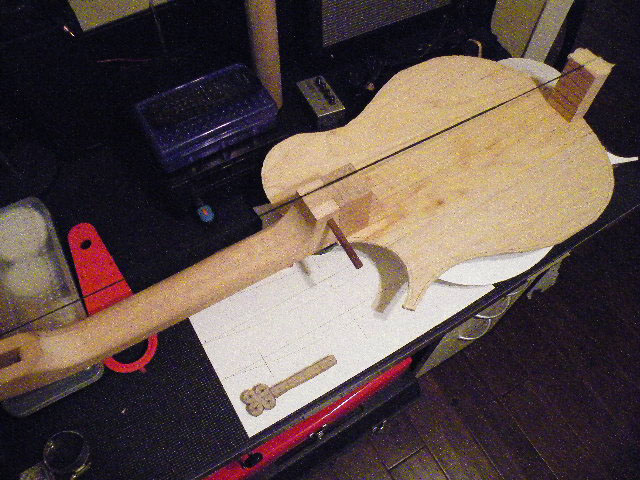

Tail block and neck block glued in today. Soundboard cut out. I used a string running from the center of the endblock to the top of the peghead in an attempt to install the neck block true. Time will tell.
rob bowen
Posts: 122
Post by rob bowen »
So, last night I removed the clamps and re=attached the string between the headstock and the endblock. The neck block appears to be installed fairly true ... good Lord ... what a relief!
