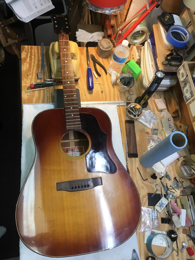

Up next on my repair bench is a Gibson J-45 dated from 1975. There are several serious issues with the guitar including:
1) A neck with a very bad twist and the need for a neck reset. The guitar is currently unplayable.
2) A bad case of binding rot.
3) Some previous, questionable and poor modifications to the bridge.
4) The need for some new tuning machines and pickup.
Someone also previously removed the shrunken pickguard and repaired a top crack next to the pickguard, but this needs a bit of additional work. All in all, this is a nice guitar but there is a ton of work to restore it. My goal is to get the neck back into playable condition and to replace the binding without having to do any re-spray on the finish because the finish is otherwise in pretty good condition except for a couple of deep scratches and a case of buckle rash on the back. Also, do you see anything unusual about the bridge? More on that later.
By the way, I started this repair about three weeks ago so I have a bit of catch up to do to bring you'all up to speed. So you will see a flurry of posts here.

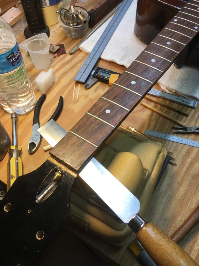

Also, someone has previously removed and reglued the fretboard because I can see a 1/32" glued filled gap under most of the fretboard. Also, I can get my seam knife under the fretboard up to the 1st fret without any effort. The fretboard is brazilian rosewood so we will definitely be saving this.
- Posts: 3242
Re: Repair of 1968 Gibson J-45

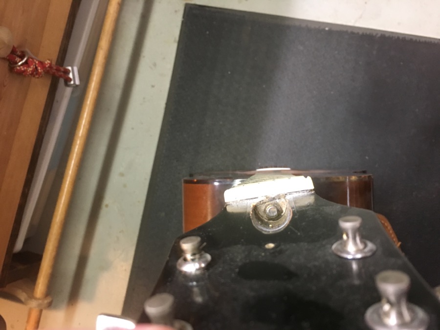

The fretboard was easily removed with a bit of heat. And then I saw something very interesting. The truss rod nut is a bit off-centered. Was it built this way? Could this be the cause of the twist? I need to dig a bit further.
By the way, that is a new nut I placed on the truss rod. The original one was completely rounded off. I had to remove it with needle nose vice grips.

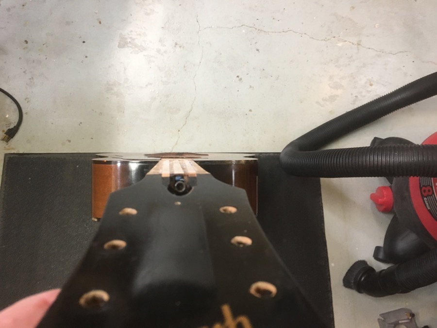

- Posts: 3242

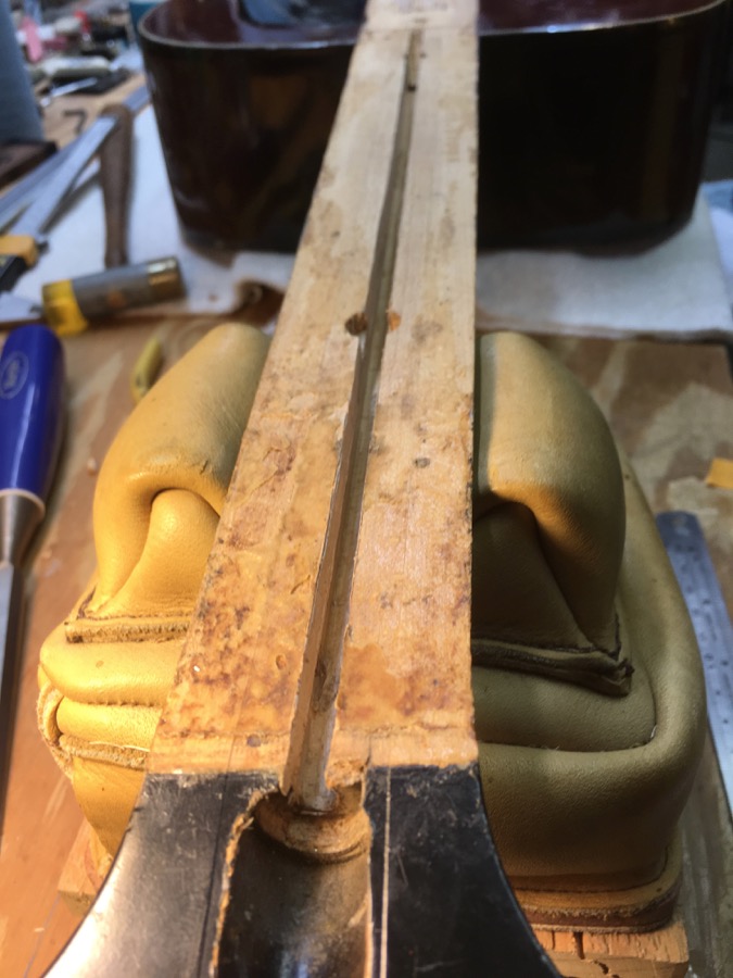

Time to dig out the truss rod. A bit of chisel work and out it comes.
- Posts: 3242

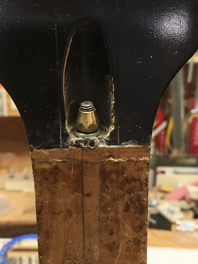

The actual slot does not appear to be off-centered. Also, I can see that a bunch of compression is present under the truss rod nut. I looks like the washer has compressed the hard maple 1/8". And during this compression the end of the truss rod has slipped sideways towards the bass side of the neck. I also see that some of the neck wood right under the nut has erupted due to the compressive forces. This is starting to look like a serious case of truss rod over-tightening. They may have been trying to avoid the neck reset issue by going crazy with the truss rod. And I think this is what caused the truss rod washer and nut to slip sideways resulting in the twist. I can't believe that someone could compress hard maple this much without snapping the rod.

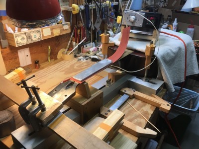

- Posts: 3242
So the repair plan for the neck that I formulated is to:
1) Heat set the neck and fretboard to get them into a straight position without twist or excessive bowing (I forgot to mention that the neck is also bowed up about 1/16").
2) Rout slots for two carbon fiber bars and install them.
3) Get rid of the original compression rod (the cause of all this mayhem) and install a modern dual-action rod because this will cause no additional compressive forces on the neck.
The guitar goes into my "Teeter Neck Compensation Jig" with a long board clamped on the peghead to unwind the twist. Some heat from a heat blanket and the twist is taken a bit beyond straight and then allowed to cool. It came out pretty straight. I am going to take a break and get back to the shop now. Feel free to post any questions or comments. I value your input.

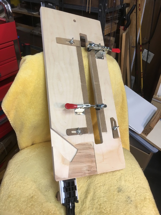

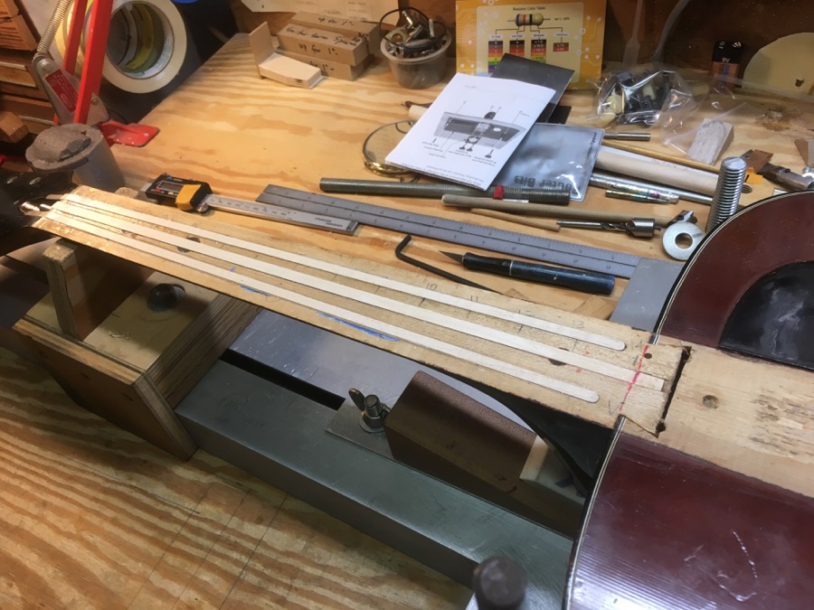

- Posts: 3242
Now to stabilize the neck with the following:
1) A dual action truss rod made by Mark Blanchard. These things are top notch.
2) Two carbon fiber rods sized .2" wide and .25" tall from Dragon Plate.

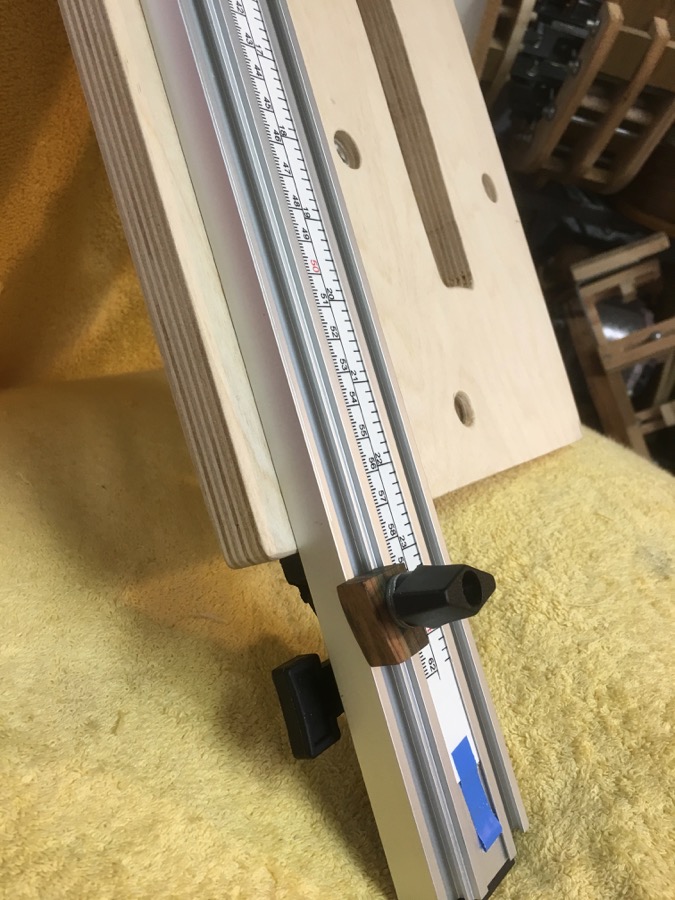

This will require cleaning out the old truss rod slot and cutting two new slots for the carbon fiber. Then maple splines will be glued on top of all three. My plan on the carbon fiber is to flare them out near the body so that they provide some resistance to future twisting. Also, I plan on placing the carbon fiber slots to cut into the neck lamination joints up near the peghead transition to lock these two questionable joints together. I will use West Systems epoxy for all of this and will add chopped polyester fiber additive to get as much strength as possible. Since the placement accuracy of the slots is critical I needed to remake my truss rod slot jig.
The jig was made with a piece of 3/4" baltic birch plywood, some toggle clamps to hold it to the neck, a Woodriver edge clamp and router plate, and a small plunge router. Once the base is clamped to the neck, the edge guide can be precisely manipulated to place the slot accurately.

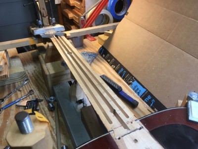

- Posts: 3242
The jig took me a few days to build and about 30 minutes to use. Here are a couple of more photos. I added some small stops in the T-track to control the start and end points.
The back of the jig was routed in areas to clear the pickguard and the bracket on my string compensation jig. The jig also has four sliding stops that I butt up to the neck to keep it from slipping. Strips of 100 grit sandpaper were glued on both sides of the big slot to further prevent slippage.
- Posts: 3242
The slots turned out really well, much better than my old jig which was a pain to adjust.
The truss rod re-slotting was a bit fussy. The original slot had a curved bottom and the new rod needed a nearly flat bottom. So I lowered the slot carefully to prevent over thinning. I used a round bottomed router bit because the original slot was also round bottomed. I ended up only taking a bit of additional wood from the bottom of the original slot at the lower end, and even less wood up near the peghead in my goal to get the slot flat. I stopped as soon as I got close.
- Posts: 3242
I glued all the stuff in one swell foop. I placed a small jack under the middle of the neck to remove the slight bow, and I still have the neck twist controlled during the slot cutting and the glue up.
The small popsicle sticks are small wedges to place clamping pressure on the truss rod filler strip which was slightly lower in elevation than the carbon rod filler strips.
- Posts: 3242
This morning I removed the clamps and planed down the filler strips a bit. The neck is much more stable as determined by twisting the headstock. The neck twist is actually a tiny bit in the opposite direction than when the guitar came in. I am OK with that and will deal with it latter.
- Posts: 1188
I have a couple of thoughts...questions.
Would the jig be simpler with a guide bushing set up? Don't get me wrong, there is no wrong way as long as it works!
On second thought, I realized that with the thickness of the jig, the bit would be sticking out a long way if a guide bushing was used.
Do you think you will have to do something with the neck laminations separating?
Or do you think the heat from the blanket loosened the glue enough for it to reset?
