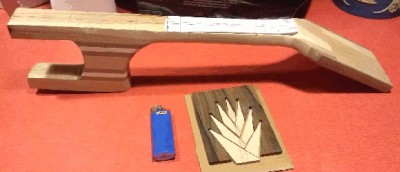

Build #B1 is inspired by #B0, but it's my own design completely, and I'm building it soup to nuts. I got the back and sides from a reputable tonewood company of the East Coast, off their sale rack. As someone just starting out, exquisite wood is wasted on me. The Back and Side set is Italian Olive, the soundboard from the same people is Western Red Cedar, and the neck is cherry from a major workworking supplier, a craft board of 3/4"x3"x24", which turns out to be just the amount I need for a Spanish Slipper. My design has the neck meeting the body at the 13th fret, but going on in the full length of the fretboard, defined as 3/4 the scale length, 24th fret, plus 1/4", to hold the fret in place. At at 17" scale length, the 13th fret falls at 8.977" past the bottom of the nut, which I call Inch Zero. That's 8+31/32 on the ruler, and my eyes much prefer I round that to 9", which is where I put the line on the top of the neck and down through the heel stack. The heel is stacked up with cherry at 3/4, which forms the neck and the top toe of the slipper, then a laminate I made with the white wood of rock maple contrasting with walnut on either side, all in 1/4" stock, to make 3/4" stock, and this was piled up with pine in the part to be milled away, with cherry, WMW lam, cherry, lam, and cherry again, for a full 3/4" times five or 15/4 or 3+3/4". I'm going to lose a 1/4" off the top of that stack to get into my design, which has side wood at 3+1/2". So that's the back toe trimmed by 1/4", and the top toe will also need to be trimmed, nominally by 1/4 but in practice by whatever the top thickness happens to be when I join it to the top toe and the sides, so the underlayment for the fingerboard is continuous at the neck "joint", which is really just the side joint, as the neck and slipper are continuous. Anyway, the top toe needs to accommodate the top, and the fingerboard will overlay the top and part of the rosette, all the way down past the sound hole, and I'm going to trim the slipper at the soundhole, and possibly the fingerboard as well.
Here's a picture of the neck assembly:
This is the neck/head/heel/slipper blank, partially carved.
More in next post.
