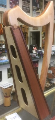

- Posts: 469
Re: Any harp making experience here?
Finished the first of three using the plans. I generally stayed to the plans I purchased but applied a change or two to make it a little more structurally hardy. The build is much more like making a piece of furniture than a musical instrument but I cannot fault the tone. It makes a wonderful tone that actually sounds like a harp. I used African mahogany for the pillar, the neck and structure of the sound box. The soundboard and back are 3mm aircraft grade birch from Finland as suggested by the plans. The trim on the soundbox and the center reinforcement is some jatoba that I had already. My only major change was the use of maple on the left side and how it reinforced the neck. Its what I had on hand and is overkill for strength. I'm not sure whether I like the contrast or hate it but it didn't really add any significant weight and I know that the neck isn't going to split. It was an impulse modification but the mahogany I had ended up to be about 3/16" thinner than the spec after surface planing and felt very light. I'm pleased with the result and will build more harps
Very nice!
Good Job! I hope you were able to check out my friend Jim's harps, and his playing. I'll try to show him yours.
- Posts: 469
I would really like to make contact with other harp makers to share ideas and learn more. I checked out Jims youtube vids -- like what I saw. His server is down on the link associated so I'm unable to contact him. Its been a week or two since I strung up my Shepard harp to pitch and its getting more tuning stable every day. The strings supplied by the vendor are probably not the highest quality and I'd like to see what the result would be with really good quality classical strings such as ProArts or others that I use on my classical guitars. The plans are good but I feel the plans are aimed at non-luthiers. There are one or two critical procedures that need to be overcome but the rest of the build is really simple and its comparatively inexpensive to make these compared to making a guitar. I have two more harps in progress using the basic geometry/ideas of the Shepard harp plans. I'm also trying wood carving for the first time. This is on African mahogany. I'm eager to learn about making my own soundboards. I think my email address is available and I would be grateful to connect with other harp makers.

- Posts: 469
The latest. This is #2 using the same plans again. This time, all mahogany construction except for the sound board itself which is the imported birch aircraft ply. I added a little more structural strength for steel strings. With the steel strings , the tone was terrible so I stayed up until 2AM removing them and installing a nylon string set -- nice result.
- Posts: 3253
That's great! My friend Jim would approve.
