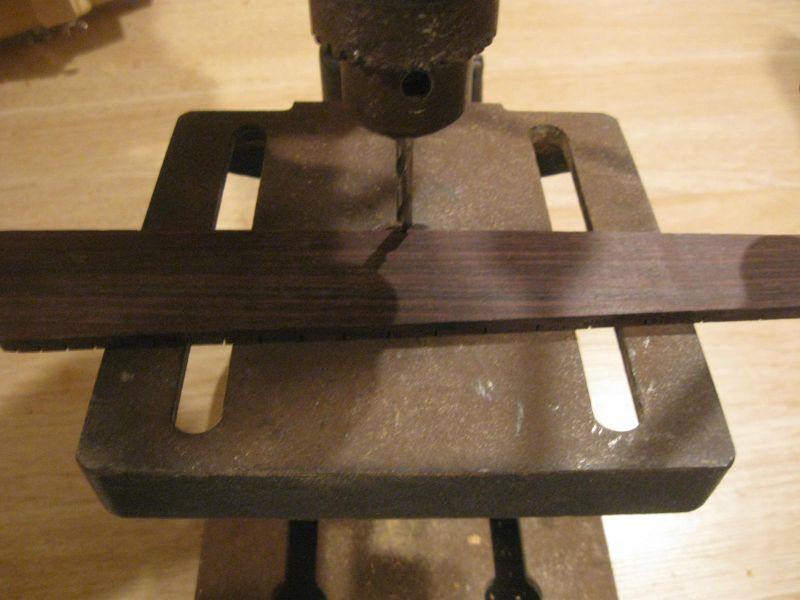

I found some fingerboard dots I had left over from a previous job turning a diatonic dulcimer into a chromatic one, and they just happen to be blue. Perfect! They are 5 mm diameter by 2 mm thick, and I thankfully have a 5 mm brad point drill to match. But with a lousy drill press, how do I get the depth just right? Laminate floor spacers to the rescue yet again!
I put the fingerboard face down on the drill press, and set the depth stop so that the flat part of the bit (the edges stick out further on a brad point drill) sat firmly on the fretboard. My floor spacers are 2 mm thick on one side, and 5 mm on the other, so I simply used two to hold the fretboard, now right sided up, 2 mm up off the drill table. Perfect 2 mm deep holes every time!
A drop of superglue, press in place, and the fingerboards have dots.

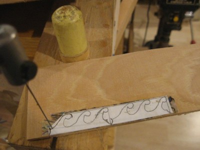

For the wave inlays I am using Ablam (sometime Abalam). This material is actual shell, CNC milled into very thin slices, color matched, then epoxied together into sheets. This stuff has gotten ridiculously expensive in recent years, but I got a big piece off e-bay quite a few years back for next to nothing. The piece I have fortunately has a lot of blue in it, which makes it perfect for water.
My Ablam is only 0.01” / 0.25 mm thick, so I cannot cut it directly without it disintegrating. Cutting it requires a trick Amy taught us years ago in the MIMF inlay class. It has to be glued to a backer first, and I just used a cutoff of my oak sides, 0.080” / 2 mm thick. Plain Elmers white glue works the best, but I didn’t have any, so I used Titebond. I glued the pattern on top with the same.
A small jigsaw with a very fine tooth blade makes cutting easy. The Pro-Cut wax makes it even smoother. I could not have cut these inlays without the backer! I clamped my inlay cutting board to the workbench and start sawing away. The blade is so small that sharp bends are easy, and there are so many teeth per inch that cutting is quite smooth and controllable. The cutting board has a long tapered slot with a 1/4” / 6 mm hole near the broom handle I used to thicknessing my tops, which gives the workpiece lots of support while sawing.

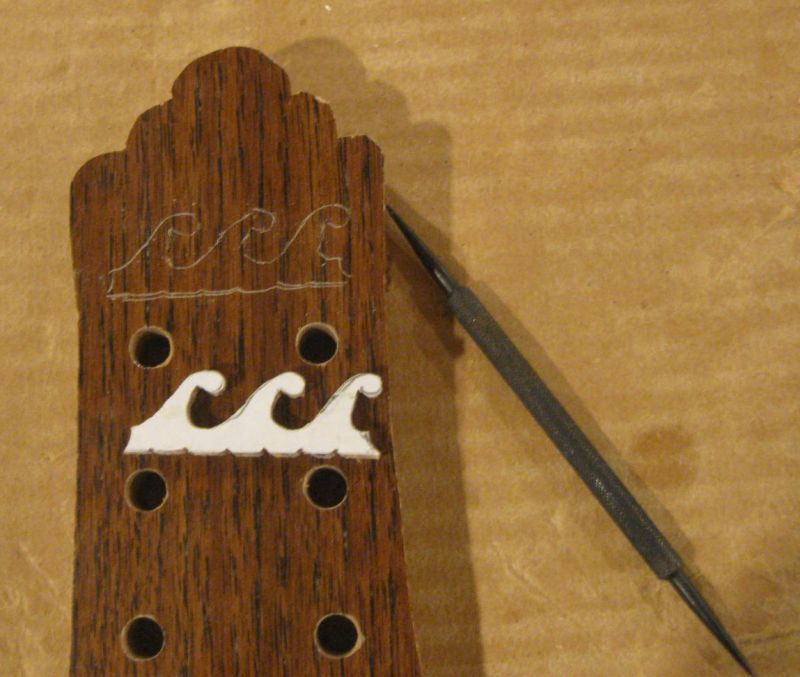

Before separating inlay from backer, I used a fine scribe to trace the design onto the head.
I dropped the inlay assembly into a shallow tray of water to separate inlay from backer. With Elmers it only takes a few minutes before backing, inlay, and pattern all just slide apart. I had to soak the Titebond overnight to get it to release, and even then had to use an X-acto knife to help it along. I will not use Titebond for this again!
