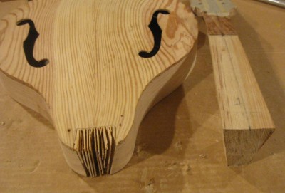

Now for the arduous and nerve-wracking step of fitting the neck. Siminoff shows many fine jigs in his book and on YouTube, but they are geared for production, and I have no idea when or even if I will build more mandolins, so I decided to attempt it by hand (well, mostly). First step was to cut the tape on the heel end of the neck. Nothing fancy about this, just two cuts at the same angle, straight along the sides. The taper is fitted to the block for this design, which is opposite of a traditional dovetail. If this joint had been cut on a bandsaw, the neck block would have been elevated, so that the cut is deeper on the bottom than on the top. Most plans show this to be about 6 degrees, but mine is a little shallower since I am not strictly following those designs.
My bandsaw cannot be counted on to cut straight, so I cut the two outside tapered cuts by hand with a razor saw, then used the bandsaw to kerf the inside of the joint. Using a hand jigsaw, I cut out the fins and cleaned up the joint with a sharp chisel. I had practiced making the tail block in a scrap of wood, but the real joint still took a lot of finessing.
The second joint seemed to go much smoother. I think I finally have both necks close to right. It is starting to look like a mandolin

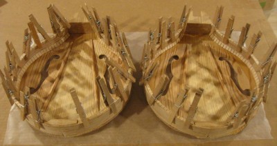

One last step today, glue in the linings for the back.
Tomorrow hopefully the backs will go on, and the necks will be glued in.

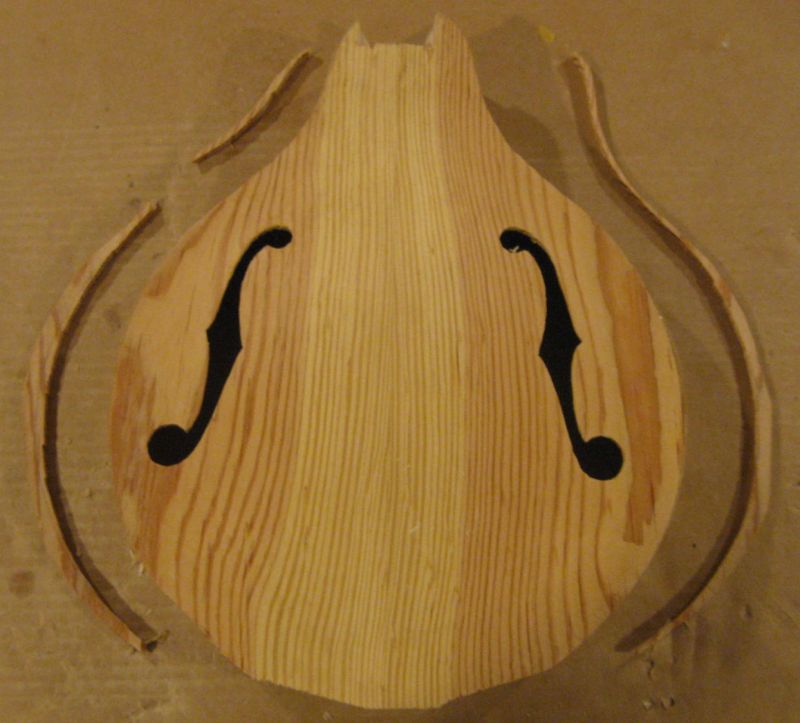

Jim. I'm both dismayed and relieved.
Relieved that I didn't make the body cutting mistake, and dismayed that you did.
I will be watching how you correct this one. If you have a sliver of the same wood, that might make more sense to me. But it may be hard to fit and glue it.
But too thick a binding might make the body look a bit clunky also.
Perhaps some purfling? Is that the right term?
Decisions......
Decisions......

I had the same worries thick binding. Purfling could be an option, but I don’t happen to have any, and it is not easy to make on short notice. However, being forever behind cleaning up anything, I checked by the bandsaw and found I still have the exact cutoffs from this top, minus a saw kerf. They fit fairly well as is, but need to be cleaned up carefully with a sharp knife. The match line will be fairly clean, but the repair will not be quite invisible. I still think this is the best way to go. I hope that when bordered with a dark binding, it may not be so visually obvious. If this had been a close-grained, uniform spruce top, it would have been much easier to slice off a straight chunk on the side and glue on a nearly identical piece. Ah, the joys of using unique wood!

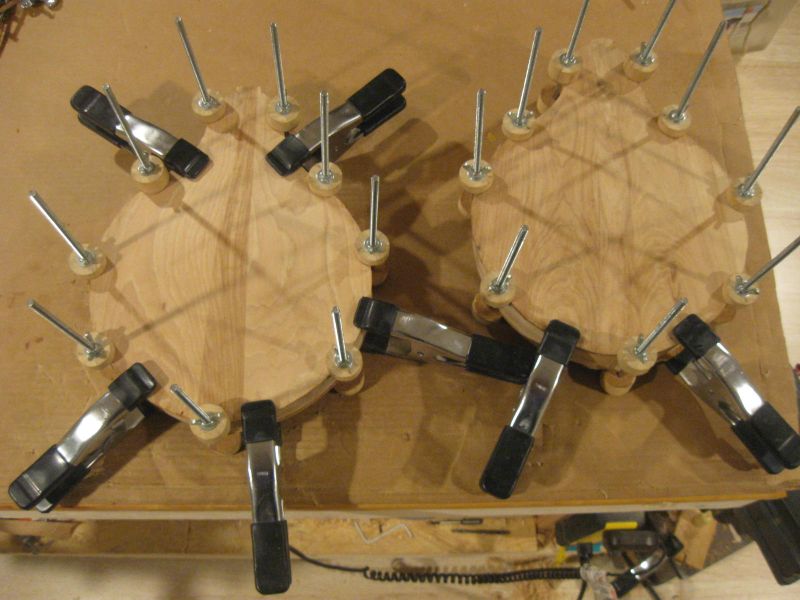

Life keeps getting in the way! At least I got the backs glued on today. I put small brads in the neck and tail blocks (works much better than staples!) to quickly get the backs and ribs aligned. Before starting to glue, I adjusted all my spool clamps to be only a couple mm bigger than the assembled thickness, which means I can put them on, spin the wingnut 2 or 3 times, and they are tight. I heated the backs and ribs as usual with a small hairdryer until they were noticeably warm to the touch, then quickly put glue on the ribs and back and assembled. Because mandolins are not that thick, I was able to use my spring clamps very quickly to get a good tight fit between back and ribs, probably not 10 seconds for the whole mandolin. That gave me plenty of time to replace them one by one with the spool clamps. And since I had to split my spool clamps between two mandolins, the gave me some extra clamps as needed.
After drying over night, I will trim the backs to the sides, and repair the one top before binding. I have a few last-minute things to finish on the necks, and they will go on tomorrow, and the instruments will finally be whole.

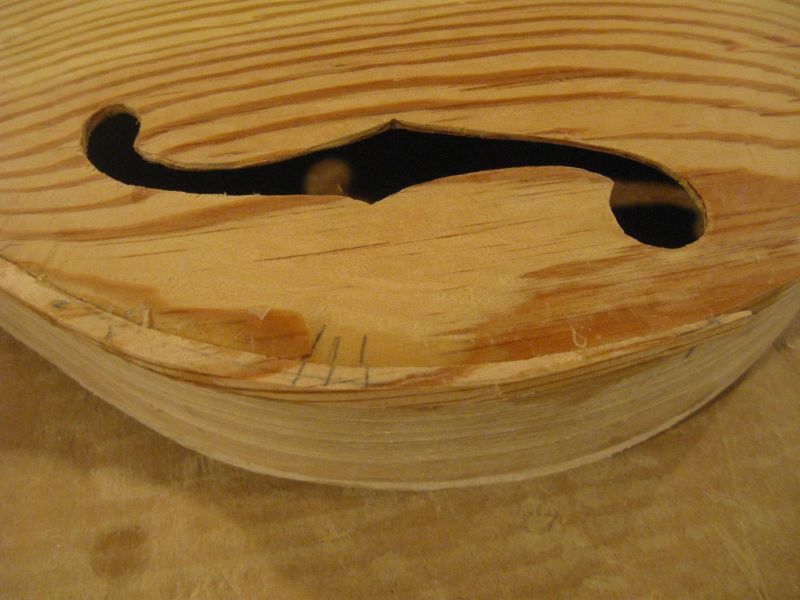

Back to the terrible error from a couple days ago. In too much haste, and marking out of the form, I cut too much off the sides of one of the tops, leaving too much room for the binding to fill. I had thankfully found the cutoffs next to the bandsaw.
It took a couple hours, but I cleaned up the sides and the cutoffs with an X-acto knife, plane, and sandpaper until it fit as well as I am capable of fitting it. I marked the right side with a double line across the top and cutoff, and the left side with a triple line, so that I could quickly and repeatably get back to the proper alignment. A little hot hide glue and a lot of tape held the cutoffs tightly in place to dry.
When the tape finally came off, it was better than I thought.
After cleaning up the edges and scraping over the gap to make the top and cutoff exactly the same height, I have trouble seeing the splice from over a foot away. As long as the patches don’t blow out when I route the binding ledge, this should work just fine. Just to be sure, I think I will pre-cut the ledge with a gramil before I get out the Dremel.

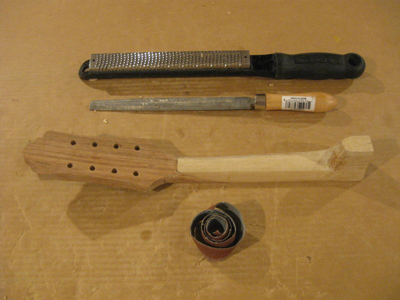

I also didn’t mention much about carving the necks. When I was just starting out, this was the most intimidating part of the whole building process, as other newbies have said here. But after only one neck, I was a convert and now agree with most experienced builders that it is one of the more enjoyable parts of the build.
A sculptor friend once told me that scuplting was easy – just remove all the material that is not part of the final sculpture. I can’t even draw a face. Don’t try to ask me to take away all the parts that are not a 3D face, but for some reason necks are easy. Just slide your hand up and down the neck and it will be immediately obvious what parts still need to come off. I used no templates on these two necks, and they are remarkable similar and they feel just about the same to me.
My main tool for carving is a microplane rasp. This one is mostly flat with curved corners, but I have an arched blade for it that I have not seen in a while. Each “tooth” is a miniature plane. They can hog a lot of material off quickly, but are really quite controllable. A bastard file (half flat, half curved) is necessary for carving the heel. The strip of sandpaper comes in handy for sanding the curved surfaces – clamp the neck down, hold one end in each hand, and saw away. And I can’t believe I completely forgot to include my most indispensable tool, a scraper. I invested in one of Al Carruth’s Ultimate Scrapers (the big oval one), and it was some of the best tool money I have ever spent! I use it constantly.

Brent, you would have to bring that up! Of course that is another major goof. Not having used this kind of neck joint before, I got confused about the order of operations. I am used to binding before putting in the necks, so that is how I was proceeding. I should point out that is still possible to pin from the top, even though that is not the normal way to do it. The effect will be the same, it will just be rude shock if anyone tries to disassemble it in the future. However, both owners will have a build log full of pictures, so that should not be an issue.
I am also considering pinning using long wood screws from the top. The screw threads will keep them from rattling at all, the joint will be easy to disassemble after removing the fretboard, and the pinning effect between the neck and block will be exactly the same.

Hmmmm, yeah, the pins had to go in before the backs went on....
Pins --can-- go in from the top of the neck, as long as the fretboards aren't glued. Find the angle that will see the p9n intersect both the heel and the neck block for at least the bottom 3/4" or so. If the neck pocket fit is good, and the heel fits tightly to the back, you don't need full contact of the pins. Just enough at the bottom to prevent the heel from rotating...

Another option, I suppose, is to get a long 1/8" drill bit, and drill the heel and neck block from the strap button hole, then added a screw. HAve the screw already in the neck block, apply hot hide, and snug it up with the screw.
That said, I'd rather see you pin it from above.

Mario or Brent, since the neck hasn't been glued yet and you have done this before, how do you determine the proper neck angle? Siminoff's book shows him using a production jig (that I don't have) where everything is worked out ahead of time. I was thinking that a straightedge laid on the fretboard should just touch the adjustable bridge at its lowest setting, so there is room for adjustment. Is there a better way to do it?
- Posts: 821
Re: Jim McConkey's Flood Mandolin Twins
If you do it that way you'll have the saddle cranked up way high...
Remember to account for the fret height also. Shims taped to the fretboard will suffice. Better yet, install the frets. Now lay your straight edge on it and set the neck angle to roughly 1/32" to 1/16" below the saddle.
The string height will be roughly 1/16" at the 12th fret, which means that if you set the angle to the top of the saddle, you'll be raising the saddle at least 1/8". Yes, that's okay, but if your top is nice and lively and goes down a bit when strung, you're now looking at raising it even further. And it's perhaps just me, but I prefer lower bridge/saddles on mandolins.
