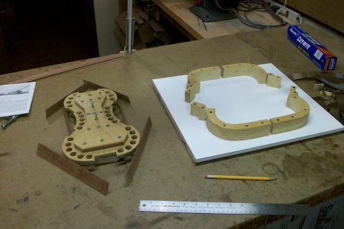

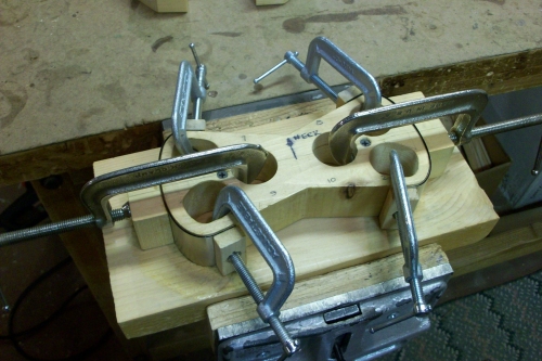

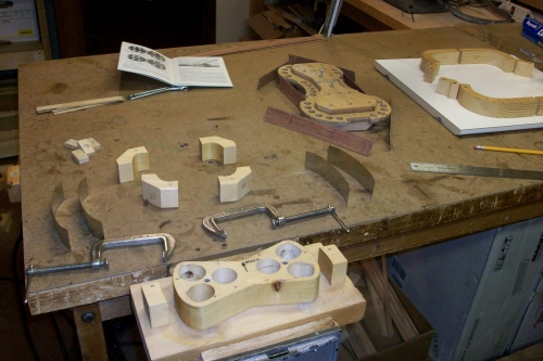

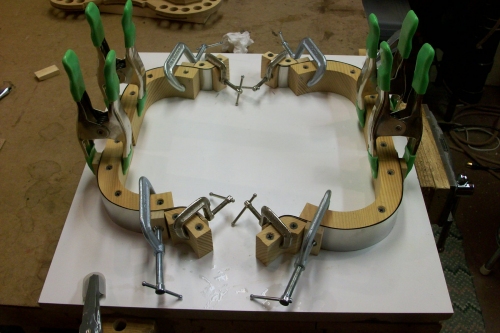

Re: Violin rib thickness....why?
Here's a thread on the subject in the Library. (Charlie --- the link to the original post by CT doesn't work).
http://www.mimf.com/library/Cold_bendin ... -2011.html
Basically, cold bending is gradually bending the wet wood, cold, around a form, then letting it dry. Once dry, it will come off the form and retain it's shape.
What I do is to swish the wood around in distilled water for about a minute, then sandwich it between two stainless steel straps. Clamp the middle, then slowly --- every maybe 5 or ten minutes, walk the clamp around, sometime spraying with water to keep it wet. Let dry for several days or a week. Remove from form. Drying could be quicker if put in the sun, or slightly heated.
