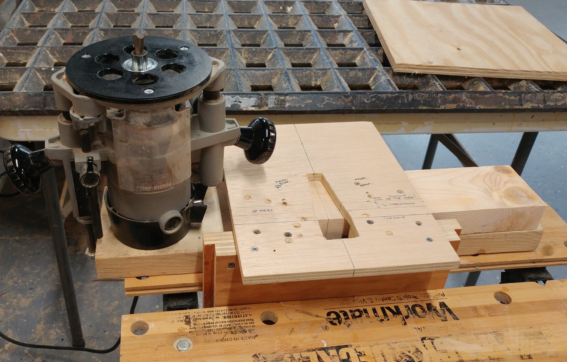

We could reconfigure the dovetail mortis fixture from the archtop builds for the deeper dobro body by moving around the front plate supports and making wood shims to align the body in the fixture. Here we are setting up the fixture and router to make some test cuts into some more scrap lumber.
The router is a standard plunge router, set up with 3/4" dovetail bit and a guide collar. I set this up with the prior archtop builds and haven't changed the bit height since. Haven't needed the plunge router for any other projects and have another PC router I use for everything else.

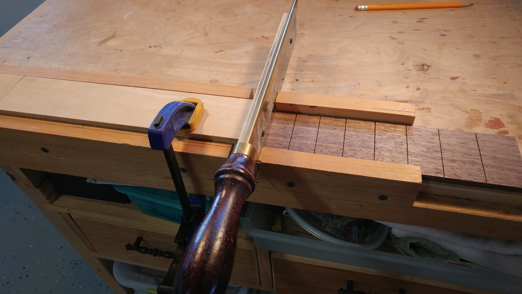

The fretboard is 0.300" thick walnut (a little thicker than the typical 0.250" thick fretboards). The scale length is 25", the same scale length we used for the archtop guitars.
Here we are laying out the fret positions. Measured with a 6" dial caliper and struck across with a knife and square. When we get past 6" from the nut, we clamp on a 6" rule and measure from there, then a 12" further on down the fretboard.
Here is the fixture for cutting slots, created when building archtop guitars. The saw has a block attached to control the depth of cut, and the fixture keeps everything square.

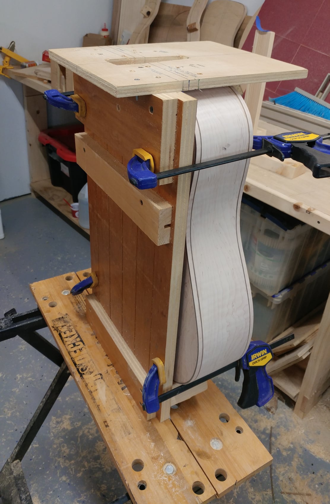

Body clamped in the dovetail mortis fixture. This is really nerve wracking - mess up here and it is really hard to fix!
Success. The dovetail mortis came out really good.

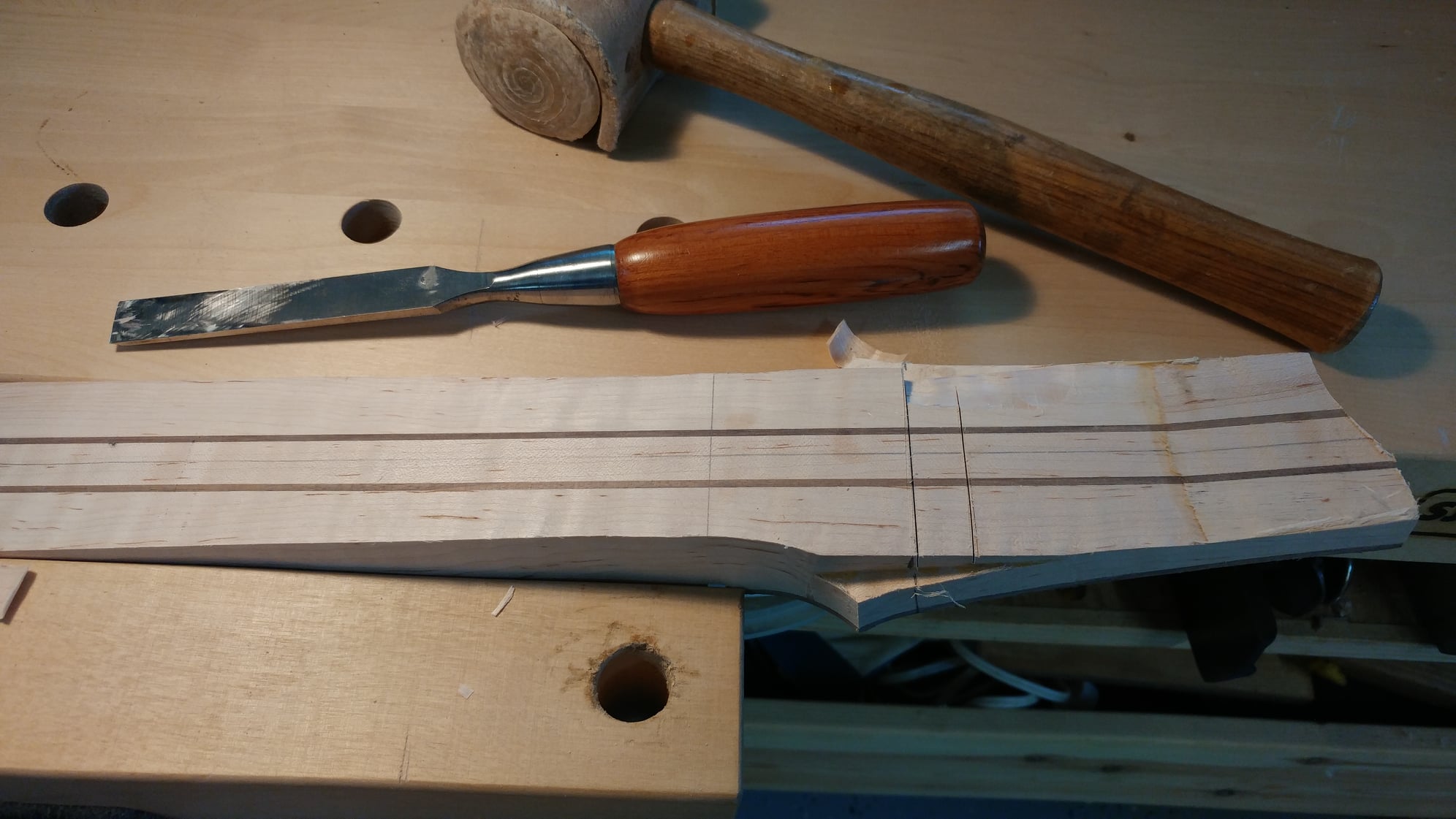

Post by Mike Conner »
Rough shaping the neck width and the headstock shape.
We used two-way adjustable truss rods in the 8 previous guitar builds. The 5 layer lamination of the necks, combined with 0.300" thick fretboards, are really stable and strong. In each case the necks have remained straight and true under string tension, and the truss rods are just snugged to keep them from vibrating. Based on this experience, we don't think the thick dobro neck will need extra reinforcement.
Carving away some extra material at the back of the headstock.The finished headstock, with the walnut headplate, needs to be 0.600" thick for the Gotoh tuners.
