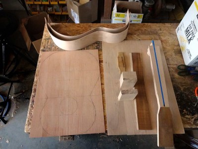

Here are the materials I have on hand. The body outline I traced from a Mexican classical I have, though it's going to be a 14 fret steel string. I still had to modify it a bit to make it fit on the wood.

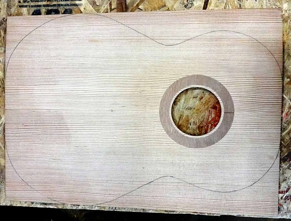

I decided on the simplest possible rosette - a single circle of lacewood.
First, the recess.
Initially I made the grain in the same direction as the top.
Then I decided it would give more strength to the top (it needs all it can get without bracing) to go across the top grain. I still have to thin it down and glue it in.

The rosette, such as it is, done. The finish should bring out some contrast.

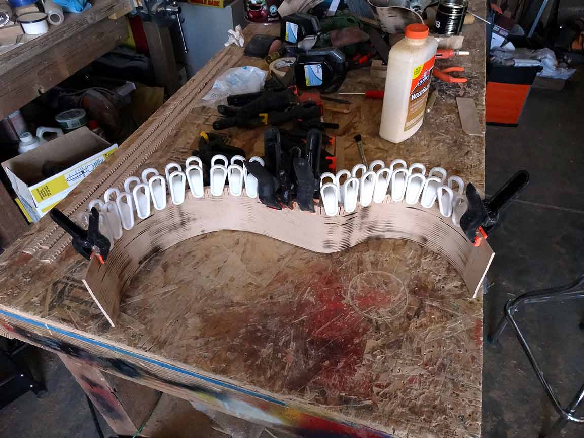

Glued on the linings and glued the sides to the soundboard. The linear scorches are from my bending "pipe", made from ribbed dog food cans.

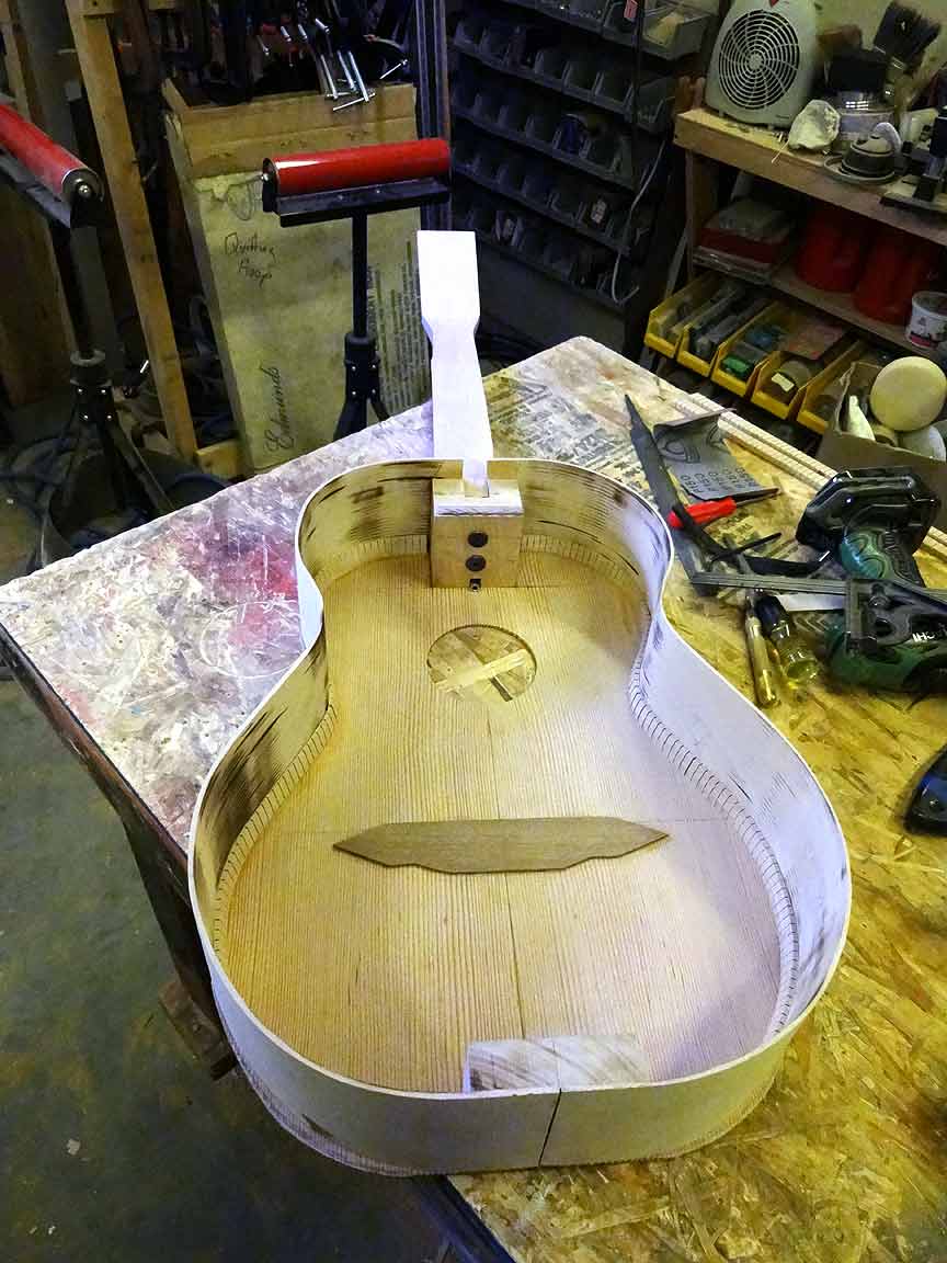

Views from the top and the backside. The fretboard and bridge aren't finished - just laid on for looks. I extended the bridge plate laterally - the only planned brace along with the bridge - to try to prevent the fir top from splitting. I'll put some diamond patches along the center seam.

If I may ask, what strings are you planning to use? Only they could influence the tension on the bridge, which may pull up the top behind the bridge.

12's, probably 80/20 bronze. I got 30 sets for $30 some years ago and still have some left. I could use silk and steel for lower tension if needed. I am going to have some struts from the bridge to try to avoid it tipping forward and doming the top toward the tail - that is the purpose of building this. We'll see.

Struts should work, planned properly I think. I know I've used struts, or spars in mine. Being a bit of a cheapskate I went to a boot sale and bought a biggish pop up tent with carbon fibre poles for £4 , about $3.50. They work a treat in compression over short lengths. The six string I'm building has a strengthening strut running from neck block to tail block made from an old aluminium arrow. I look forward to seing more.

Peter Wilcox wrote:12's, probably 80/20 bronze.
:shock: Err, how thick did you say you left the top?
Posts: 1327
Re: Acoustic steel string guitar
Just under 1/8" - probably more like 7/64 or 0.11.

Oops - that's the side thickness. The back is 1/8", and the top is .135" +/- a few thousandths. I thought I'd make it a little thick to start with, since it won't be braced in the usual sense. I can sand it thinner, especially toward the edges, if necessary.
