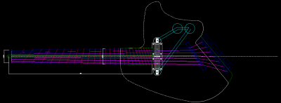

I want to make a 7 string guitar tuned in fifths:
C (one step above a low B)-G-D-A-E-B-F# (two steps above high e of a guitar).
I roughly based the design on a Klein headless guitar ( and after that found out that this was already done http://www.thegearpage.net/board/showth ... p?t=686151 )
Scalelength: 760 - 660 mm (approx. 30" - 26")
Stringspacing: Nut 6mm, bridge 10 mm
Two pickups: one for the bassside (C-G-D) and one for the trebleside (A-E-B-F#)
The pickups are single loop Low Z pick ups made from basic electric wire with a current transformer.

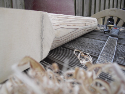

Made just a little progress: Glued up the neck and planed the taper.
I was planning to use my router for the neck, but we have a couple of birds breeding near our shed, so I used my plane instead to keep the noise down...
Hans
Hans

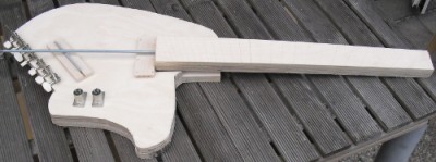

Quick mock up
I've made a quick mock up from what I have so far:
Body parts, neck, bridge and pickups.
Next up: Finishing the neck and installing the frets.
Hans
Hans

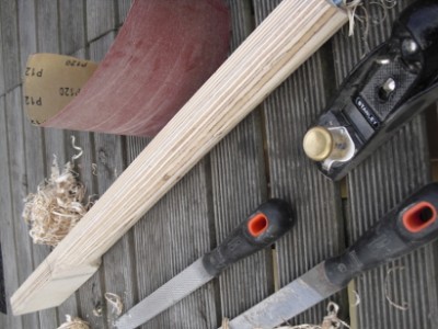

I've worked on the neck today.
I sawed the fretslots.
After that I shaped the neck by rasping the profile in the neck just before where the neck will enter the body. I then used a plane to shape the rest of the neck (an advantage of not having a headstock in the way).

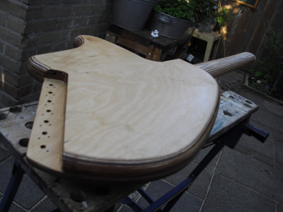

Finally I got to work on the guitar again.
I rounded the body with my router and I shaped my neck to it's final shape.
Next up:
- drilling the tuner holes in the body
- fretting the neck
Hans
Next up:
- fretting the neck
Hans

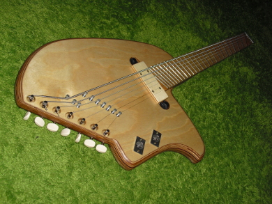

I've assembled the guitar.
Everything works fine and although there are a lot of things I want to do better next time, I'm happy with the outcome.
I will post some soundclips soon.
