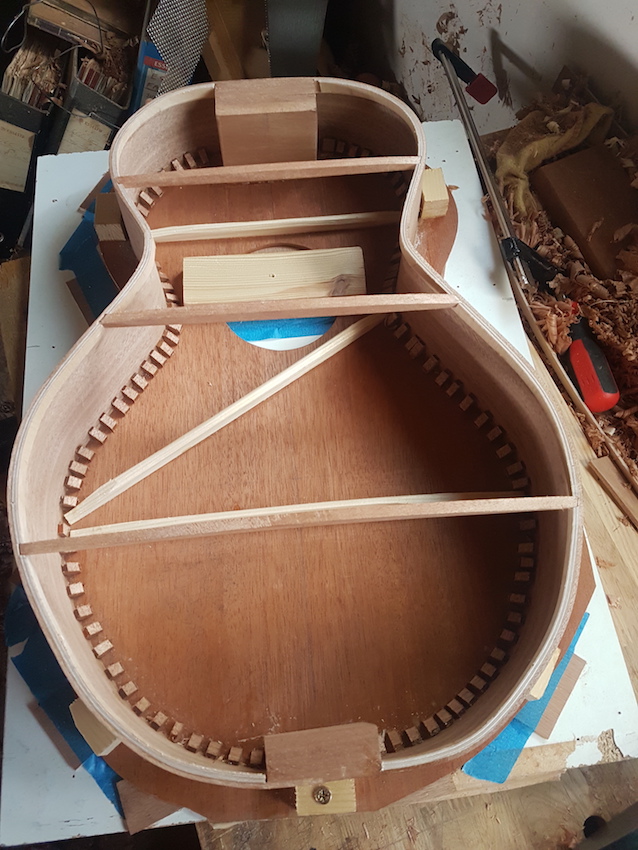

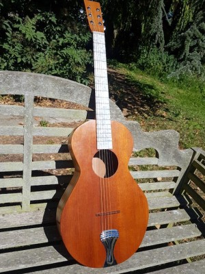

I finished this one a few months ago - all mahogany, ladder braced. I was trying to channel the 30s Stellas and Regals, thus the MoTS fretboard.
The top is around 2.3mm thick and was radiused just by shaping the bracing by eye - my guess is it's around a 10 ft radius. The bridge is 12 mm high. There is a fairly beefy brace (around 12 mm tall) directly under the bridge location which aims to stop the top collapsing.
It's short scale (24.5 inches) and fairly small bodied (12.5 inches lower bout) and strung with medium strings, so the overall tension is noticeably lighter than a dreadnaught.
It's very light and responsive, with lots of volume and plenty of sustain (a nice surprise as I had no idea how it would turn out!). So far there is no sign of the top sinking even slightly, though who knows how it will fare years down the line.
In terms of sound, it's very much a flat top rather than an arch top sound, which is what I'd hoped for. I'd guess that a thicker top would cut down on the sustain, if that's your aim. My reading suggested that it would be OK to trade off top thickness against bracing height, so that's what I did. All I can say is that it's working so far.

Calculating my archdukes it somewhere between a 6' and 8' radius, rather more than I'd guessed.
Am I right that floating bridge instruments experience less "folding up" stress because the tailpiece directs the string tension in line with the neck and sides, rather than via a fixed bridge which wants to rotate into the soundhole?

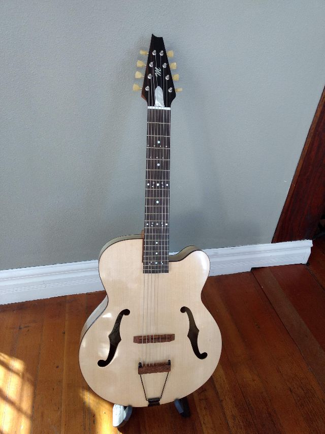

Chuck, I had a request from a friend to build him "an acoustic that looks like an ES-175". I took a wild stab with a Lutz spruce top 0.125 thick and a simple X brace. I put a small bridge patch and UTB in looking for some cross grain bracing. Top was domed 16 foot. Parts looked like this
Guitar has f-holes, archtop style floating bridge and tailpiece. I didn't measure the break over angle but you can get some idea from this
And for what it is worth I had to put a small wedge under the fretboard to get the right neck geometry. The guitar does have a couple of quirks that suits the owner.
I would characterize the sound as "arch toppy" - quick attack and decay, more fundamental that complex.

Freeman, that looks cool! With the 16' radius, do the ribs look super thick at the waist (and cutaway) compared to the lower bout?

Not particularly. 16 foot is my normal back radius, I just arched the braces in the radius dish and clamped in the dish, I would think that at the edges some of that radius relaxed (but it certainly does not have a recurve)Bryan Bear wrote:Freeman, that looks cool! With the 16' radius, do the ribs look super thick at the waist (and cutaway) compared to the lower bout?
I've always felt that some of the sound of an archtop comes from the use of a floating bridge and tailpiece. That completely changes the way the top vibrates - you have that direct perpendicular component and almost no rocking. The only anecdotal evidence is a brief discussion with Todd Cambio who builds 1930's style ladder braced guitars with both pinned bridges and tailpieces. I asked him what he thought the difference was and he said it was subtle but the pinned bridges seemed to have more overtones, were "complexer" sounding while the tailpiece instruments seemed to have more of the fundamental frequency. I think Roger Siminoff discusses this in his book on voicing tops but its been a long time since I read it.Chuck Morrison wrote: I've often wondered if the use of F holes is more important in forming that sound. It does change the shape of the main vibrating mass quite a bit compared to a round or oval hole design.
My friend insisted that he did not want a pickup in this guitar but since I really had no idea of what it was going to sound like, at the last minute I hedged my bet and installed a sound board transducer before the back went on (I figured that if I waited to find out what it sounded like there was no way to change). Anyway, I put the jack inside with a piece of string to pull it thru the hole after the guitar was finished. I plugged it in a couple of times, actually sounded pretty good, but I doubt that my friend ever has.

Gaudy but tasteful was my aim for the fingerboard!Chuck Morrison wrote:Nice work Chris, I wouldn't have picked up on the MoTS fretboard if you hadn't mentioned it. A quick question if you don't mind... Did you extend the arch in both directions (like a section of a sphere) or just side to side (like a Prairie State/Larson) ? It sounds like your arch is a bit more than mine (which I thought extreme). 2.3mm is as thin as i've ever gone with a top, but I've seen lots of thin tops and made my fair share of them.
I've never done an arch that was just side to side, maybe after 44 years it's time to try one.

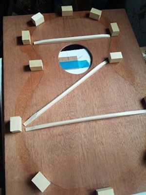

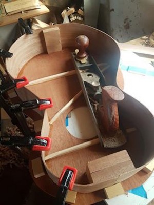

My design was pretty much made up as I went along. I've never built the same thing twice, so much of my building consists of standing and looking at where I'm at, then sucking air dubiously through my teeth.
For the top, I knew I wanted a side to side arch to resist the downforce on the bridge. But I also wanted a reasonably flat upper bout to make attaching the fretboard easier. So what I did was to construct a primitive solera, taking a baseboard and attaching 6mm MDF at the upper bout and all around the edges. This gave me an arch height of 6 mm across the middle of the lower bout, so I shaped the brace under the bridge to that. The diagonal brace was shaped by taping sandpaper inside the lower bout, clamped down with a small block at the centre of the lower bout, and then sanding it to the shape the wood wanted to go.
So, effectively, I have a 6mm dome on the lower bout, both side to side and front to back. The body was built up from the top (face down on my improvised solera), then sides, and finally back. The back was heavily arched both fore and aft and side to side.
The hard part was keeping the sides vertical, as I was building freehand without a mould. Clamps/props/wedges etc kept them reasonably vertical as they were glued to the top, and then the bracing across the top held them in place while I glued the back on. I used HHG for the body glue up, so I could glue in sections and straighten up as I went.
There are quite distinct irregularities, but I've hidden them as much as I could! And its owner, my best friend and singing partner, really loves the guitar, so I guess I did OK.
A few pictures of construction in case they help:
