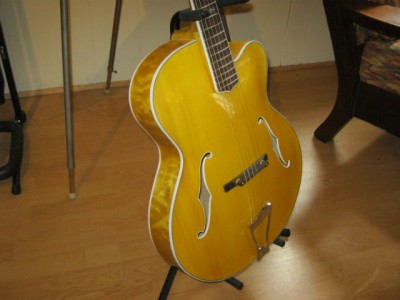

My two 2017/18 guitars have been finished for a month or two now. I built a traditional cut-away archtop, and one based on my "Moderne" asymetrical cutaway shape.
"Traditional" is spruce over quilted maple, parallel braced, bound F-holes and 4 layer binding on top and back. First time for me doing block MOP inlays on fretboard, doing the triple bound rosewood fretboard and headstock, and the venetian cutaway. Finish is amber tinted EM6000, around a dozen coats. Tone is bright and transparent, a little mid-range chomp - about what you expect from an archtop.

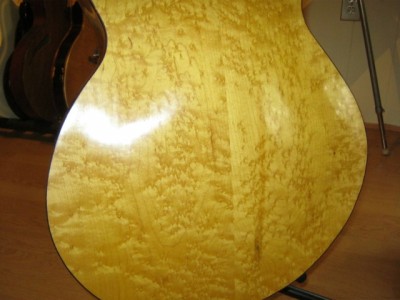

Meant to post the back of the traditional archtop, lovely quilted maple.
