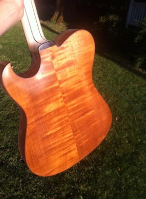

Full hollow 14" archtop.
Engelmann spruce top, Spanish cedar back and sides, maple and African blackwood neck, bloodwood fingerboard, custom wooden pickup rings, knobs, bridge, and lots of binding.
Pickups are a '59 in the neck with series/parallel switch, Twangbucker in the bridge, and a K&K twinspot under the bridge.
25.5" scale, 1-11/16" nut, jumbo stainless frets, and Hipshot tuners.

Turquoise dots and banjo-inspired star inlay.

A few more quick shots.
