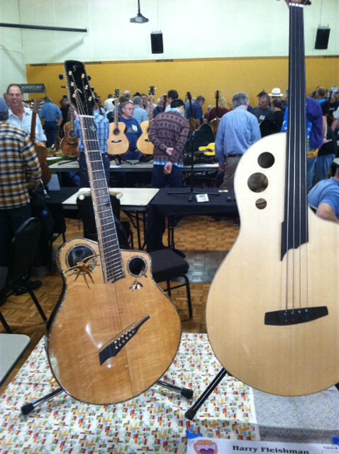

At this year's GAL conference, Harry Fleishman had a huge acoustic bass guitar that was really a sight to behold. I got a picture of it, but I'll have to go find it and reduce it for posting here. It was a very large instrument, with an arched back and extended upper bass-side bout with soundholes. It was still in the works, and I didn't hear it played, but it sure looked like it had potential to thump.

Hey, Beate, here is that picture from the the GAL Convention of Harry Fleishman's latest take on the acoustic bass guitar. This thing was massive, as can be seen in comparison with the fairly standard sized guitar to the left. The back, if I remember correctly, was arched with large staves, not unlike the guitarron.
