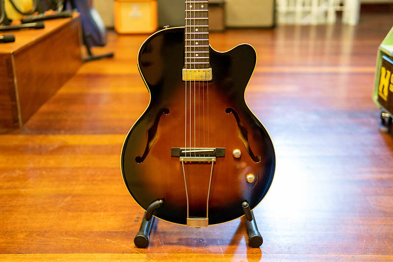

Yamaha AEX 500
Yamaha AEX 500
Freeman, I have found my solution, see attached photo of Yamaha AEX 500. This is a flat top, yet has the aesthetics of the archtop models I had been inspired by. It is thin body with bolt on neck. Has piezo under the saddle and neck humbucker, and a means to blend both pickups. I'll omit the piezo and just go with a P90 at neck position. I might exclude the cut away. If I do go cutaway it will be florentine. Thanks again for your input, hope you didn't't think I was going to hound you with questions. Regards

Sounds good. I'll just make three brief comments, you probably are very aware of all of these.
First, work out you geometry very carefully. Have the bridge that you are going to use in your hands, lay out the amount that the top will be arched (it will not be totally flat), the neck angle, the overstand and any wedge under the fretboard extension. I've done a couple of write ups about how I approach geometry - it you would like I can send it to you.
The Yamaha has a very funky bridge/tailpiece which you will either have to duplicate or come up with something equivalent. I ran into something similar on a ES-225 that I worked on (it didn't have the piezo).
If you use a more conventional floating bridge and trapeze tailpiece you may not be able to get enough break angle with your flat top. (note that the 225 is another slim bodied guitar with a P90)
Third, consider your bracing and what you want it to do. You need to support the pickup somehow, You (probably) need some support more or less under the bridge. You need a way to connect the neck. If the body is deep enough that would be a dovetail but for a "slim hollow body" you might have to go to a M&T like Gibson uses. All of this comes back to the geometry question.
I guess there should be a fourth - show us some pictures when you do build it. And if there is anything I can do to help, let me know.

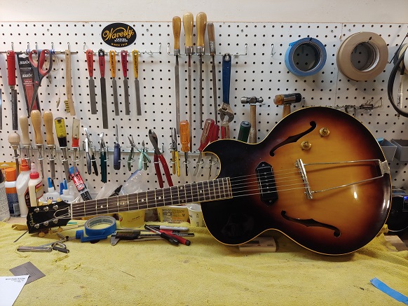

Graydon Stephens
Posts: 17
Joined: Thu Sep 17, 2020 10:34 am
Re: slim hollow body with P90
Post by Graydon Stephens »
Sorry for the poor quality pic, my file reducing app maybe isn't the best. Anyways, just wanted you know a built the guitar. Thin body, hollow, maple back, sides, soundboard, and neck. Ebony fretboard & headstock veneer, P90 pickup, bolt-on neck, rear access to pots/wiring. Thanks everyone.
