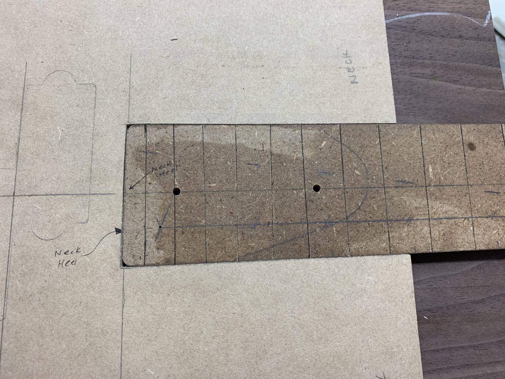

I can't answer your either/or question, but if you're making a neck, I just did a bass that had a taper at the heel (continuous straight lines from the nut to the heel) and used two templates to rout both the heel of the neck (actually the entire neck shaft) and the neck pocket. I got as close to a perfect fit as I could on both templates as shown in the first picture below, then used one to rout the neck profile and the other to rout the neck pocket. A tiny bit of fitting resulted in a perfect "piston fit". Note in the pics below the holes in the templates that are used with 1/8" stainless steel dowel pins to make sure everything lines up properly. If I was doing this with a purchased neck, I'd make a template to perfectly match the neck, then rout with that.

Thanks, guys. Now that I know it's a taper, if I ever make another one, I'll just make a tapered routing template. In hindsight, it makes a lot of sense. Easier to make a template and a thousand bodies than it would be to make a thousand necks not tapered. In the meantime, this body is shimmed and the neck fits. I'm making two more necks, probably as penance for buying the Warmoth neck in the first place, and it will be easy to taper them as well.
