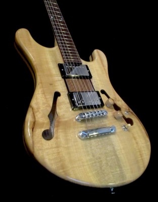

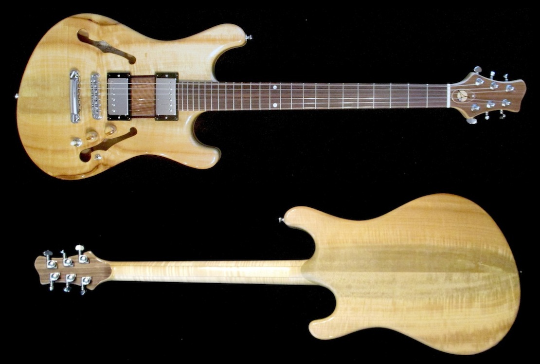

Specs:
Myrtlewood (Oregon) semi-hollow body with curly claro walnut "Equator" binding, f-holes trimmed with walnut veneer
3-piece curly maple set neck with walnut veneer between plys
24-fret, 25.5" scale rosewood fingerboard with maple/rosewood binding, MoP side markers and double at #12
3-ply (walnut, maple, walnut) headstock face overlay, single ply walnut rear overlay
Hand-turned Myrtle control knobs
Curly claro walnut graft with w/b/w/rosewood binding between pickup routs
Hand-made 4-ply Abbott House Guitars logo truss rod plate
Roadhouse TripleCrown humbucker pickups with nickel covers in black metal mounting rings
Master Volume and Tone controls with CTS pots
3-way selector switch, mini-toggle for neck position coil cut
1/4" output jack in a chrome oval plate
Gotoh stop tailpiece and tune-o-matic bridge in chrome
Grover midsize Rotomatic tuners in chrome
Bone nut
2-way truss rod by Allied Lutherie
Thanks for looking!

Good stuff! This is your "clamshell" design, yeah? I think you've got something going on here. The wood choices are particularly yummy on this unit.
Think you could shift the neck out and get a couple more frets clear of the body? It looks like that would work and keep everything in good functional and aesthetic relations.

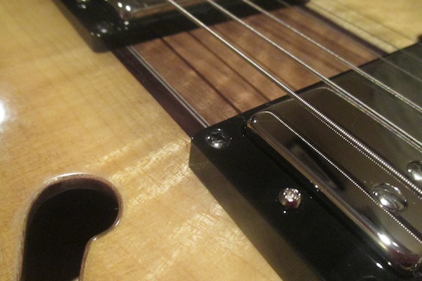

Re: Myrtlewood "Equator" Build by Chad McCormack
So, do tell! What happened that you needed the fancy cover-up plate between the pickups? I think it's just screaming for a third pickup!
I believe that's the neck tenonJason Rodgers wrote:So, do tell! What happened that you needed the fancy cover-up plate between the pickups? I think it's just screaming for a third pickup!
ah, just realised it's an inlay. Well looks great! I really like the fact that the centre of gravity is quite far back on this. To me that's a really desirable design trait for a guitar making the neck sit "closer" to you.
Ha! And here I am telling him to stick it out further! Guess we all have our aesthetic and functional points of view.John Catto wrote: I really like the fact that the centre of gravity is quite far back on this. To me that's a really desirable design trait for a guitar making the neck sit "closer" to you.
Thanks, Jason. I certainly could have moved the whole string assembly "out" from the guitar body by about the distance spanning the last 2 frets. I prefer to have the tune-o-matic bridge more or less in line with the cusps on the f-holes, and with the 25.5" scale it resulted in the bridge location being just a bit lower (towards the lower bout) than that preference.

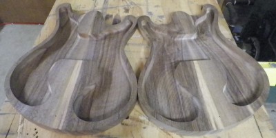

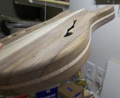

Peter is right. Here's the scoop on that, only from a different guitar:Peter Wilcox wrote:I think it's because of the walnut binding in an equatorial fashion around the body - not real clear from the pics.
1. The two body halves are prepared as mirror images of one another: 2. After glue up, I true up the sides relative to one another and then use a 1/4" tall rabbetting bit with a ball bearing that leaves 1/16" of cutter exposed to prepare the inlay channel: 3. I prepare 1/4" wide binding to be 1/16" thick, then steam bend it to install all the way 'round the "equator:" I start/stop at the lower bout strap button position and somewhere in the neck pocket region (which gets routed away anyway): 4. And finally flush-trim it on the router table, followed by my front and back round-overs:
Hi Jason. I cracked the top while "tapping" the bridge bushings in. After a few choice words, a thrown mallet and a day or two to cool down, I purchased a little (3" x 16" x 3/16") piece of nice curly claro walnut from my local Woodcraft and one piece of w/b/w/rosewood binding from StewMac to fashion a little something to lay in there. From now on, I'm pushing those bushings in with my drill press. Again, it was certainly an I-can't-believe-I-just-did-that kind of moment. Not one I'm proud of, but one that I've certainly learned from. Oh, and no 3rd pickup
