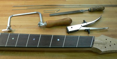

Fitted the frets. No ‘in progress’ photos but here they are installed with the tools I used to do it. By the way, they’re banjo frets. I thought that if Leland Sklar and Sheldon Dingwall like them combined with fanned frets, I might too. We shall see.
The zero fret is a jumbo one which automatically gives me a small amount of string clearance at the first fret.

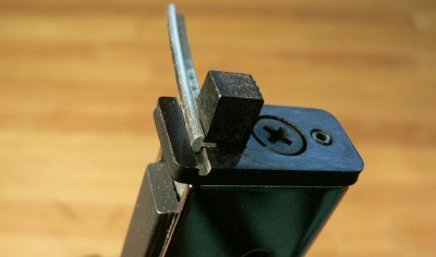

The tool on the right is a home-made tang nipper. It’s a modified sheet metal nibbler you can get for about $10 on Ebay.
http://www.atxpowersupplies.com/sheet-m ... bblers.php
You have to grind a slot in the top plate to accommodate the fret’s crown. You do this using a Dremel cut-off disc, like so.
Here it is in operation. It works perfectly, and although I have nothing against Stewmac (their service is exemplary), you can have five of these for the price of one from Stewmac.

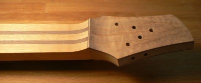

Now to shape the neck, starting with the curve of the volute on the makeshift spindle sander.
Here’s the result.

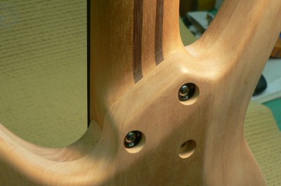

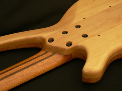

One of the last things to do on the body was to drill the hole for the jack socket and it’s a big scary hole drilled in an awkward place. What’s more, I couldn’t find a Forstner bit of the right diameter so I had to use spade bits. The way I did it was to build a fixture using the routing templates that I won’t need again (waste not, want not) that I could clamp to the drill press table like so.
I also shaped a caul to clamp inside the cavity to avoid break out as much as possible. Lowering that whopping spade bit was what I believe is called sphincter-clenching moment but it turned out OK.

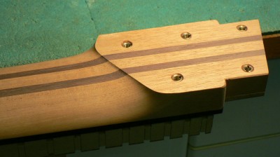

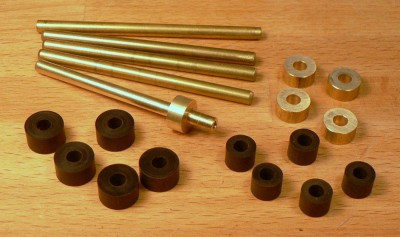

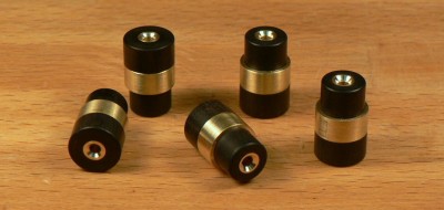

I now had to make a few odds and ends to finish off. First the ferrules for anchoring the strings up at the sharp end. I started out with some pieces of 5mm brass rod and cut off some short pieces of 12mm rod, 6mm long with a 5mm hole through them. I also made some similar ebony pieces. Here they all are.
I then slid the pieces with the holes in onto the 5mm rods and super-glued them all together! Not really engineering but this way was much easier than turning a solid brass core and the ebony pieces would still have been glued on.
I put them in the lathe and bored a 2.5mm hole through and then parted them off and chamfered each end of the hole.
I drilled and tapped a hole for a grub-screw in each one using a little wooden fixture as before.
Here they are all finished.

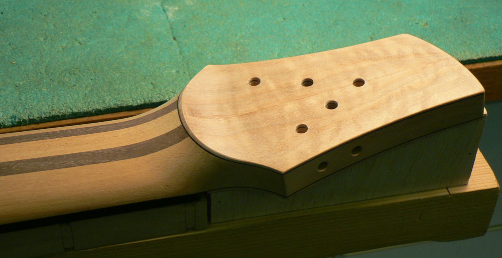

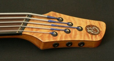

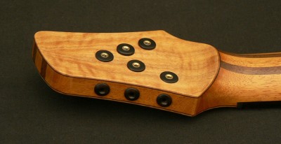

The next things I made on the lathe were these little ebony ‘grommets’ (don’t know what else to call them). They are glued in the holes in the headstock where the Allen key is inserted to lock the strings. I just think it looks nicer than bare holes in the headstock and may avoid the edge of the hole being chewed up when changing strings.

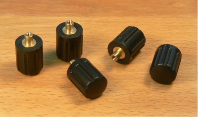

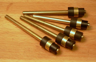

However, I got to thinking it might be nice if the tuning knobs matched the control knobs and they’d also be much lighter than those brass ones so I made some more, but I didn’t put the maple inlay in these.

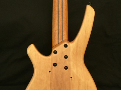

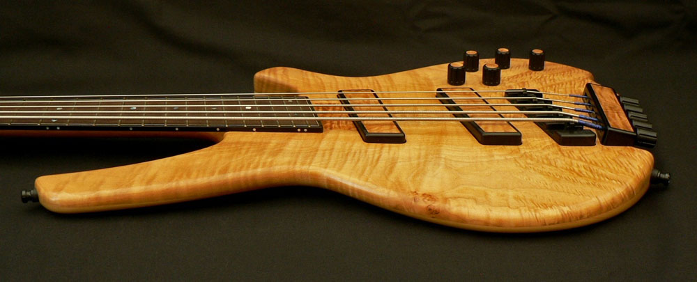

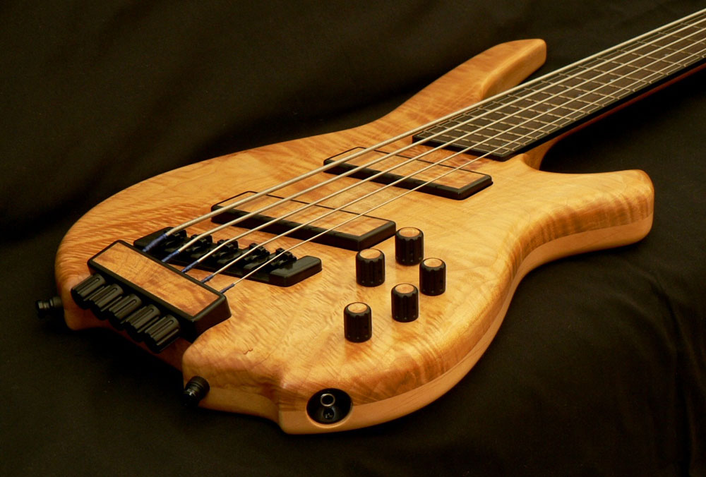

So here at the end of the marathon are the glamour shots. Hope you think it was worth it, and (if you have been) thanks for looking.
Full frontal.
Closer up.
