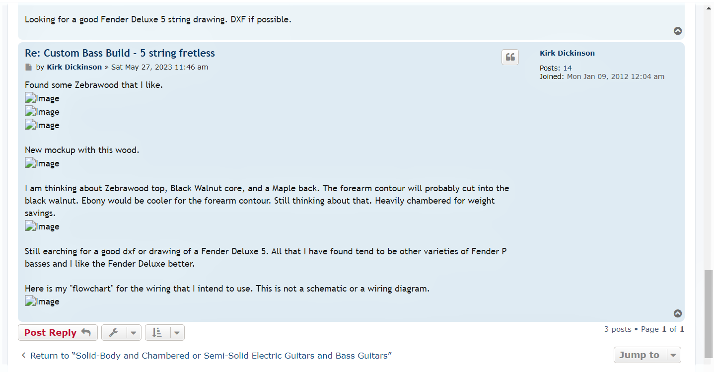

Found some Zebrawood that I like.
New mockup with this wood.
I am thinking about Zebrawood top, Black Walnut core, and a Maple back. The forearm contour will probably cut into the black walnut. Ebony would be cooler for the forearm contour. Still thinking about that. Heavily chambered for weight savings.
Still earching for a good dxf or drawing of a Fender Deluxe 5. All that I have found tend to be other varieties of Fender P basses and I like the Fender Deluxe better.
Here is my "flowchart" for the wiring that I intend to use. This is not a schematic or a wiring diagram.

The images aren't visible to me.

Not sure why you can't see it? They are links to photos on my website. Maybe your browser is blocking the site because it doesn't have a security certificate?
I uploaded them to a temp site that I manage that has an SSL. See if these work.
