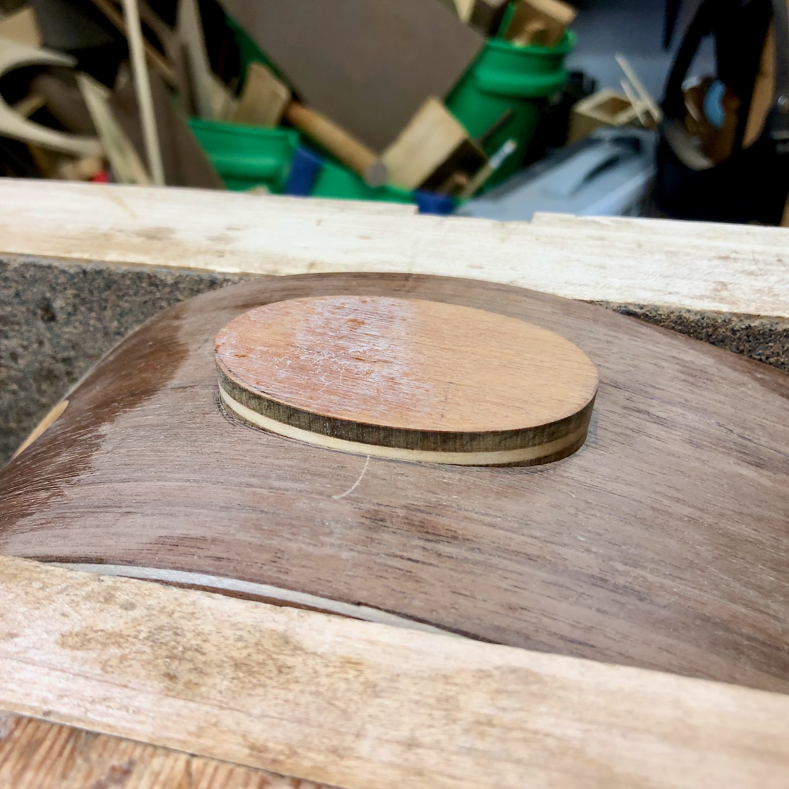

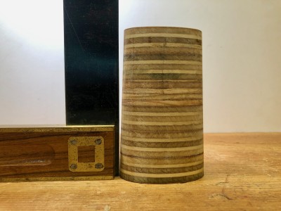

It's starts with this form I made. It's 6 layers of 3/4" plywood that is a tapered ellipse. I don't know what the mathematical name for it would be. Elliptical cone maybe?
It has about a 2º taper. I did the taper and shaping on my disk sander.
Then I trace the ellipse on the side. The pencil line doesn't need to be precise at this point.

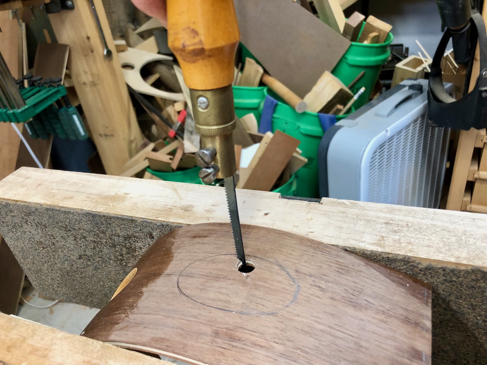

Next is drilling a hole and cutting out the ellipse well within the line.

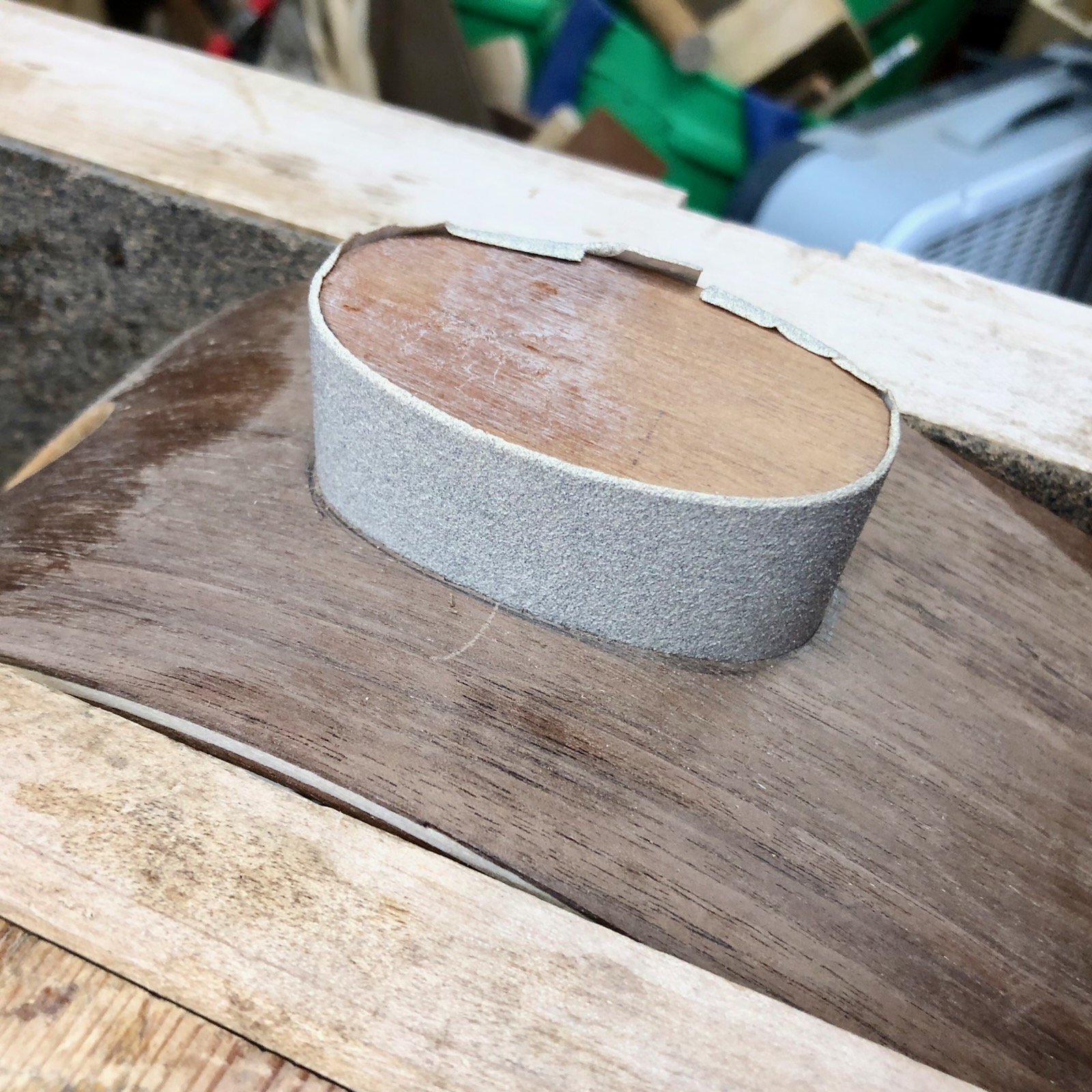

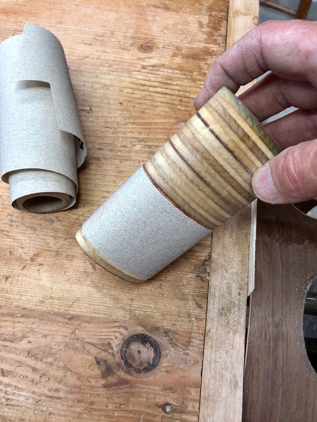

Once I have the hole I will use a file to shape it a little.
I shape it with a file until the form fits into the hole to about here.

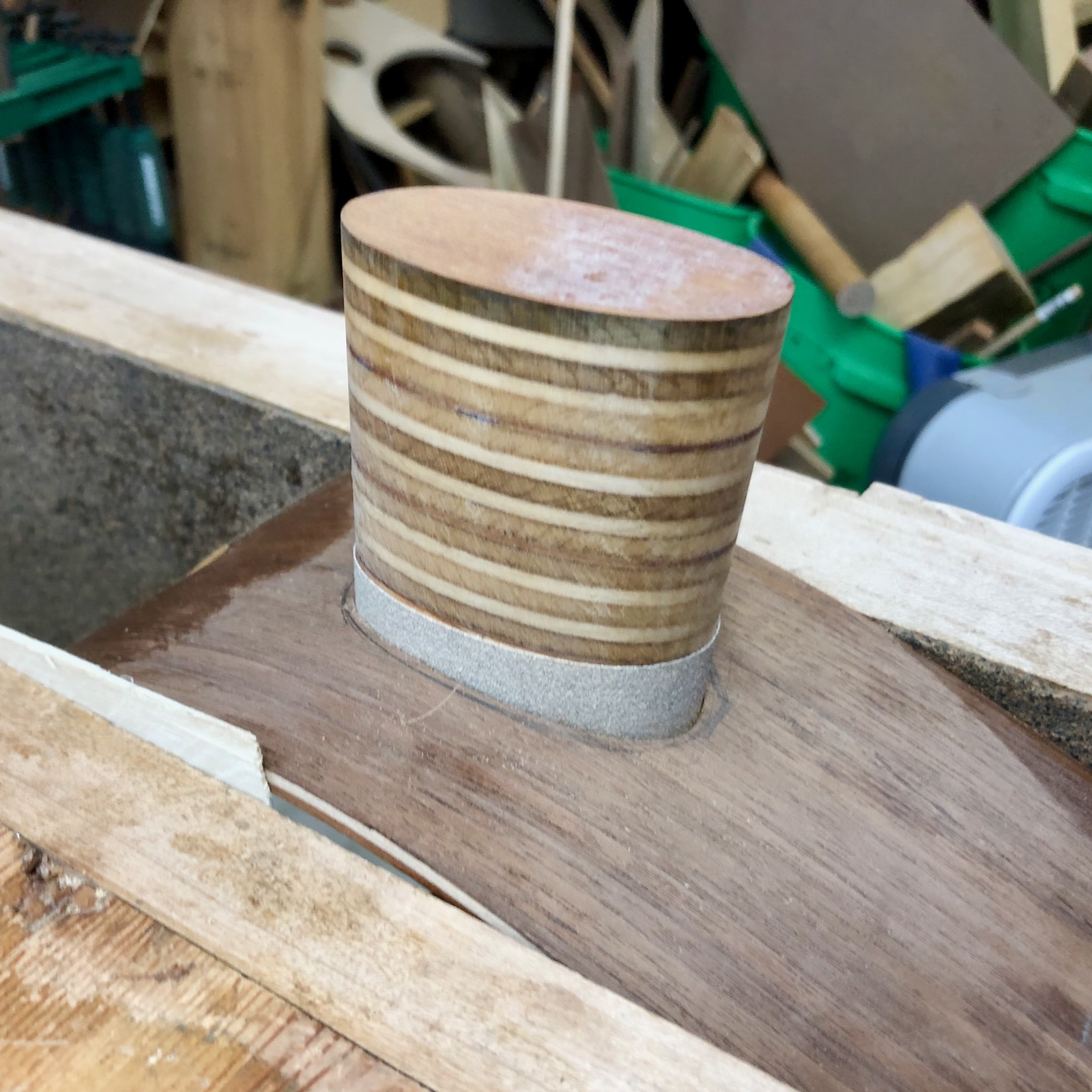

Then I put self-adhesive sandpaper on the form.
Here I'm starting to use the form to shape the hole. It's like a perfectly shaped rasp.
As I work the sandpaper on the hole the form fits farther into the hole. I move the sandpaper and keep shaping.
(Continued)

I keep shaping the hole all around until the form fits like this without the sandpaper.
I now have a very nicely shaped elliptical hole with smooth sides that are tapered to match the form.

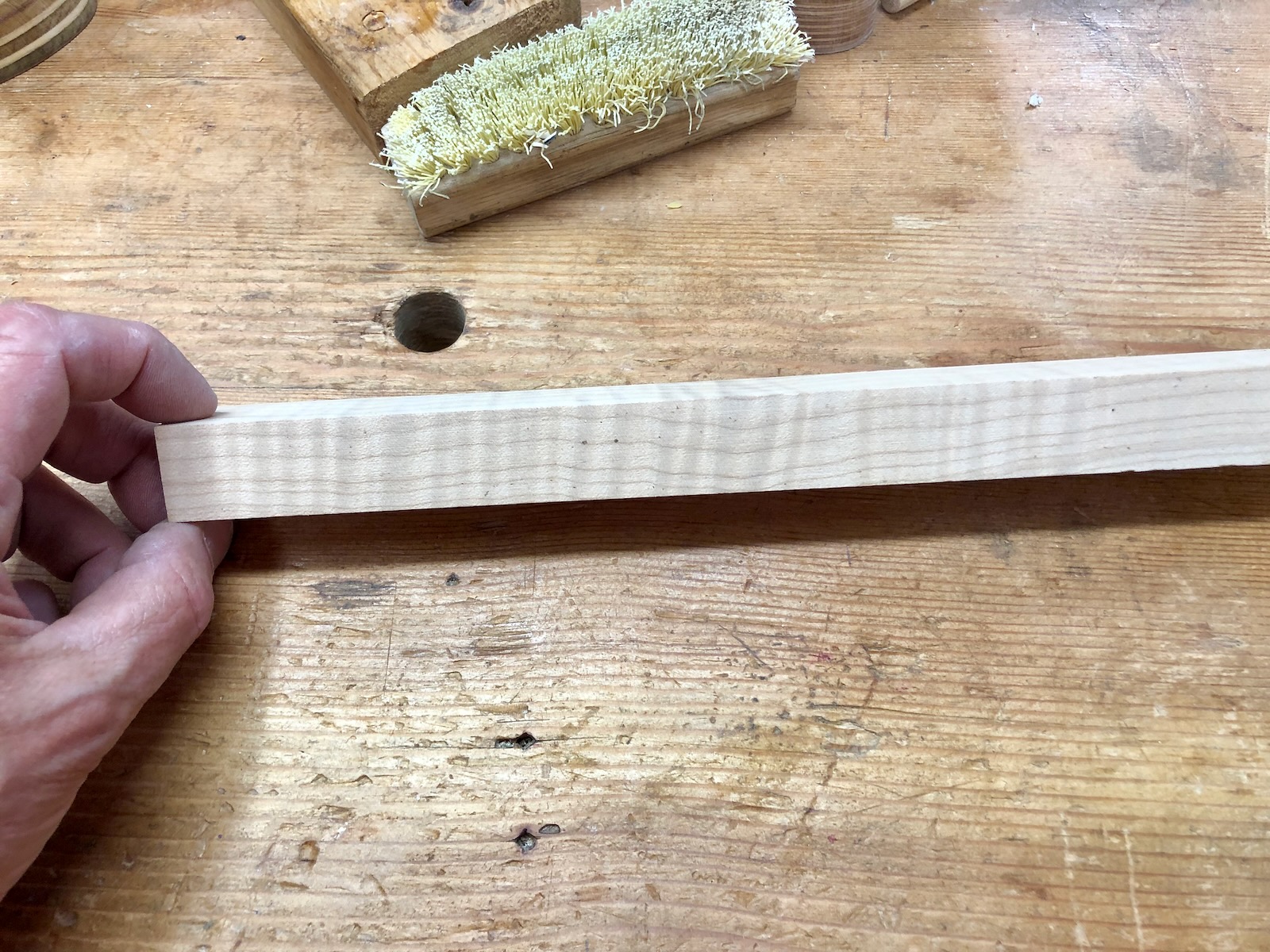

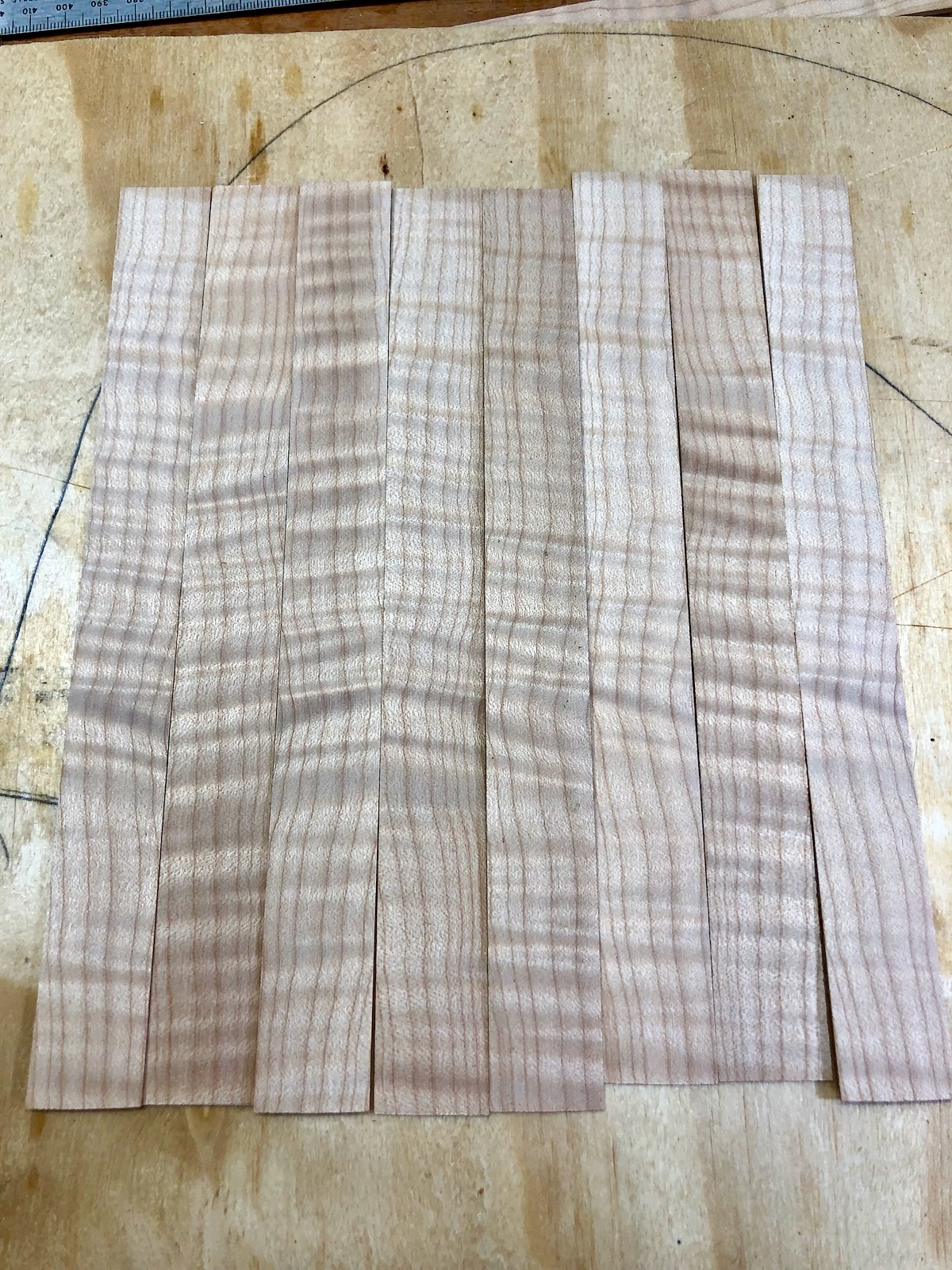

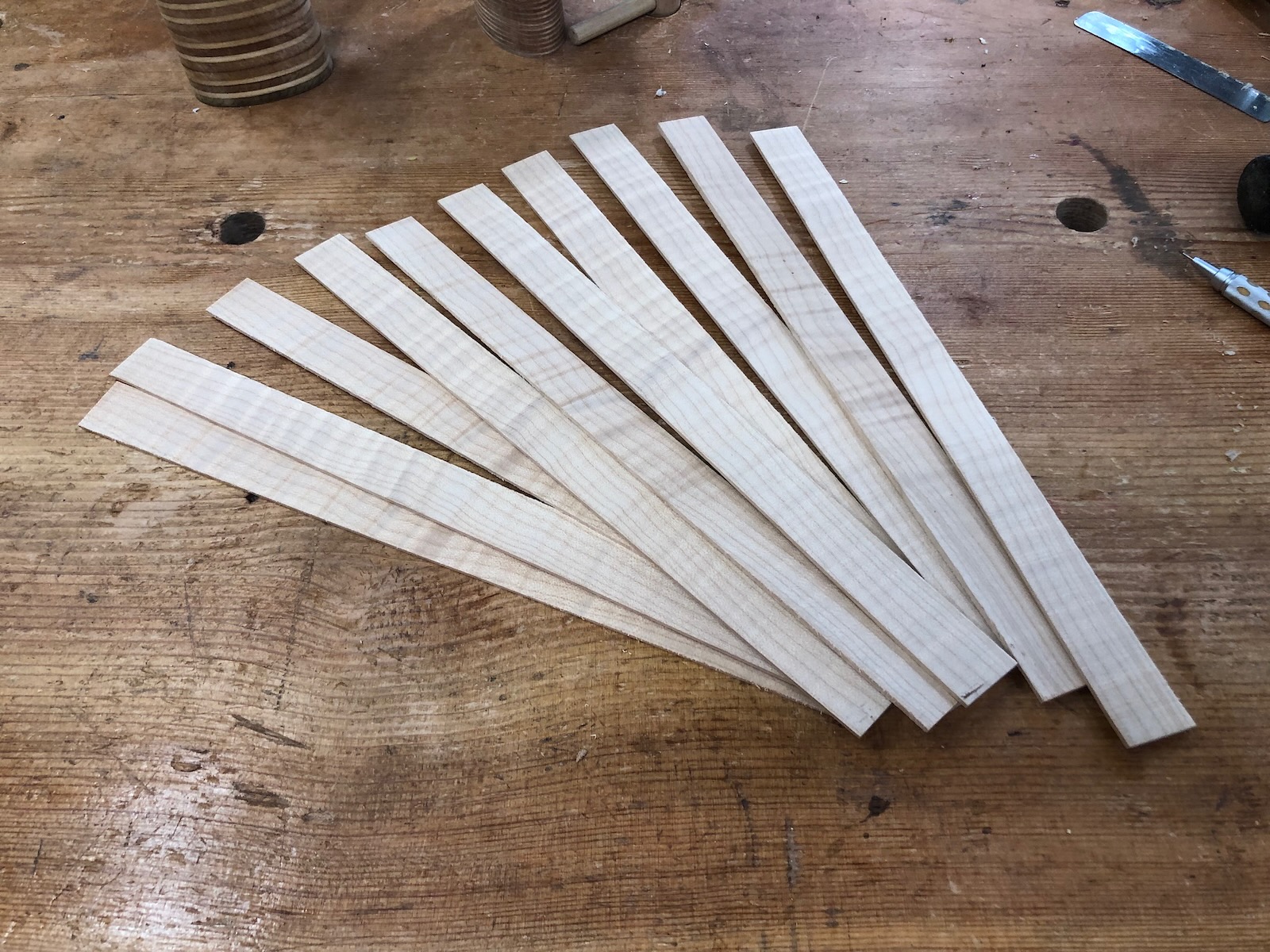

Now that the port is ready for binding I'll start making that. For these trials I started with a nice piece of curly maple from my stack.
I cut thin strips on the bandsaw. I believe that sawn veneer bends better than sliced. There are no micro-cracks from a slicing process. I cut the strips to about 1.5 mm (0.060").
I got a nice set of pieces from this stick.
(Continues)

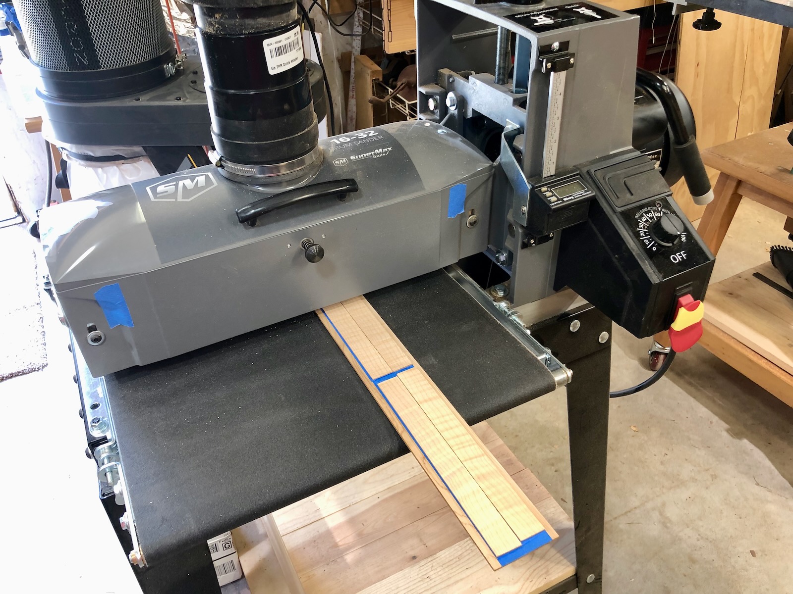

Then I use the ole painter's tape and CA glue trick to attach them to a thin batten board.
Then it's off to the drum sander for thinning. I first get one side clear of saw marks. Then flip them for final thinning to size.

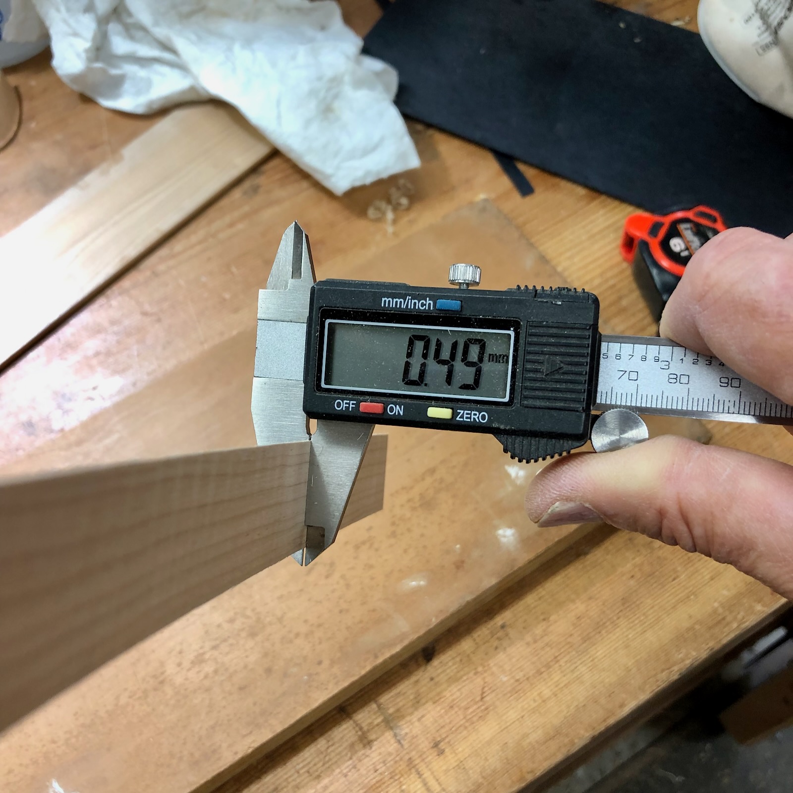

I have tried several thicknesses. I found that anything between 0.5 mm and 0.7 mm (0.020" and 0.028") will bend well. I tried thicker pieces with limited success. Every trial in my target range bent well.
All sanded and ready for bending.

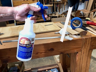

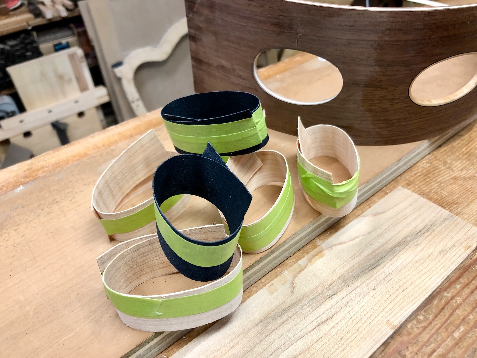

The next step is to spray some Super-Soft on them and put them in a plastic bag. The directions on the bottle are for flattening veneer sheets. I figured putting them in between paper and board and clamping them was not necessary and that is correct for what I'm doing. I just soak them, put them in a plastic bag, and let them stay there overnight.

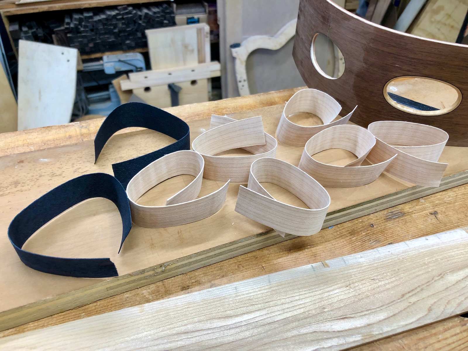

Now we have the actual bending. I think a video would be much better than trying to explain what I do. In the video I'm using a heat gun on it's low setting. The high setting will burn the wood. The low setting provides plenty of heat.
https://youtu.be/OAT0_M44UhU
I do this for a good set of strips. I also bend some black veneer strips. I don't bother using Super-Soft on these, they bend easily.
I let them sit taped up until they are fully dry. I think I left them overnight this time. They retain their bends well.
Then I glue them together in this order.

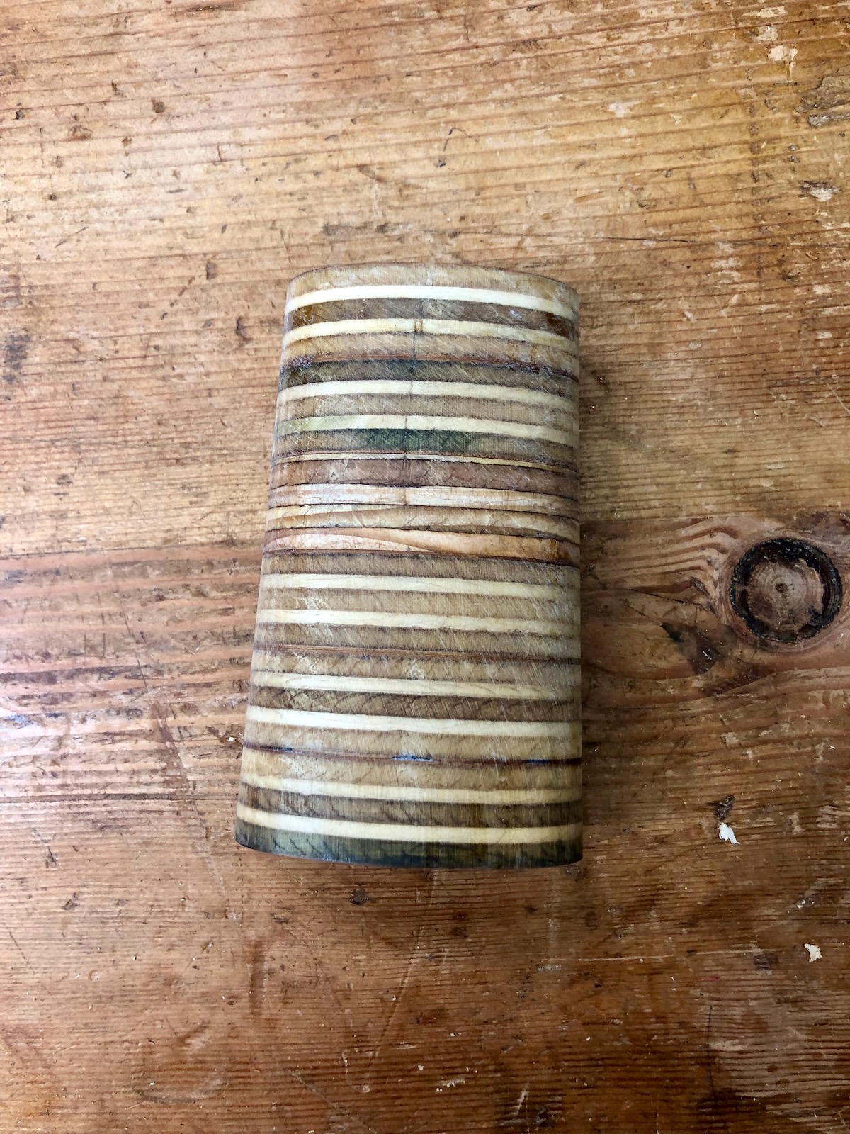

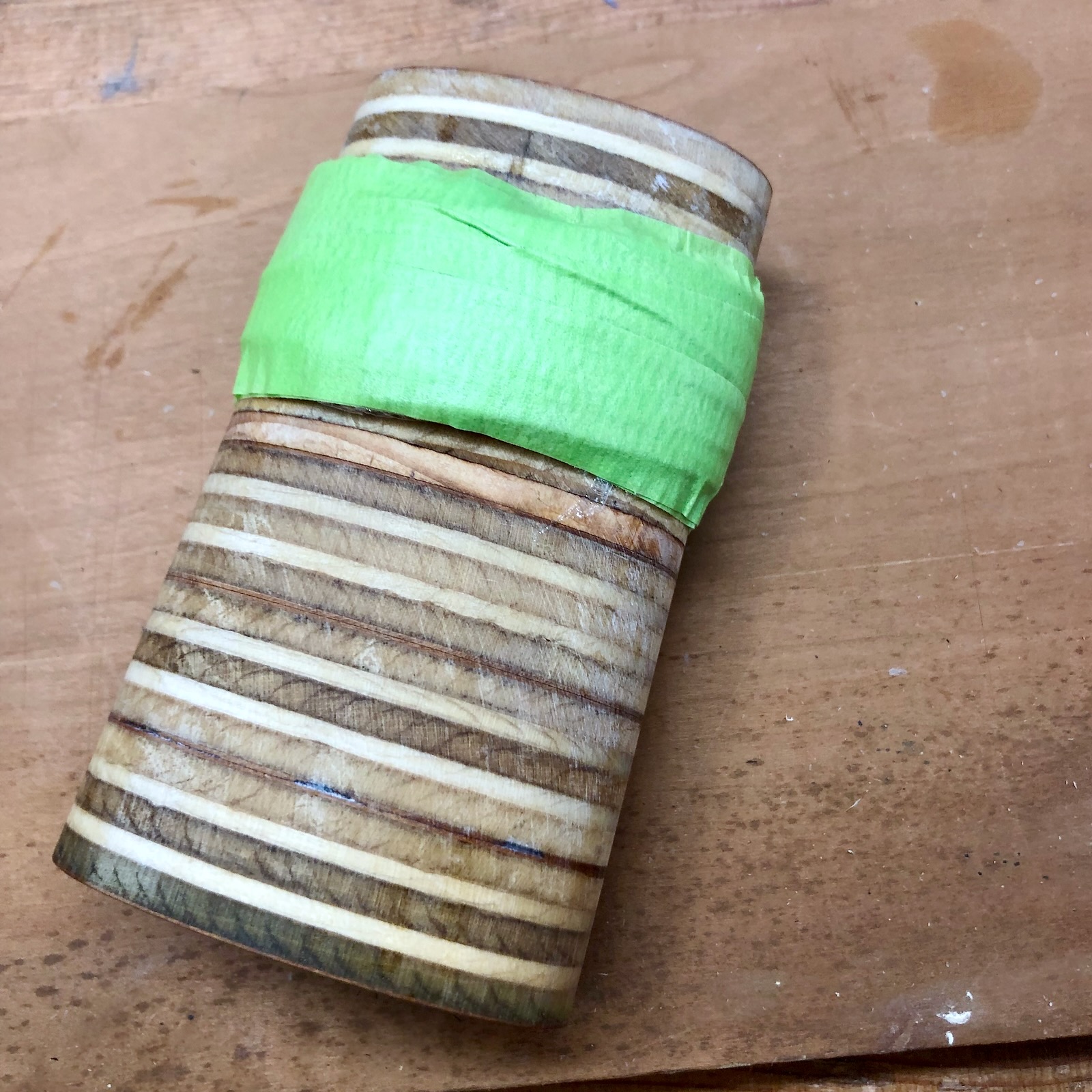

I use the form again for the gluing. I put the laminations on the form and wrap them tightly with 3M auto-body tape. This is stretchy and compresses the binding well. I don't have a vacuum system and I'm not sure it would work well at this size. It might be better, I really don't know.
Here's the laminated binding after the glue sets and I take it off the form.
(Continues)

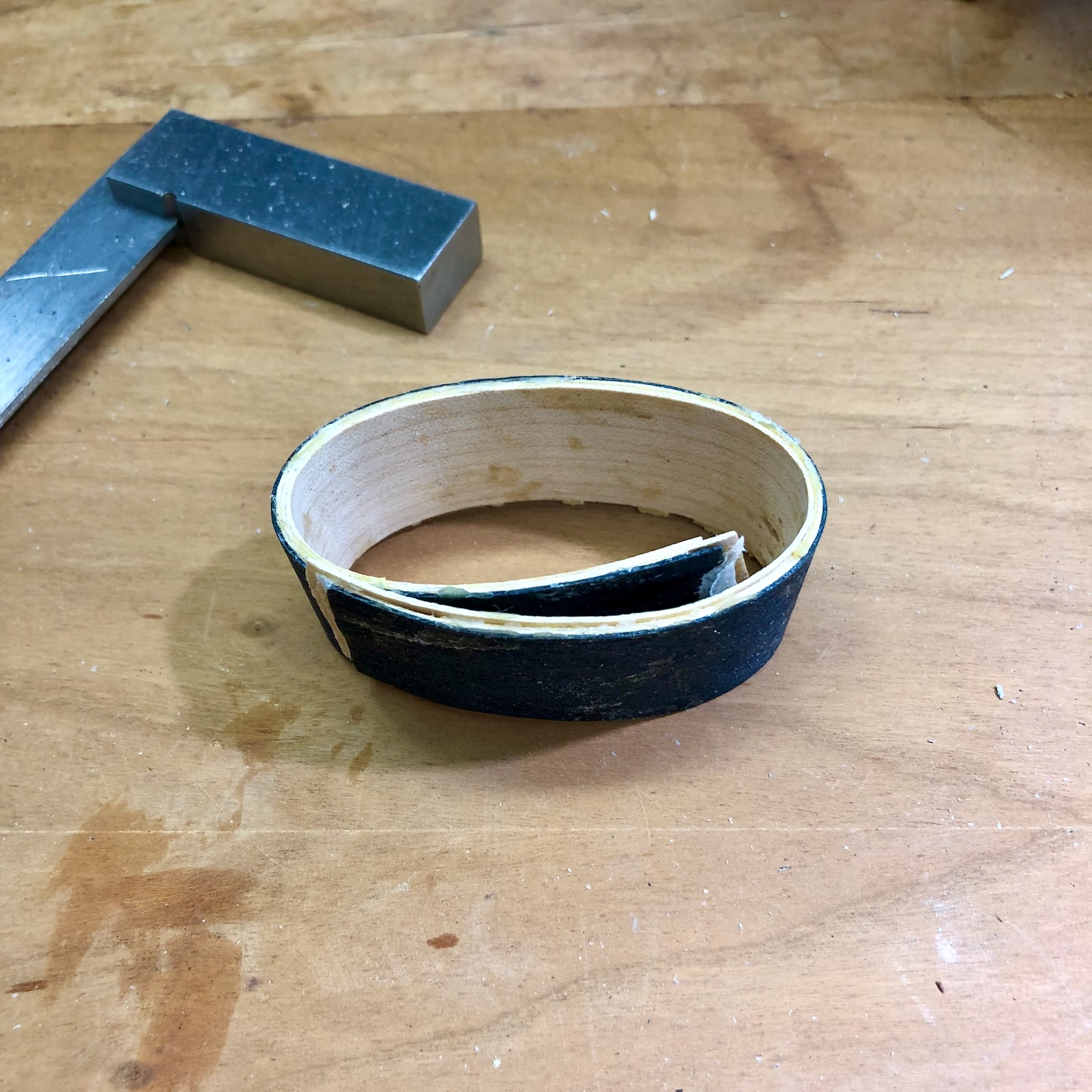

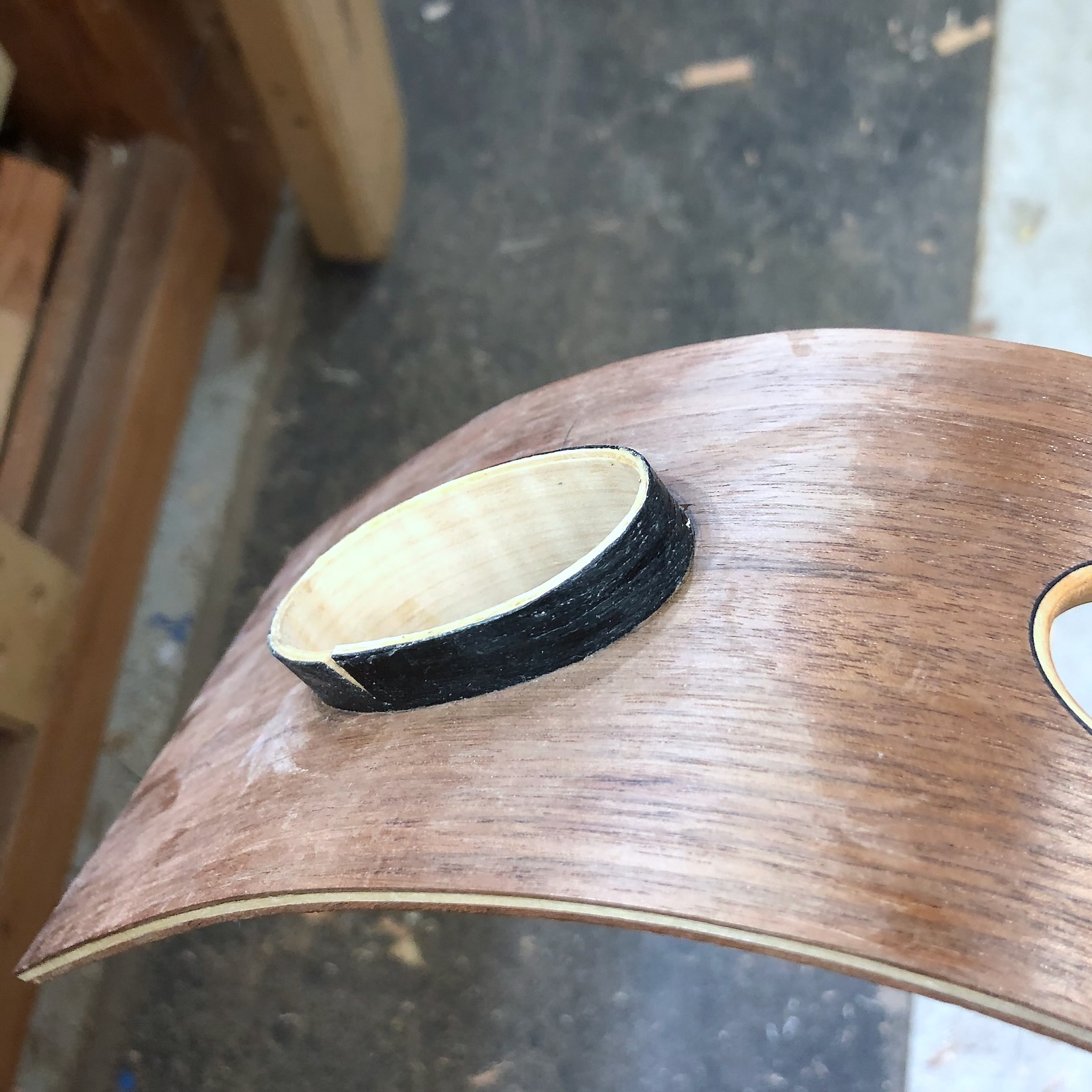

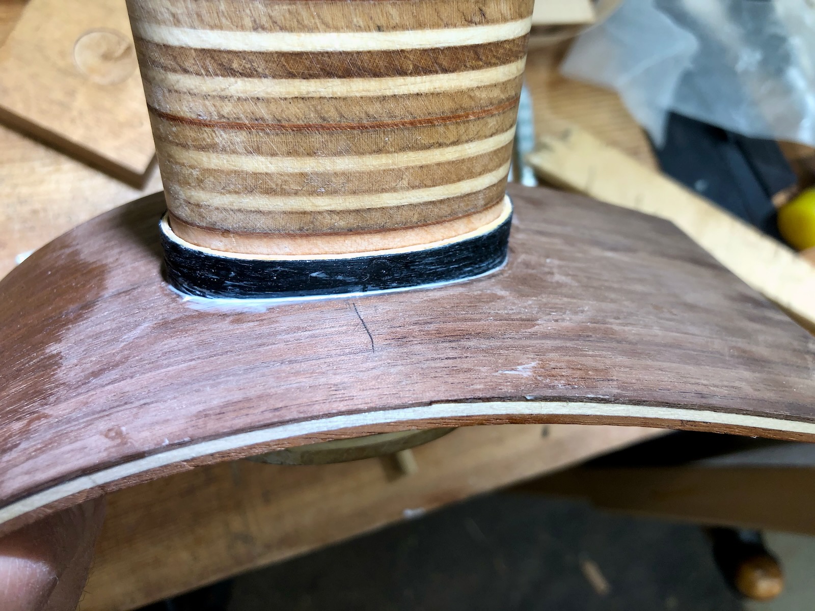

The trickiest part of the process is cutting and shaping the scarf joint. I do this with the form in the side port hole. It's a cut-and-try procedure and is fussy. However, since the port hole is tapered there is some leeway and getting close seems to be good enough. Then I use the form as a wedge clamp to glue the binding to the port. The joint should be very good as the form was used for all steps. I'm getting a nice bead of squeeze out all around.
I made the strips about 7/8" wide as that was the width of the stick I had. It should work down to even 1/2".
Then I pull the form out after the glue sets and start trimming the excess.
Once I flush the binding I shape it with a slight round over. I do this with sandpaper. Adding some oil to the trial lets me see if I have success.

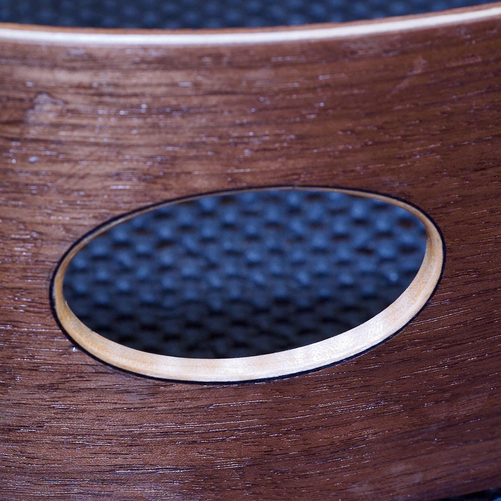

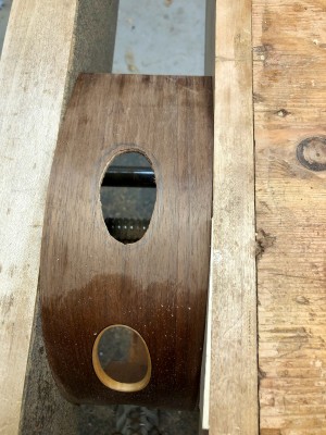

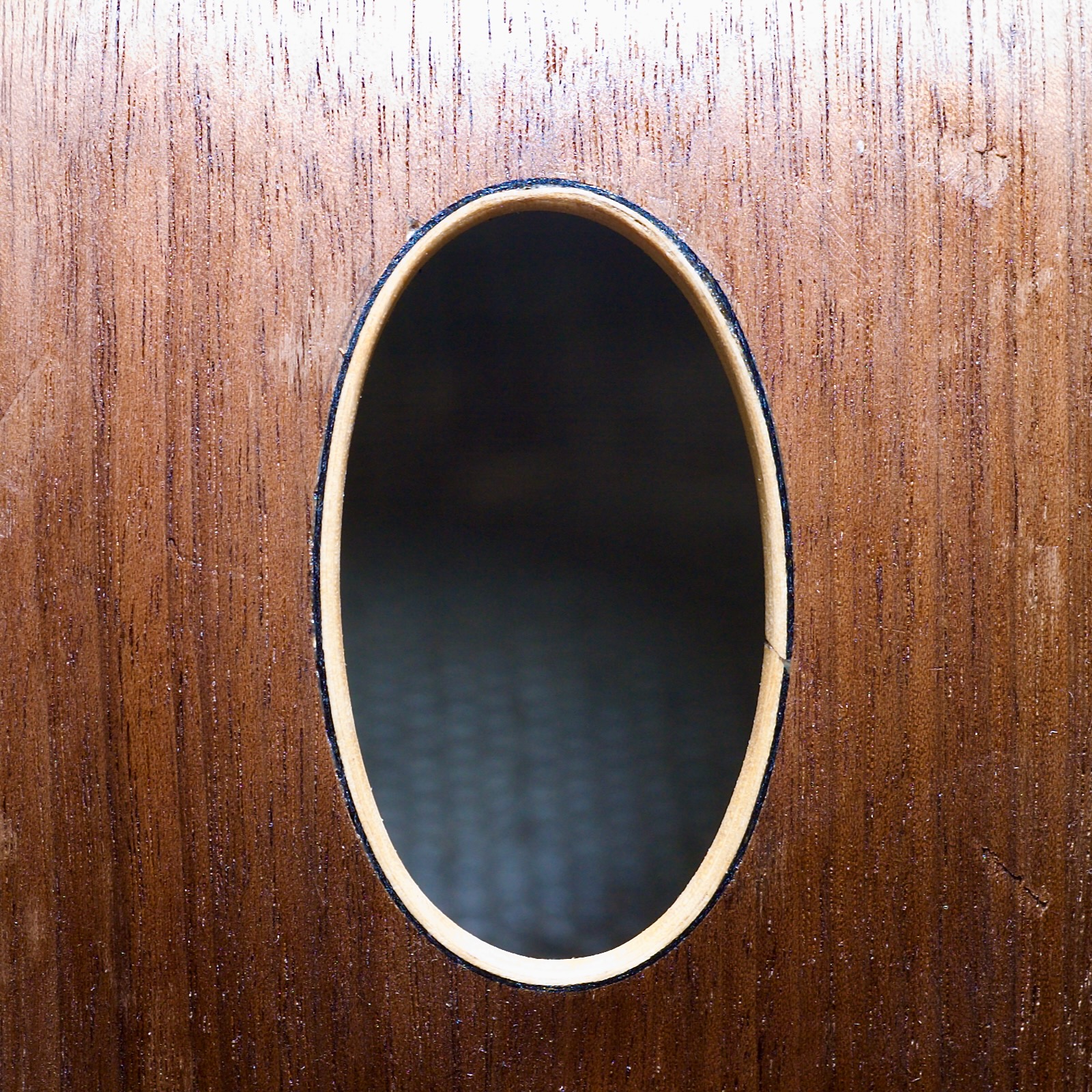

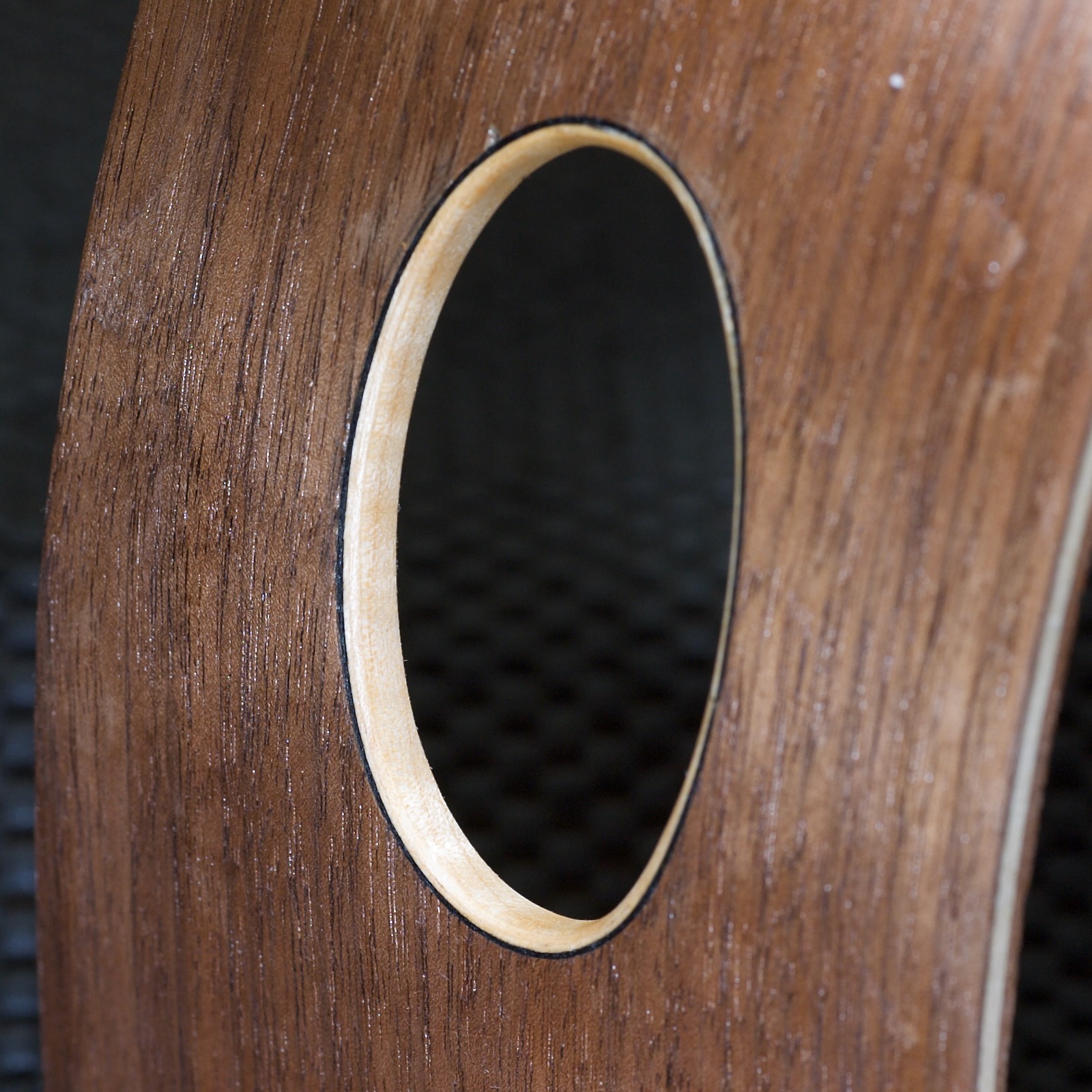

Here are some glamour shots of the final shaped binding.
Since this was all an experiment I am very open to suggestions on improvements to this process.
Thanks for giving this a look.
(All done!)

The tapered plug for shaping, laminating and gluing is genius.
