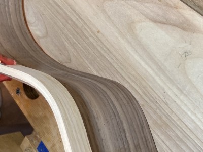

Hey guys… this is acoustic number 3 for me.

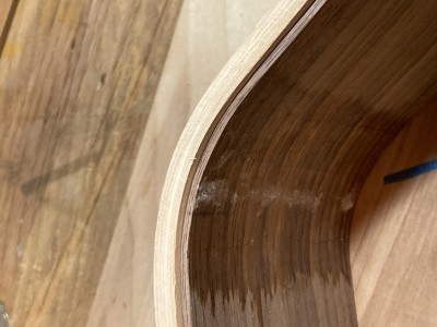

I was bending my sides on an iron, and when bending at the waist the side cracked on the inside of the bend perpendicular to the grain in 3 places. I had tape on the outside of the bend so the back side didn’t split open but the inside broke. I stabilized it with ca glue and plan to sand the side, to hopefully get the crack out… but cosmetically it’s not a huge deal. I’d like to get the crack sanded out but I will be the only one who notices.
I thought about laying the blocks on and clamping into my mold… then using a piece of side cut off bent appropriately to laminate to the waist area on the inside to strengthen it.
Structurally I feel good about it, but I am open to being corrected. I have another set of sides I could use if I need to, but I’m really thinking it’s ok. Kind of looking for confirmation before moving on. If everyone thinks it’s a bad idea I may change course.
Additionally, I’m likely using the laminated linings shown in the photos if that makes people feel better about it.
Thanks!

Wet wood normally fails first in compression. The sides may have been too thick, or not hot enough.
