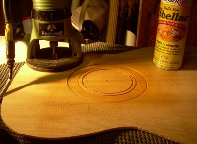

I then reset the router to cut the sound hole groove. I cut most of the way through the top but leave a thin web to hold the "plug" in place. I find keeping it intact at this point makes keeping things flat when sanding a little easier.

I set up another router to rout the area where the veneer will go. Veneer being rather thin, the bit is set accordingly and the rout still leaves the purfling grooves intact. I then use spray shellac to lightly seal the rosette area. I set and tack in place the purfling strips with CA glue

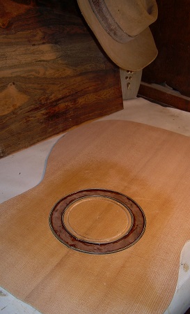

I then flood (lightly) the area between the purflings with CA and fit the veneer ring in place and "rub" it down with a stick to make sure it is making good contact with the soundboard.
I then plane down the purflings flush and lightly sand the rosette.

I've seen a number of people use these veneer rosettes on their guitars, and decided to try making a couple. They are so easy to do it almost feels like cheating. That is the second one I've done.

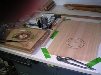

Took me a while to get pics of the jig. I use a tutorial provided by Eric Schaefer, maybe on OLF, to build the rosette blank. On the natural edge one, the outside edge was sized to the finished dimension.
Sand it to thickness then stick it down to the routing jig. I use the double tape method with CA between. Usually they are finished side up. I go between jig and top as the radius is set on the router like your description above.
The natural edge one was stuck upside down on routing jig. Start with the outside radius in the top. Maintaining the depth, increase the radius by a little less than the bit/burr width to reduce the slop in the fit and do the recess on the outside edge of the rosette. Repeat until edge is cleared. Then cut the inside radius on the top. Decrease the router radius as on the outside and clear the inside radius until the inside rosette dimension is cleared. Increase the depth of cut and cut out the rosette center. Clear the rosette grove, cut out the soundhole. The top needs to be sanded to finished thickness before gluing it. Keep in mind where the end of the fingerboard will be too.
