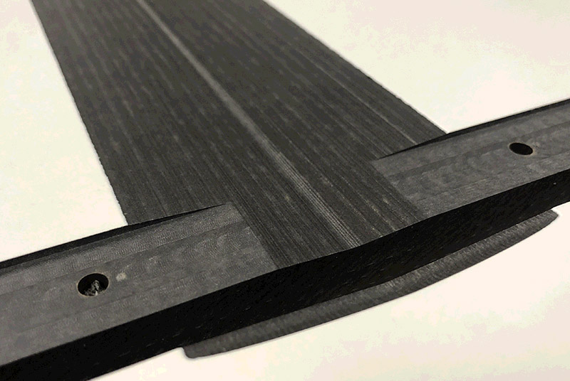

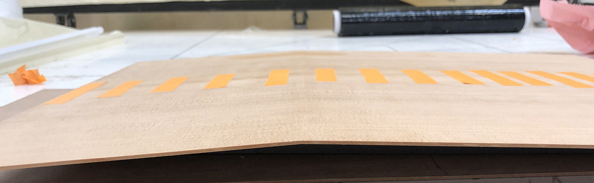

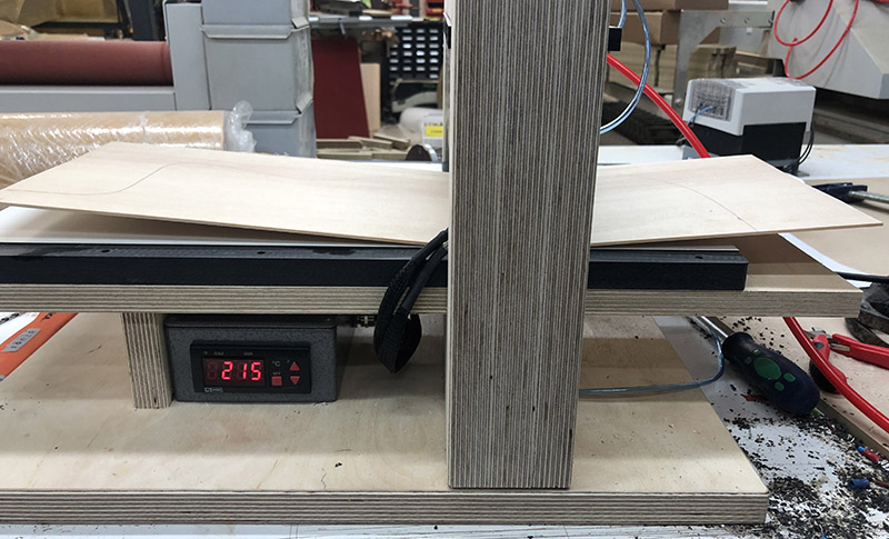

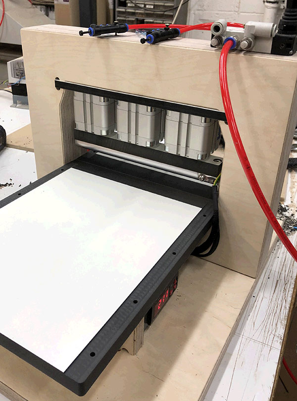

I am building a Petite Bouche copy with a sharp creased (rather than wider bend) pliaged soundboard. Has anybody created side templates which would allow me to get the sides more or less to shape before final sanding? The geometry of these guitars is pretty odd to say to say the least and I am struggling a little to understand exactly what is going on. I have both Michael Collins' book and François Charle's plans but both show different geometries with regards to the shape of the braces. Michaels Collins' pliage form is quite different to mine so I am probably going to work more closely to the François Charle spec and therefore I am not sure if the raised block technique would necessarily work for me. Ideally I want to come up with a process or jig that will allow me repeat the shaping of the sides accurately rather than it being a fairly subjective 'by eye' exercise each time.
Has any one been through this process and come up with a definitive method?
I have attached a few pictures showing the pliage press that I have built and the resulting glued up soundboard. The press has three pneumatic cylinders that push down a heated 1" aluminium tube onto the soundboard which is then pressed into an 8° bevelled machining on the press bed. There is a little spring back but the resulting 5-6° pliage is very stable and the process very consistent. It takes about 45 seconds at 2 bar pressure to the cylinders which equates to about 120kg of pressure on the soundboard and I place a strip of damp cotton fabric along the line of the pliage under the pressure bar so there is an element of steaming going on as well as the heat.
