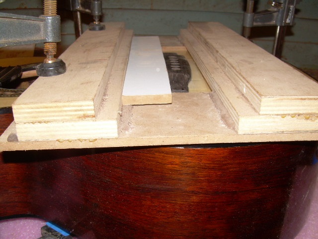

I use a simple homemade jig to rout saddle slots on bridges that are glued to the soundboard. The white melamine strip helps line up the jig with the saddle location - it has the same offset as the router bit. The square subbase of the router rides in the track formed by the jig. "Start and "Stop" marks are penciled on the jig so the rout is kept in the limits of a drop-in saddle.
