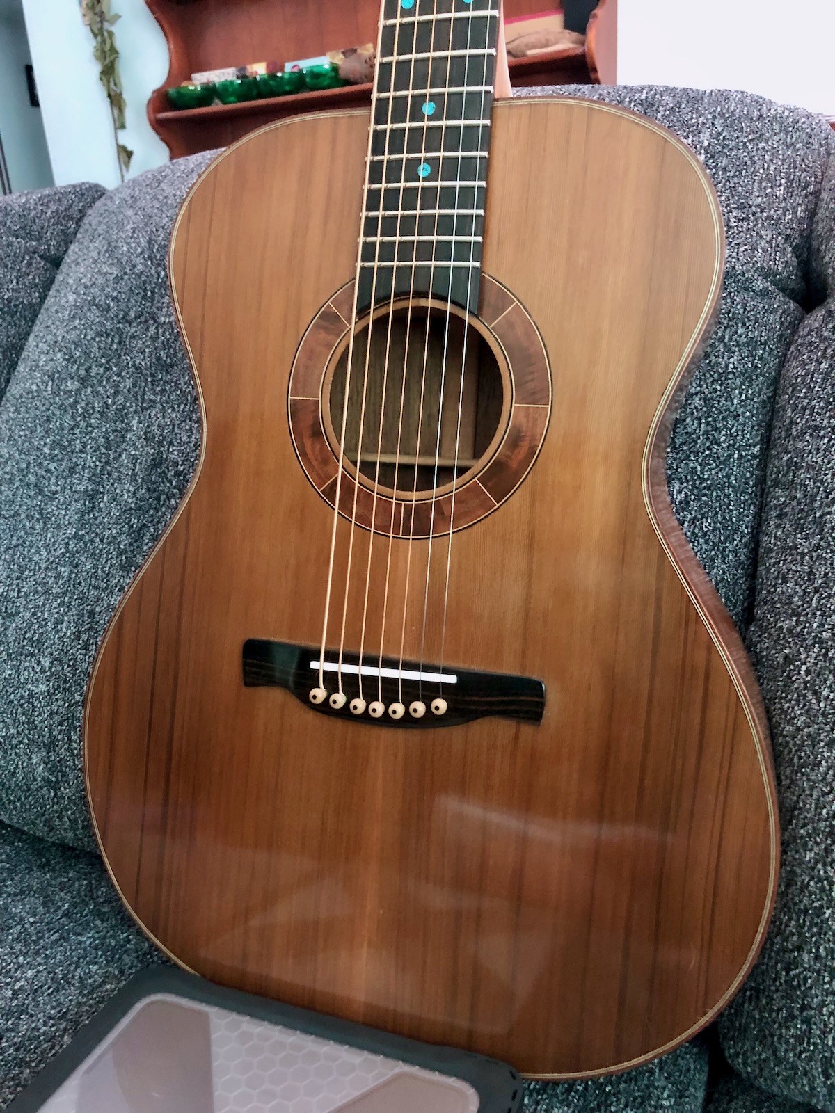

Well, since I'm working on guitars 3 and 4 I thought I'd do a followup on number 1. I have the intonation as good as I can get it with this fretboard and bridge. It's not bad and I'll never be satisfied anyway. The top is western red cedar from a piece of siding. The back, sides, and neck are walnut.

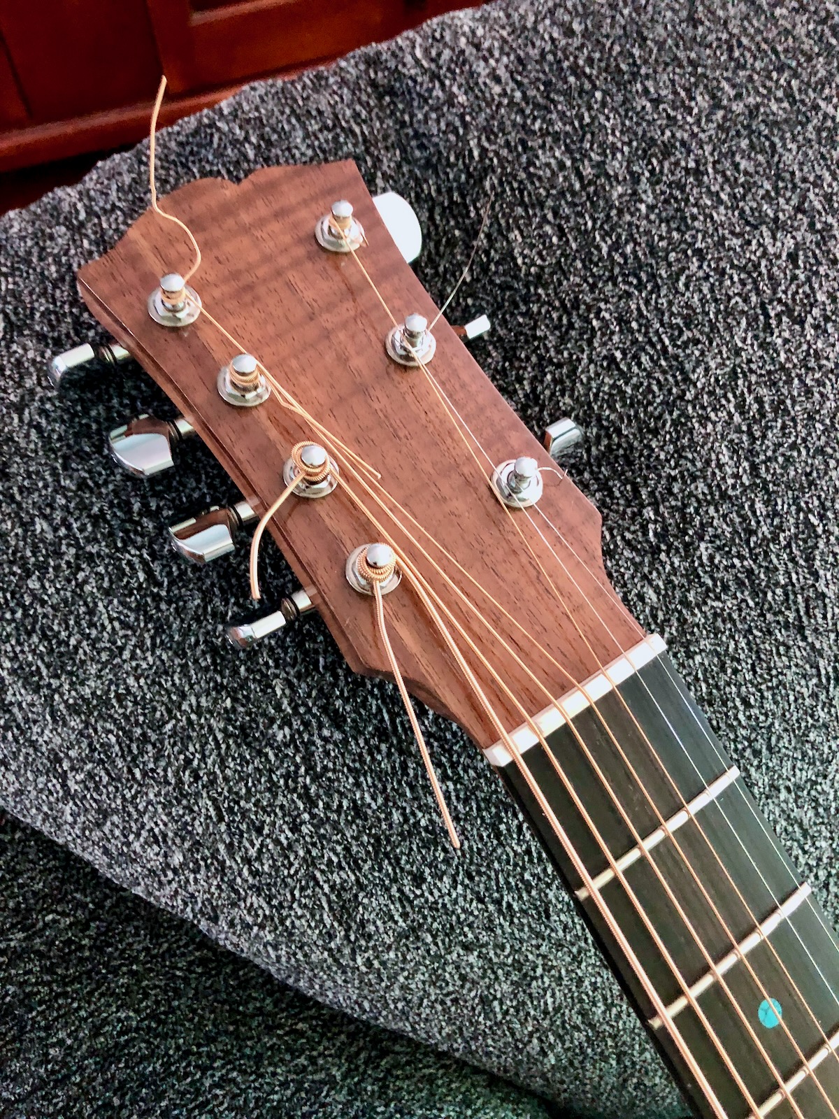

Seven strings! What was I thinking?
My first rosette, too. It's walnut burl figure with maple and ebony highlights.

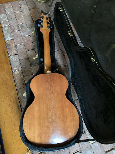

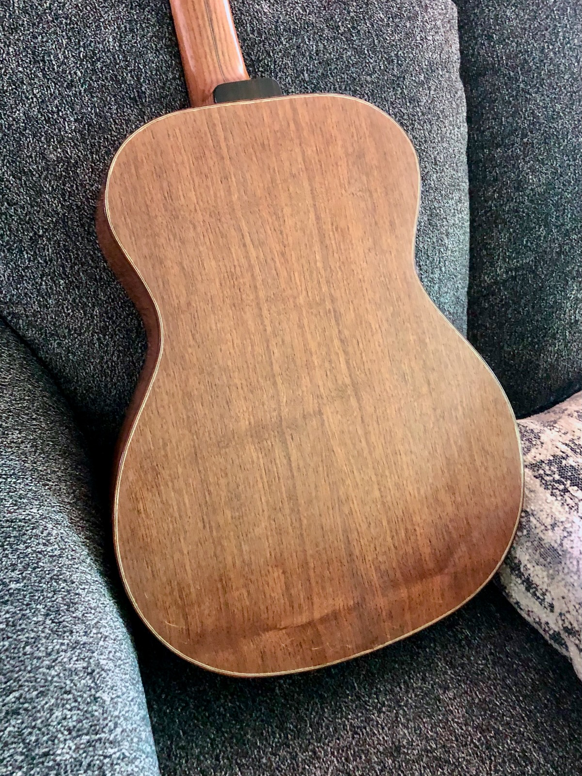

Pretty plain walnut back and sides. I didn't want to use fancy woods on my first build.
It will always be my first and I'm very happy with it. It has a lot of rookie flaws but that's ok, I learned so much making it. It was quite the rush playing it for the first time. On to the next builds.

Thanks, it was a very nice moment. I only wish I could play better.Bryan Bear wrote: ↑Fri Jun 09, 2023 12:09 pm Looks great; nice work. Hearing the first one is always something special!
I was surprised when the WRC turned to almost the same color as the walnut when finished. They weren't like that before the shellac. I do like the look now. I think I have one more top from that board.Bryan Bear wrote: ↑Fri Jun 09, 2023 12:09 pm I really like the vibe of the walnut and cedar together. It is nice and understated looking but not at all in a boring way.

Thank you! Um, well, er, I hope so too. I'm not a great player so I can't judge. I had to do a lot of adjustments including removing the fretboard and moving it slightly. Getting consistent intonation on an acoustic guitar is a challenge for me still. Guitar number 2 was better and I'm hoping the next one is better still. Step by step, eh?Eric Crawford wrote: ↑Sat Jun 10, 2023 8:51 am I like it. The woods look really good together and the rosette is beautiful.

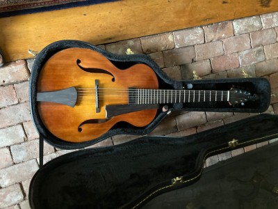

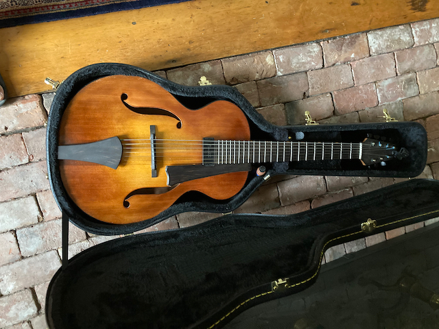

+1 for the idea of a multi scale 7-string. I built a 7 string, short-scale (24.75"), archtop guitar and I'm still playing around with string gauges, trying to get a low B that sounds good acoustically. Plugged in (Seymour Duncan "Benedetto" floating pickup) it sounds quite good with a .062 flat-wound string borrowed from a short scale Gibson bass but that string doesn't speak particularly well acoustically on my guitar. I'm going to try a .070 flat wound D'Addarrio chrome next. I would not use that (single) scale length for a 7-string again but the rest of the strings sound good to me (TI GB112 strings are my favorite so far) so multi-scale would probably be great.

It's my first archtop and my second build so please be gentle. :^) I built it as an experimental platform and tinkered with it for a couple of years. At one point I removed the top and shaved braces (they're parallel). The acoustic sound got better. People often fret (pun intended) about carving an archtop but I found that fun and pretty easy. I spent waaaaayyy more hours designing, making and breaking tailpieces than I did carving. The arches are curate cycloid (worth investigating) and I used R.M. Mottola's web-based calculator to draw the curves, print them and make templates. Anyway, I could talk your ears off about it but you didn't ask for all that so here are a couple of crappy cell phone snapshots I just took.
