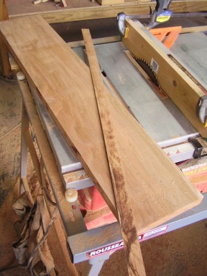

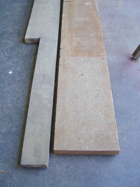

I've never participated in one of these so I thought I'd give this one a try since I use local woods for alot of my customs anyway. I'm actually going to be building 2 Grand Auditorium Cutaways at the same time but, of course, because of costs, only one will be eligible and entered into the challenge. I'll be using cherry for the sides, back, and some binding and trim and then black walnut for the fretboard and bridge. My local supplier gives me scraps and splits/breakoffs alot of times so I'll be using some scrap mahogany for the kerf linings and scrap spruce for the bracing. Below is my list along with costs for one of these along with a few pics of my materials.
Wood – Cherry (2.25 BF) - Local $4.50
Wood – Black Walnut (.5 BF) - Local $1.50
Wood – Mahogany scrap (.5 BF) - Local $1.00
Wood – Spruce scrap for bracing – Local $N/C
Carbon fiber reinforcement rods – Local $N/C
Spruce top - Old World Tonewood $7.50
2 Way Truss Rod – Bezdez (Ebay) $7.00
Keystone Tuners - GuitarFetish $24.00
Bone Nut – Bezdez (Ebay) $2.00
Bone Saddle – Bezdez (Ebay) $4.00
Ivory/Black dot bridge pins – Bezdez (Ebay) $1.50
Rosette – Bezdez (Ebay) $6.00
Fretwire - Grizzly $3.00
Pearl Dot inlays – Bezdez (Ebay) $3.00
Purfling - Grizzly T1124 $9.00
Backstrip - Grizzly T1125 $5.50
Neck attach hardware - Grainger $3.00
Watco Lacquer – 1 QT $7.25
Misc Tints, Stain, etc $4.00

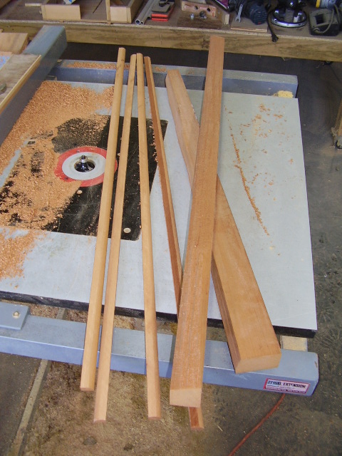

I decided to get started earlier today so I took a few split scraps of mahogany and ripped/routed/sawed them into kerf linings.

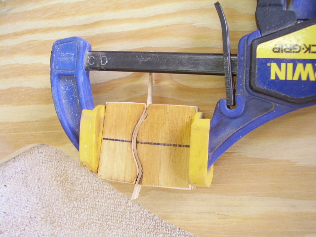

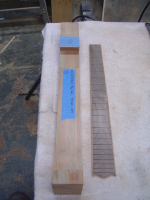

Made a little progress today. I got the neck blank made and scarfed the headstock on as well as got the heel blocks glued up. Without paying attention, I glued and clamped my scarf joint backwards but luckily realized and corrected it before the glue had time to set.

Got the fretboard made and slotted also.

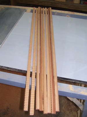

I ripped a few thin strips off the edge of the cherry to make the binding. Bent the small end piece to go on the end of the fretboard and glued the bindings on.

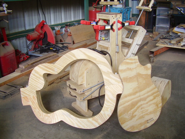

...and a picture of my shop-made sidebender with cutaway attachment along with the bending forms, template, and mold that I'll be using.
Posts: 1982
Re: $100 Local Materials Challenge, Eddie McRae, Grand Auditorium Cutaway Acoustic
That all looks good Eddie, you are cranking right along.
I saw a bottle of the dreaded Titebond II in that one photo...I hope you aren't using that stuff!
Eddie McRae
Posts: 153
Location: Woodbury, GA USA
Post by Eddie McRae »
No, that's actually original Titebond. I buy it in gallon quantities and then pour it off into extra bottles I have laying around the shop.

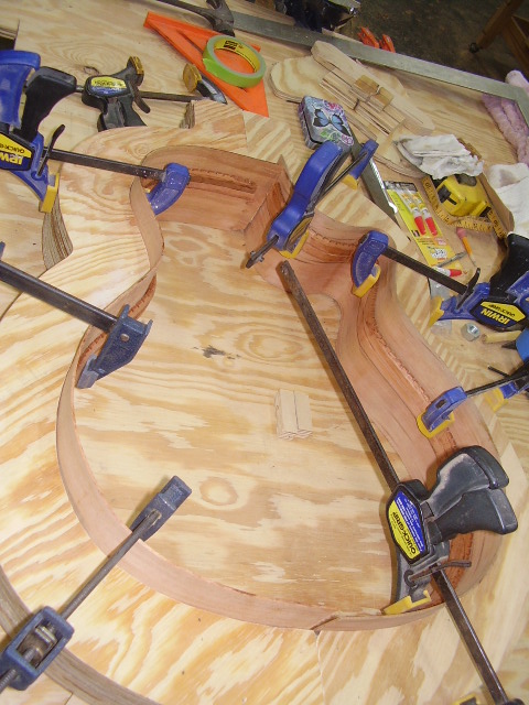

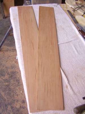

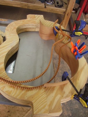

Thanks guys. I decided to put the bender to work today. Resawed my sides and surfaced them to thickness. Then got the sides and the kerfing bent and temp-clamped into the mold. Had a few minor issues with these two sides though. They didn't actually blow-out but they tried and I've got a little grain break and separation in one spot on each of them. I think both areas will sand out ok plus both areas fall under the kerfings so that should help also. I've been using galvanized flashing for slats when I bend and I'm convinced that I probably wouldn't have had these problems if I had been using spring steel. So I decided today to go ahead and order a set of spring steel slats and hopefully I won't have any trouble in the future.

Both sides in the mold along with the kerfings.
