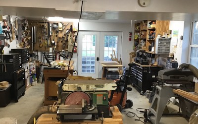

Here are a couple of photos from each end of the shop. I purposely place things so that I have to walk around. That keeps me from getting too stiff as I work.

Bob- Thanks this is really helpful. Looks like you are well organized and have enough room, but I can see where 700 to 900 sq ft would be welcome. As you pointed out, instruments can be hung up while in process, and I hadn't thought about that. Very nice pictures, so the lighting must be pretty bright and even. It could well be that workshop space in the range of 800 to 1200 sq ft might be enough with some flex space as well. I hope others will chime in here and share their thoughts.
