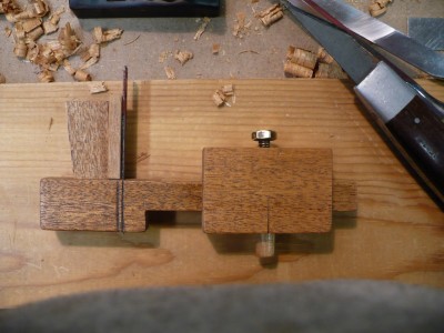

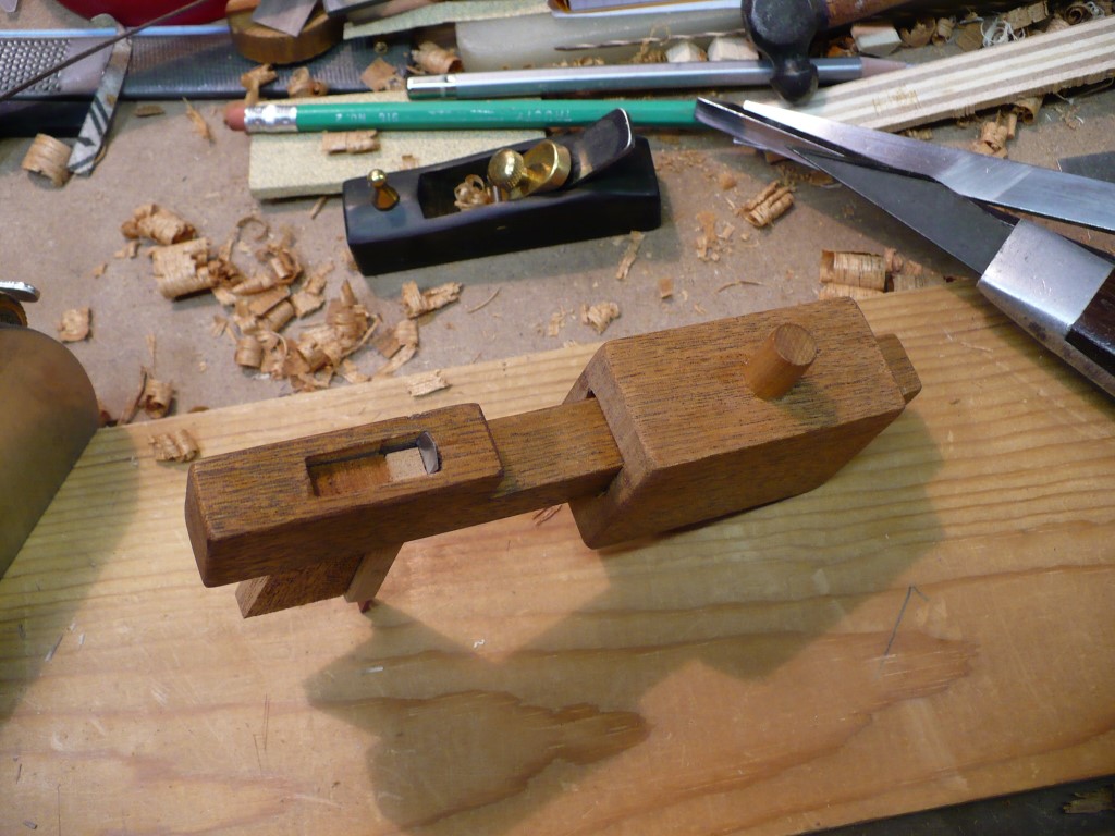

- Waddy Thomson
- Posts: 270
- Location: Charlotte, NC
Re: Cutting rosettes by hand?
For what it's worth, here are a few pics of my tool. I made it when I built my first guitar, which I did with all hand tools, so I could learn how to use them. I did buy a 10" band saw because I failed miserably doing some things by hand. I already had a radial arm saw. I still use this tool for clean edges and for cutting out the sound hole. I did replace the wooden pin with a 3/16" metal pin. Tool works for both circle cuts and for binding and purfling cuts, with the attachment.
Thanks to Waddy for the new pictures.
The two threads that Jim posted above have some nice stuff too.
Waddy's last picture here shows something that is missing on commercial Gramil trip tools for doing bindings/purflings, namely the extra long "leg" (don't know the technical word) to keep the tool stable as you go round the sides. The commercial ones I have seen only about 5-6cm so very easy to tip over.
