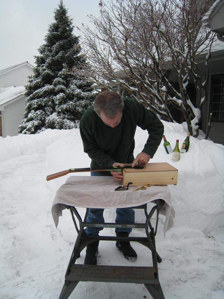

You can build anywhere... I've bent purfling and bindings on the gas grill while cooking supper.
I recommend you just start building. You've been around here long enough that you know you can figure out solutions to any problems if and when the problems arise.
Figuring out all the solutions first will only end up with you wasting your time when you could have been building. Meanwhile, all of a sudden you've got 6 kids to put through college, and the next thing you know the kids are putting you in the rest home that doesn't have a shop attached.

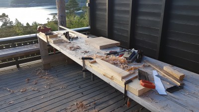

My biggest concern would be humidity control. You can do most wood processing, shaping of parts etc in a non-controlled environment, but unless you can control the RH where you assemble the instrument, it may distort, develop stability issues, cracks etc later. If you decide to use your bedroom for these operations, make sure you get a good hygrometer, and if necessary use humidifier / dehumidifier to adjust the RH.
We have a summer house where enjoy working outside on my makeshift "workshop" when the weather is nice during summer. I use mostly hand tools, and I make mostly various pieces of furniture and stuff we need for the house, but no instruments. The view is much nicer than at my regular shop!

My favorite bench for building is actually a workmate by Black and Decker. It's about as old as I am... which is OLD. My issue with work space is heat, humidity and dust. If you can control those adequately, then you can build in a pretty small space.
- Randolph Rhett

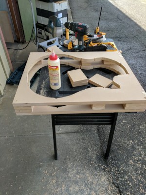

Just an update,
About 2 weeks ago, I was going insane with stress. On top of a full workload, taxes, staff calling in sick last minute, our neighbors caused a pipe to burst, and we had to quarantine the area. The flooring had to be stripped, and I had to stay on site to make sure things ran smooth. I hadn't had a real day off for a long time.
As the guy was doing his thing, I tested out my "mobile luthier command center."

It worked surprisingly well.
FWIW, the water repair guy called out his daughter to see what I was doing.
He thought it was pretty cool that a dentist was building a guitar while overseeing the disinfection of the operatories.

I was using a jigsaw to work the form, and I hear "Loretta, you'll never believe this! Come quick. Some doc is building a guitar."
Then a lady that looks just like her dad pokes her head out and does a double take.
