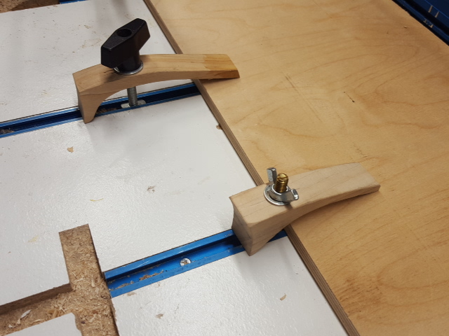

Just a pic of some useful shop tools from elm. Elm is good for small things that take advantage of the interlocked grain. These hold downs are easy to make and and are tough. They're excellent for the drill press too.
