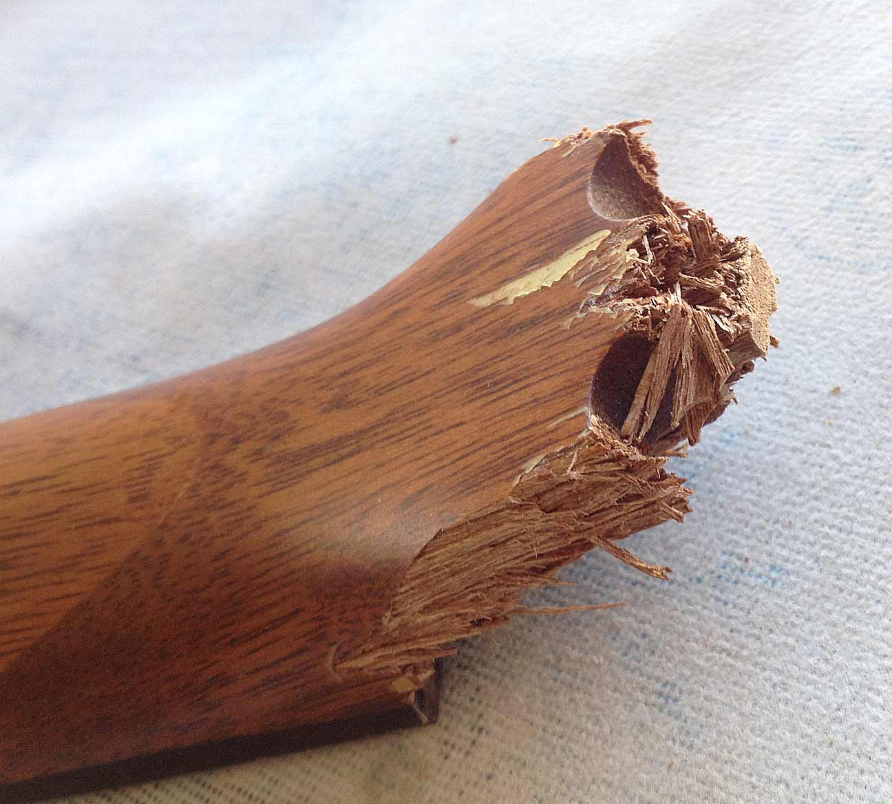

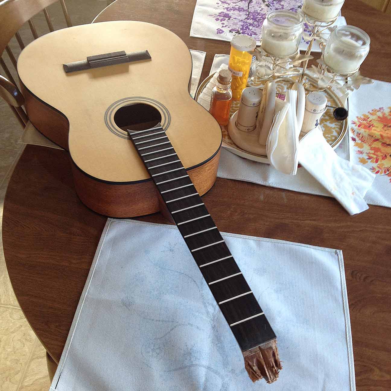

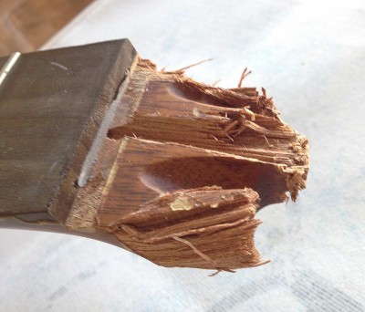

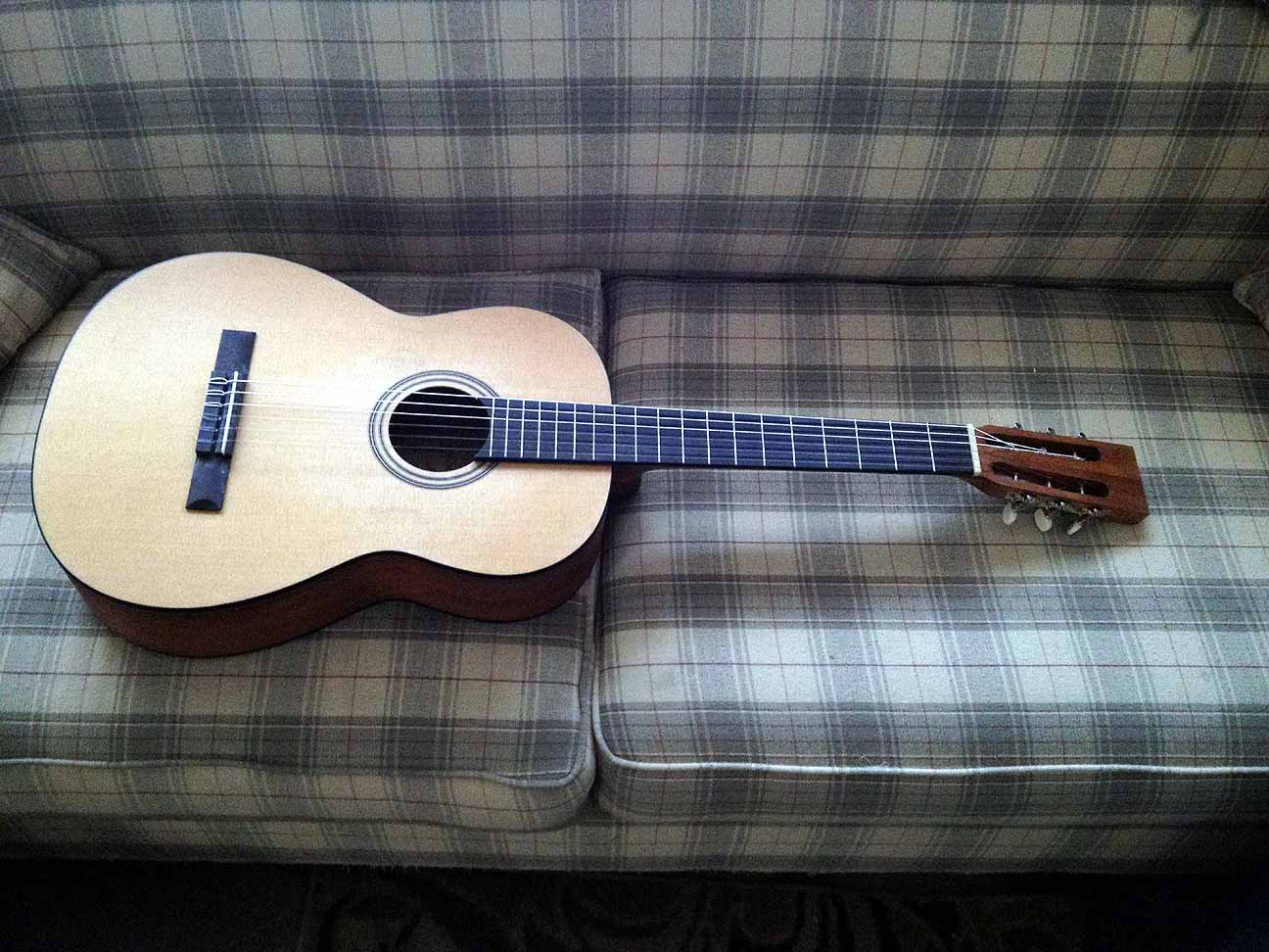

Head stock broken off and not available. Cheap classical guitar (Alvarez RC12) which unfortunately has a truss rod, but luckily has sound hole adjustment. I'm going to make and attach a new head stock - cosmetics not important but function is. Since it's nylon strung the tension won't be too great.
Before I start, any ideas/suggestions (besides a new neck which ain't gonna happen)?

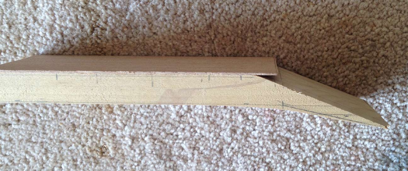

I'd cut a scarf joint in the opposite direction to what we see in the pics, avoiding the truss rod.

A couple of inlaid reinforcement strips on either side of the truss rod I've seen done. Even where the fracture is clean and the headstock attached. Probably good insurance.

It has a double action truss rod which ends 1/4" from the fret board end, and extends about 1/2" deep under the fret board, so this limits the angle that I can cut the scarf without the truss rod getting in the way of a clean cut. I'll probably cut leaving some of the damaged wood. I can cover the top with veneer, but the sides of the head stock might be a little ugly.

Peter, I did an almost identical repair and documented it here nearly 20 years ago. Simply sliced off the bad part and attached a new head. I did have to buy new tuners, but the wood was scrap - cheap repair. First time I'd ever done anything like that, and it turned out great. Have a look: http://www.mimf.com/old-lib/replace_peghead.htm
Posts: 1322
Re: Ex-wife ran over guitar
Thanks Jim - great job! I'm afraid I'll get into more work and trouble if I try to remove the fret board and truss rod, especially not knowing what kind of glue was used on this Indonesian made instrument. I'll try a reverse scarf joint first with a few inches of carbon fiber rod to each side of the truss rod. If that doesn't work out I'll try to get the fret board off.
Japanese carpentry is intriguing. You might get an idea or two from this website:
https://architizer.com/blog/inspiration ... d-joinery/
The idea of a box, or finger joint presents itself if you slice the old neck off square at the nut. Leave the center part under the truss rod and slightly to either side of it intact, cutting two channels right down to the underside of the fretboard to mesh with the headpiece. Keep the outermost part of the neck shaft intact and the new piece a little proud and blend it in.

I'm late to the party here but I wonder if you could do a v joint here. Cut the traight parts flush with the end of the fretboard and you should have enough good wood to make the v. The tops surface of the Ved area is missing but you should be able to get clean gluing surface of the v. Then you can fill in the missing wood and cover with a peg-head veneer.

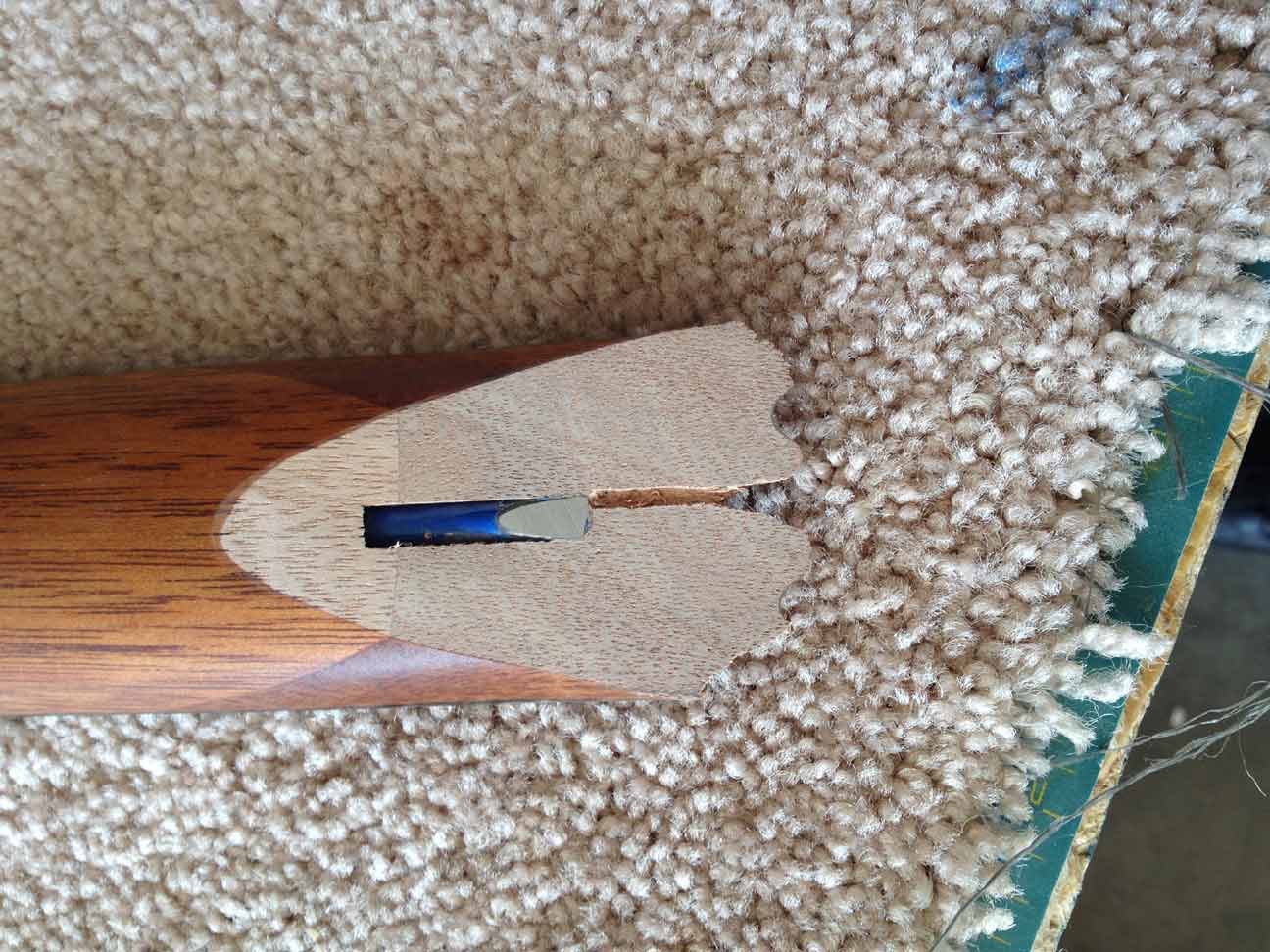

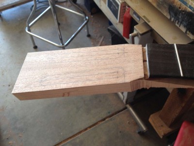

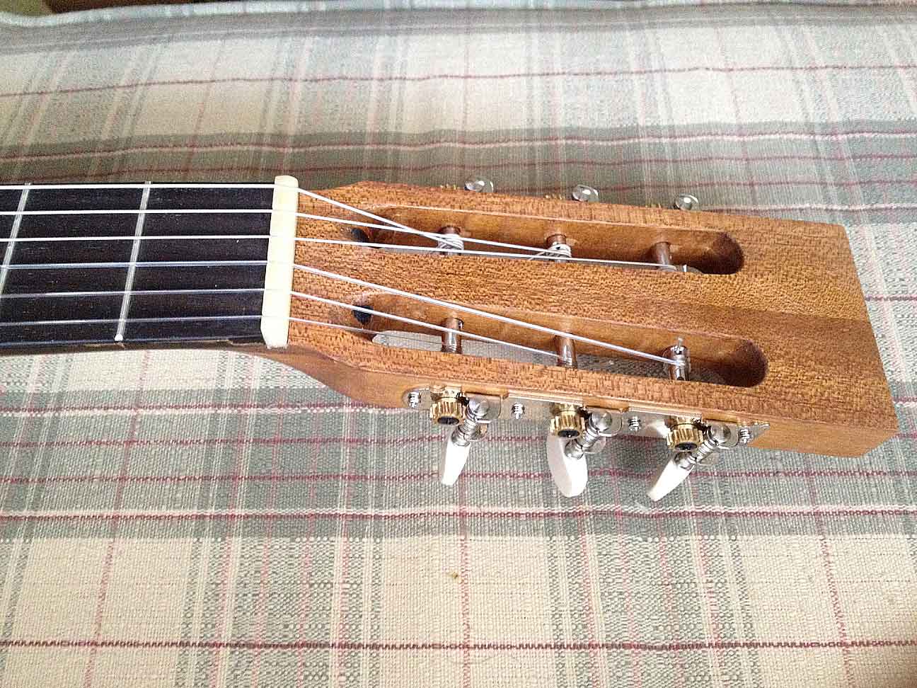

Thanks for the suggestions but it's too late. I've already cut a reverse scarf, and started the headstock to fit. It's from alder so not a match, but it's what I had scraps of. Veneer is mahogany cutoff from a back. After I cut the neck I sanded down into the truss rod a bit to give more gluing area. I'll cut the slots and drill tuner holes, then glue it on, shape it to the neck, and put in a couple of CF rods from the slots into the neck for more strength.

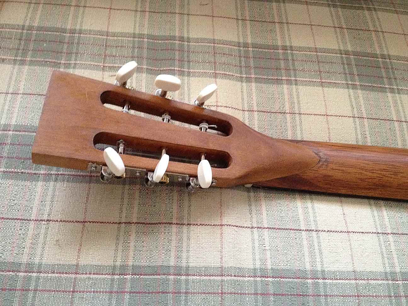

Well, it's done, and the headstock hasn't snapped off yet. I rubbed on a little dark walnet/honey amber dye and gave it a couple coats of Tru Oil - not a great match, and the end of the joint is rough where I sanded off some original finish. Found a Stewmac tuner set I got years ago and never used. Made a nut and saddle from the dog's old bone. Strings from a bulk set I bought many years ago. Cosmetically flakey, but it was free, and if it works, that's what I was going for.

Thanks Karl. I could have spent a little more time repairing the sanding marks on the neck, used mahogany for the headstock, and should have drilled the tuner holes before I cut the slots as there is some tearout, but it is perfectly functional and appropriate for the quality of the guitar itself.
