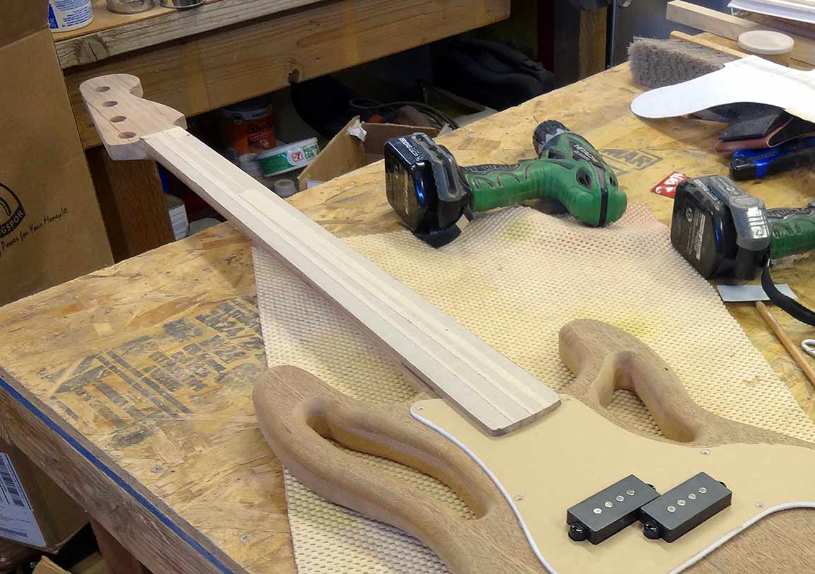

I'm building a bass that has a maple neck and fingerboard and was planning to use Tru-Oil over an amber stain for both. I was originally thinking that the finishing should take place prior to fretting, but if that is the order of operations, what is the best way to clean up the fret ends without marring the finish? Or would it make more sense to finish the face of the fretboard first, fret, clean up ends, and then finish the neck? Or all finishing after fretting? The last option there seems like it would be hard to get the stain on the fretboard even and likely the finish as well. Similarly, what techniques would be used to re-fret a finished neck like on a Tele or Strat? I'm hoping that I can learn from other people's experience here before making my own mistakes. Maybe there's a reason I've always used ebony in the past...

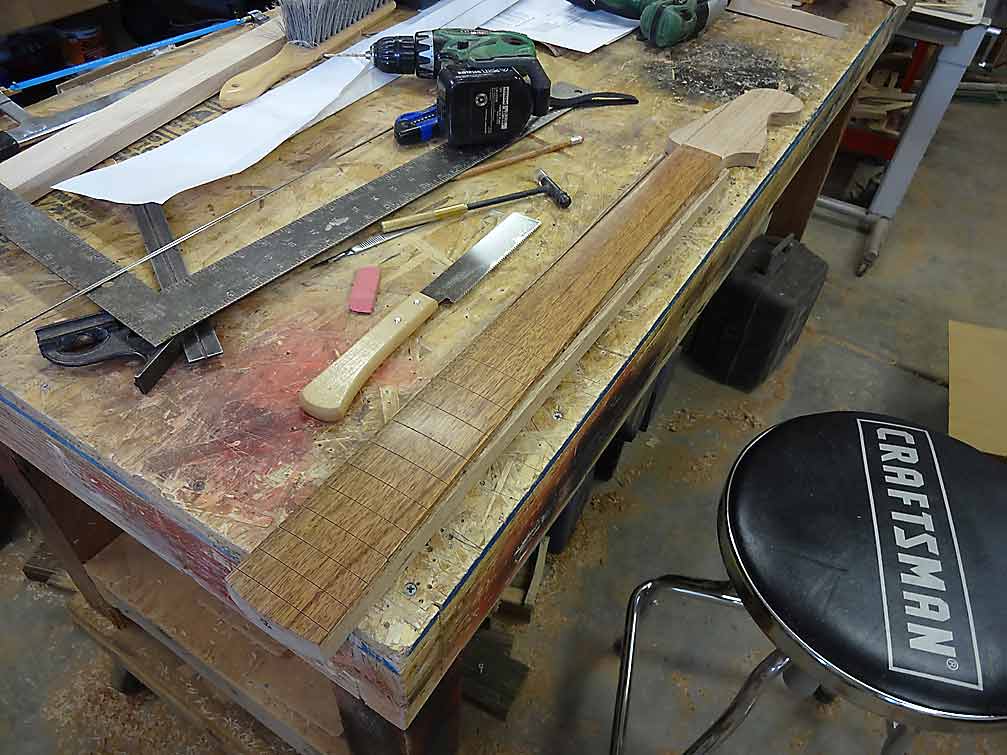

I've made a number of Fender style maple necks. My way works for me, but of course there may be better ways to do it. Mine have a lacquer finish, but you could probably use the same method with Tru oil. I make the complete neck and finish sand, then cut the fret slots and install frets. I tape between the frets, then level, dress the ends and polish (important to have the tape on unfinished wood or metal filings will stain it.) Then spray the lacquer, and when dry (but within a day or so) scrape it off the frets with a tool I think I got from a post here by Mark Swanson - take a nail and file a fret-shaped notch into the head and pull it across the frets, scraping the lacquer off. I suppose you could do this with a Tru oil finish too if necessary.
Alternatively, I made a mahogany bass neck in the following manner (actually a two piece, but I glued the fretboard to the neck before finishing it). I finished the fretboard before I carved the neck, though I don't suppose this really mattered. Anyway, since the fretboard was mahogany, a relatively soft wood, I wanted to put a number of coats of satin polyurethane on it for durability, and I thought this would be extremely difficult to get an even finish after the frets were in . I radiused the board and did the final sanding, then brushed on the polyurethane, sanding smooth between coats, and polished it. Then I cut the fret slots and taped off the finished slotted fretboard. I waited until the neck was otherwise finished to install the frets, and level and dress them, taping between them.
